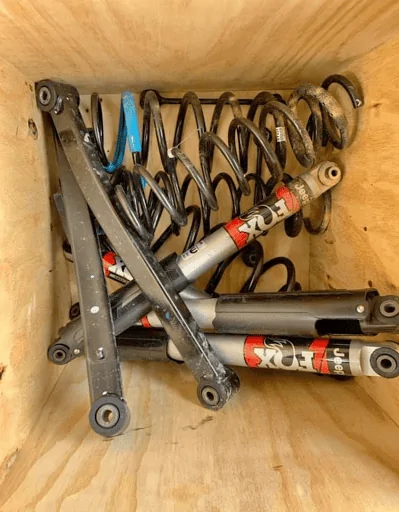

I found someone trying to unload their Rubicon suspension takeoffs for $300. That price seems to be in line with Rubicon takeoffs in the Wrangler market, but a little cheaper for a Gladiator. They say these only have 200 miles on them, so even with some exaggeration on the "newness," I'm probably looking at components with less than 1,000 miles.
It only has 2 of the 4 sway bar links, and doesn't include the 2 front isolators. Any idea if the Overland already has isolators that will work with these components, or will I have to buy a pair? How much would it cost for the 2 shorter sway bar links?

Going with my experience with the JL(Which should be the same up front) The lower Isolators and swaybar links are the same across all trims. Even the lower control arms were the same part #'s on the early JL's I checked.

TTE Chris is correct. The Rubicon stock lower control arms, all 4 sway bar links and spring seats are all the same. All you really need to change are the springs and shocks. The rest are all spare parts. The lift kit, longer new sway bar links, and lower control arms were to accommodate the height increase.

Thanks. I went ahead and got the takeoffs, and I'm sitting higher now. I like the firmer setup.
Anybody looking for some Overland takeoffs? ;)
