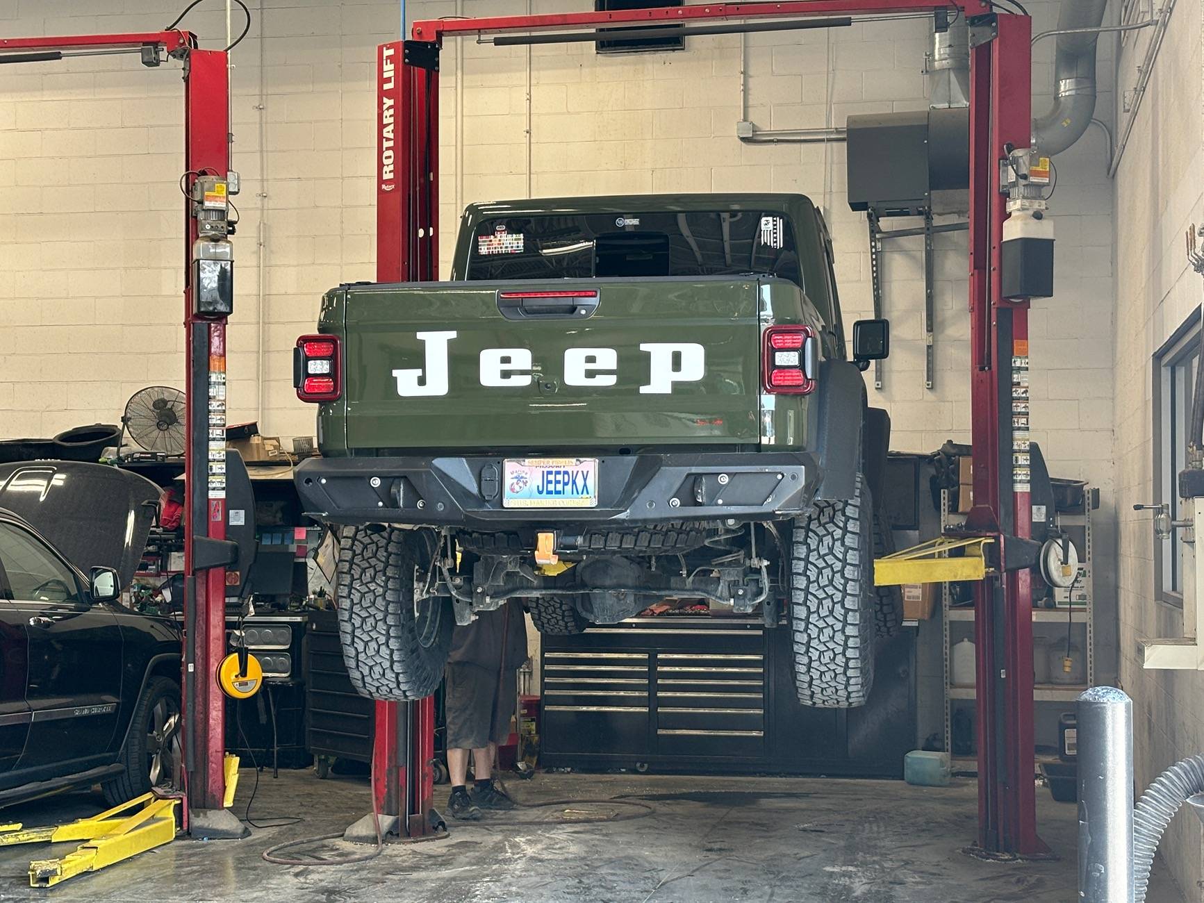

I thought for sure I told everyone I have a completely stock 2022 Mojave suspension---no lift and no aftermarket parts. But after a review I didn't tell you all, so very much my bad on not giving a good idea of my problem.
Full alignment is just whatever Jeep can do on a stock suspension which we all know is limited.
I do have a LoD full front bumper with a BadLand 12K nylon line winch and Rockslide Gen 3 steps which add weight to the front.
Last picture is from ComicCon in SanDiego yesterday.

Ok since no one else apparently thought of this. Double check both factory lower control arms and verify they are the same part number. If somehow you have the factory standard control arm on the drivers side and the factory extended arm on the passenger side it WILL cause it to pull left. and vise versa. There is only 1/4" difference in length but will make a big difference. I've seen crazier things working on Jeeps over the last 30 years. Had a similar problem on my YJ after the spring hanger was replaced and welded back just a fraction of an inch off.
Also make sure the bushings in the control arms are not shot, that can cause movement in the control arm and front suspension.
