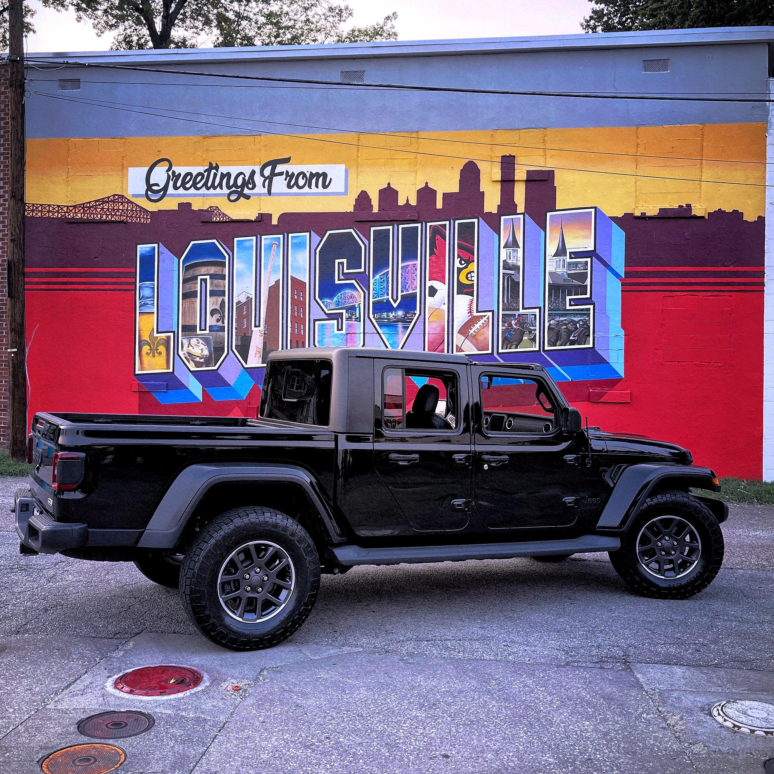

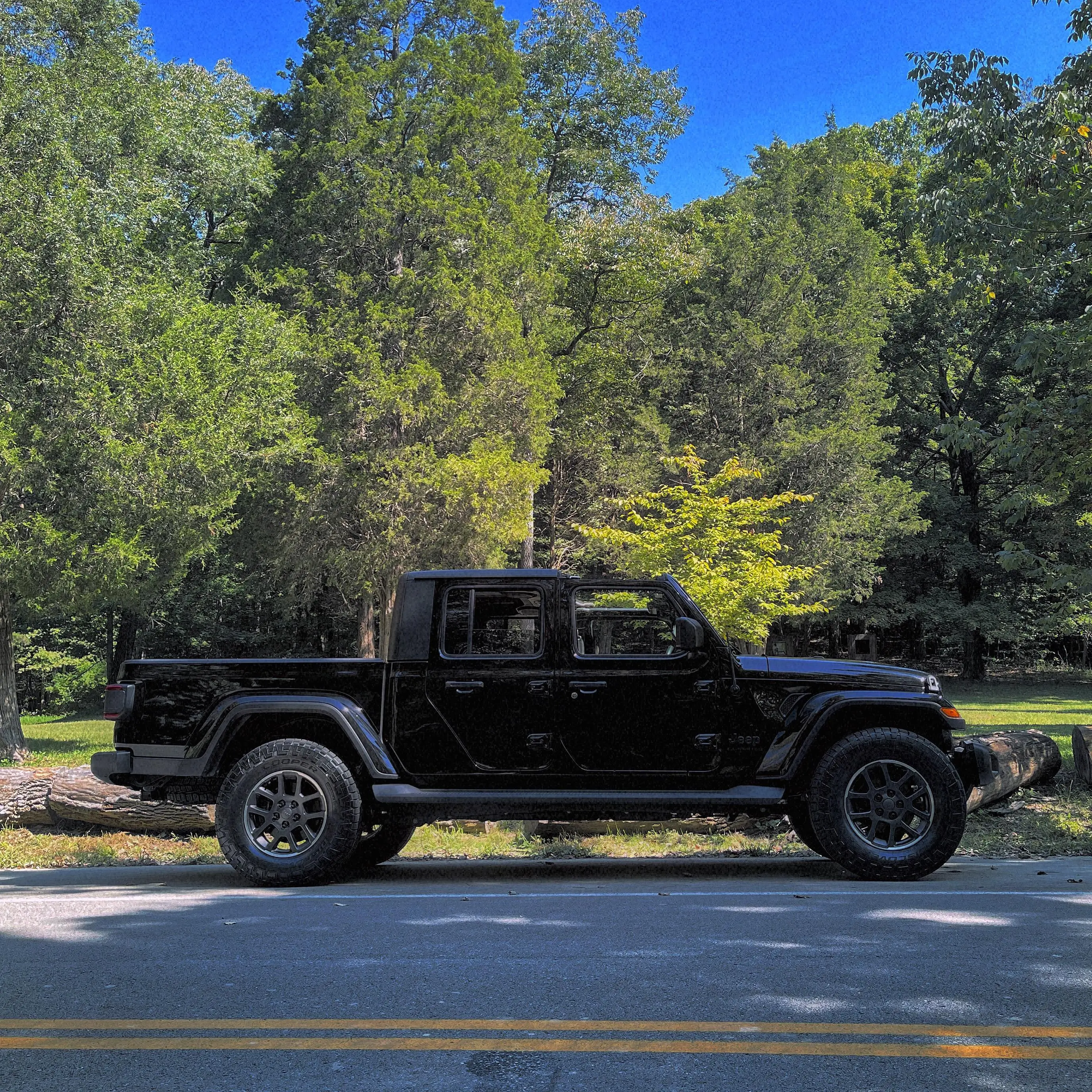

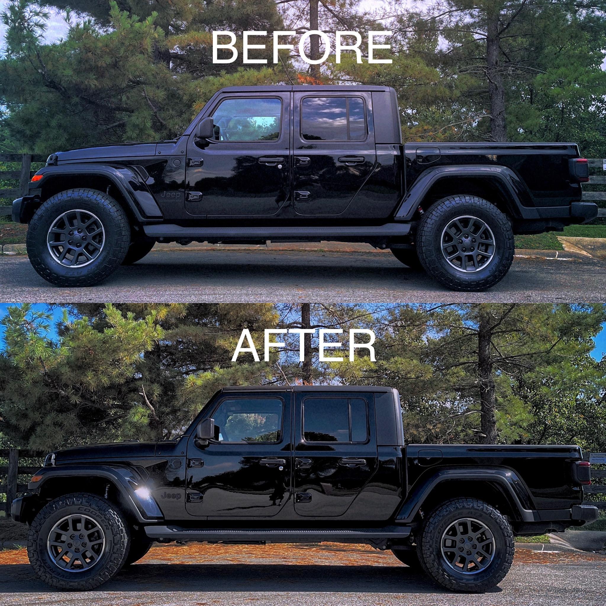

So just came across this, but if you havent got the answers your looking for I can add a little advice as your concern is nearly the exact same set up as I currently have also my purpose seems a bit similar to your everyday use.
So I have an Overland with 3.7.3 gears therefore I'm probably too staying with my current 35s cause I'm not looking to regear. But also Im pretty content with 35s. I also have Rubicon take off suspension with the Teraflex leveling kit up front. Nothing in the rear. I also have my stock wheels as you mentioned (although I am getting aftermarket ones very soon).
So your first question about rake. Adding the Rubicon suspension alone will not get rid of the rake. However, due to the difference in spring compression, you will gain a bit more of clearance from your stock height. Now this can differ depending on which Rubicon take off springs you have. Theres basically (2) sets with different part numbers in a nutshell. One version is from Rubicons that came stock with steel bumpers. The other is for non-steel bumpers (which is what mine came from). Theres a thread on here that talks about this, I could try and find it if I really wanted). So with that said, for me I gained a half inch alone just going to a rubicon suspension. Again that still has nothing to do with rake.
Thats where the leveling kit came in. After adding the teraflex 1.5 level up front, I've basically got a 2 inch lift total without having an actual full out lift kit, just having a spacer lift. But its 2 inches higher than its stock form. For me this has worked tremendously and even the rubicon shocks I found to be smooth. And that's considering my Overland had a smooth ride to start with. So I found it is an easy and cheap option to get a better ride and a little lift without spending a bunch up front and I am no means a cheap person or take the cheap route with anything. Hell my bed cover alone was $2300. My point is that it was super easy and affordable way to ease into the lift game and get a better feel for the direction I wanted to go or stay. Plus I installed it all myself.
Now that I've had that set up for awhile, I'm personally going for the Mopar 2in lift eventually. Not that I have a problem with my set up, but just for something better. If I already have a 2in spacer lift, you're probably wondering why I would go with a Mopar 2in lift in particular. One, its warrantied. Two, technically the mopar lift is a bit higher than 2 inches in most cases I've seen. And lastly, with the small increase, I want to make up for the added weight in possibly eventually getting the rubicon 3 piece steel bumper. Even with all that said, I'm not in a rush because I love my current set up. So in a sense the above user mentioned the work of the rubi take offs not being worth it. I can agree and disagree. In my case, I didnt know where I wanted to be at for starters I just had an idea. So it was a cheap option to figure it out. However, if youre already exporing options on an actual lift (Mopar or any others), than I'd just say go for that to save the time and effort. But money wise, you're not really loosing anything. Most take offs go for $300 tops and the leveling kit maybe $150 which you'd probably use with a lift or not anyways. So overall it depends on what your goal is. But I wouldn't just say its a waste. For me it;s been great.
So I'm including a few pics to maybe help you visualize. Anything beyond that DM me or check out my vehicle showcase for info.
First pic is stock. Second pic is a before/after combo showing the leveling kit (with the rubi suspension on both, just the level). Third pic is after the Rubi suspension only, no level yet. I know that kind of backwards but that they way they uploaded.

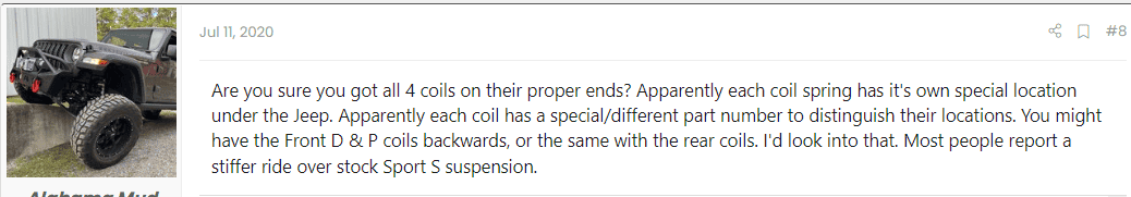

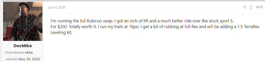

Jeep Gladiator Suspension advice please 1659151464227
Jeep Gladiator Suspension advice please 1659151544686
