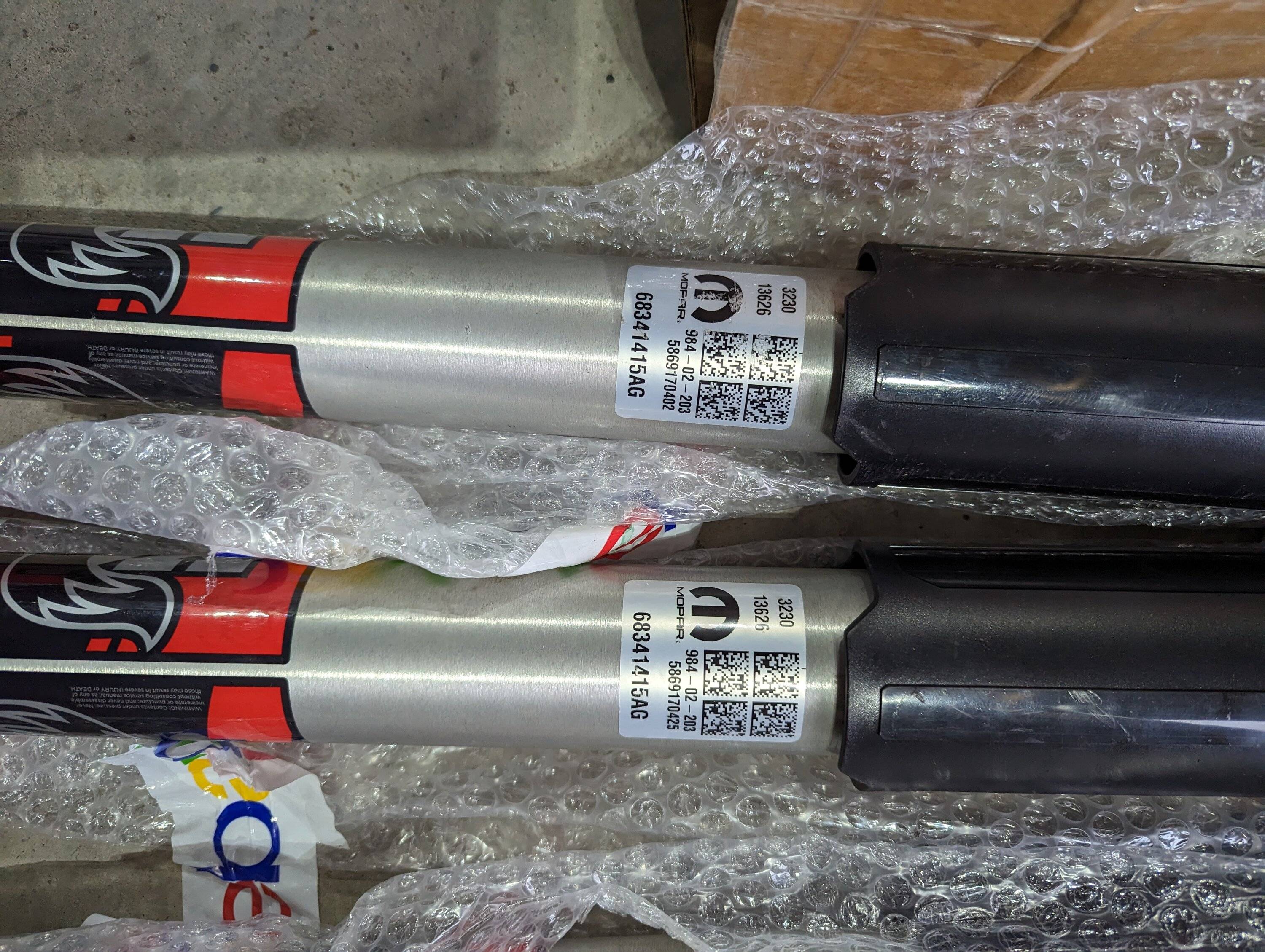

Shocks:
68341383AF--- Front shocks
68341415AG--- Rear Shocks

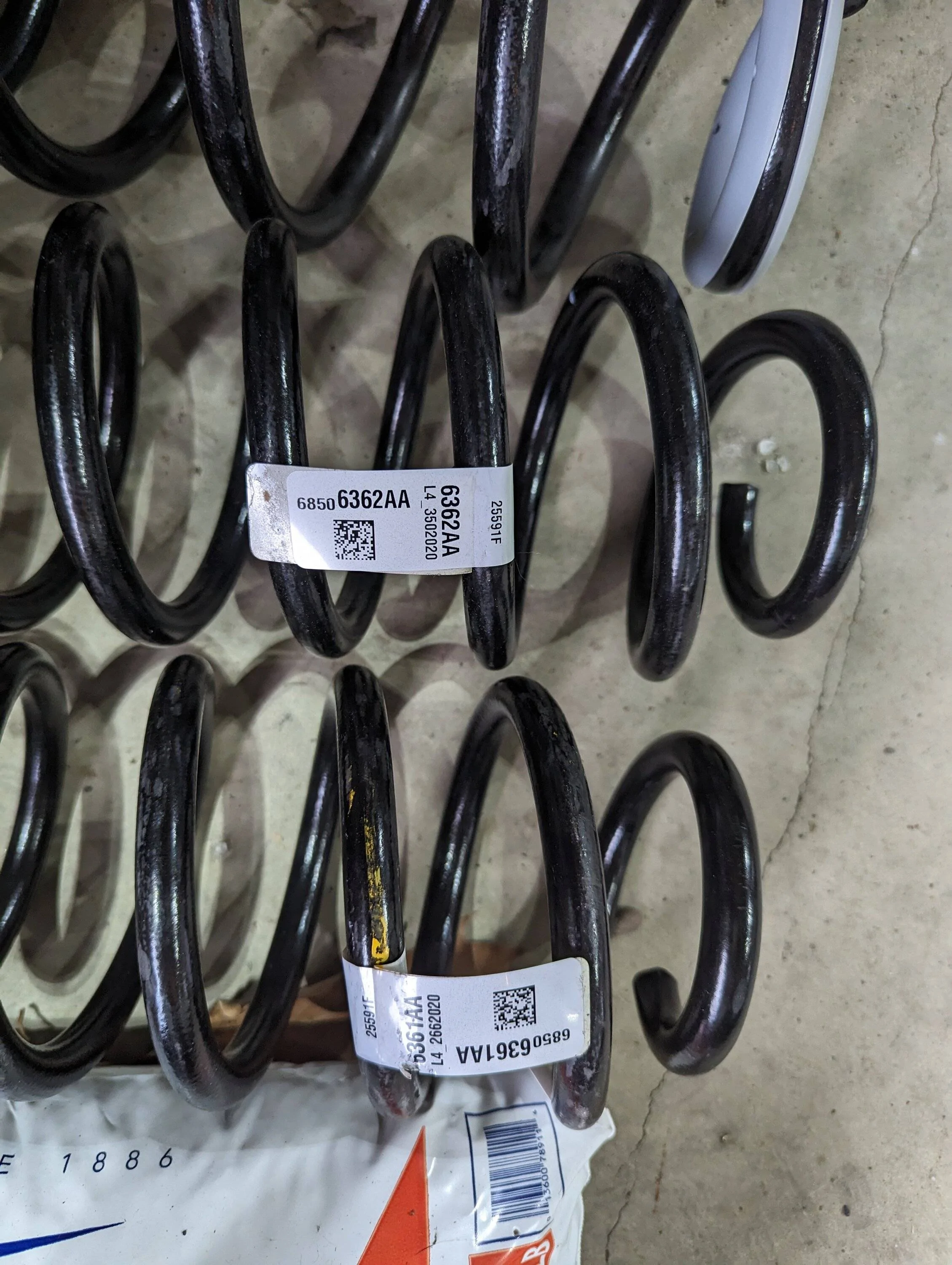

Springs
68506362AA--- Front (not sure if this is left or right)
68506361AA--- Front (not sure if this is left or right)
68506210AA--- Rear (not sure if this is left or right)
68506211AA--- Rear (not sure if this is left or right)
Did I get a kit that is worth installing or is what I have stock on the Willy's better.

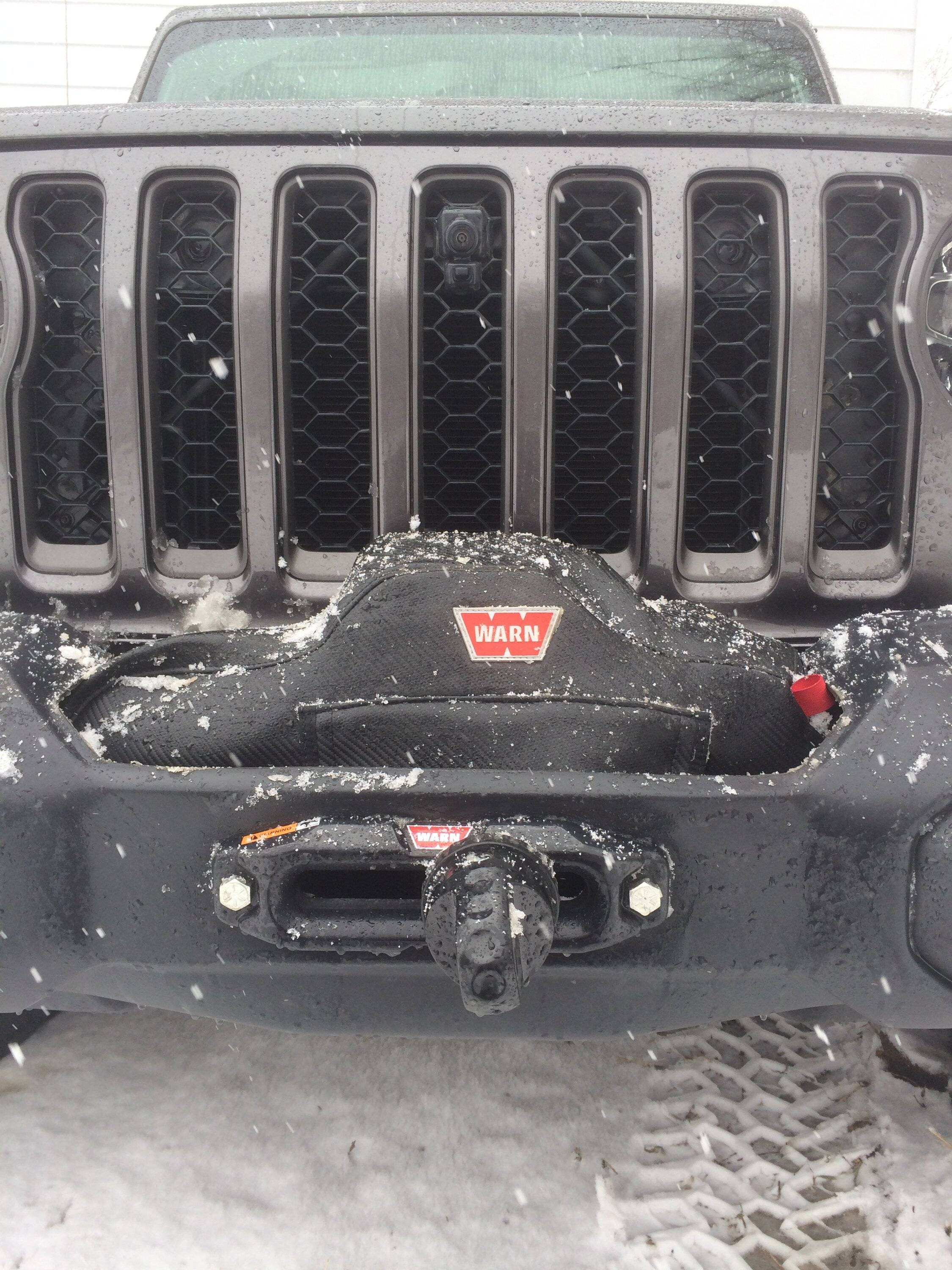

I am installing a steel number and winch in the next week.
After reading other posts about Rubicon take offs I did not realize there were so many spring combination for these vehicles.

General rule of thumb when it comes to spring part numbers for the 3.6L gas, the end part number before the two letter suffix is that even numbers go on the drivers left side and odd numbers go on the passengers right side.

Adding a heavier steel bumper and winch is going to throw a lot of the above out the window IMHO. If you are looking at a primarily daily driver, I would argue just putting in the Rubicon springs in the front and leaving the factory Willys springs in the rear and keeping the factory Willys shocks, that will give you a more level out front end with the heavier bumper and winch and maintain a somewhat more comfortable on road ride.

Do you know anything about the spring part numbers
I can not find anyone mentioning these 2 part numbers on the forum
68506210AA
68506361AA

I have seen that done but the wife wanted a different bumper.
I did go with a synthetic rope winch so I saved some weight.

There have been threads in the past people posting what their spring part numbers were and what options they had. I have not seen any definitive decoding on part numbers and spring rates, just speculation. I also believe to compound things further, Jeep has reset their part number ranges on later production vehicles

My 2021 Rubicon (bought new) have those springs. I have the hard top, AT, plastic bumper in front.
68506362AA--- Front (Passenger)
68506361AA--- Front (Driver)
68506210AA--- Rear (Driver)
68506211AA--- Rear

Seems from what you posted on your spring location. Seems mixed as far as the normal goes.
On my wife's 2022 overland ( yes I have 2 gladiators )
Rear springs ending in
117 drivers side
118 passenger side is also opposite of what is considered the norm

For my 2020, I put Rubicon springs up front (and BEWARE, when one says "Rubicon springs" they can be any of at least 3 or 4 different number - each of these trucks can come with varying spring numbers based on options and so on) So there is no one "Rubicon spring". I would always ask "which Rubicon springs" do you have. And for the later model years, the numbers have changed a bit.
My 2020 - Rubicon springs up front (numbers below) and Max Tow springs on the rear.
I gained shy of 1" up front when on my 2020 Overland.
The max tow springs gained no height. They are shorter than Overland springs, they carried weight ok, but it's not something I'd do again.
If I were to have re-done my 2020, I'd have left the Rubicon springs under the front, put different springs and air bags under the rear and left the stock shocks on. All I gained was appearance with the Rubicon Fox shocks.
For my 2022 Overland - I put air bags in the rear, and Synergy 2" lift springs under the front. Those really lifted the heavy front of my 2022. I have steel Rubicon style bumper, heavy Badland Apex 1200 winch, heavy Bulldog winch plate, a 2" Curt receiver and snow plow brackets and mounting bar up there.
JT 2022 Overland STOCK Springs-
Left front - 6342AA
Right front - 7796AA
Left rear - 6118AA
Right rear - 6119AA
2020 Overland STOCK Springs-
Left front - 325AB
Right front - 330AB
Left rear - 439
Right rear - 440
Rubicon take-off springs I bought for my 2020 Overland -
Left front - 339
Right front - 340
Left rear - 449
Right rear - 450
