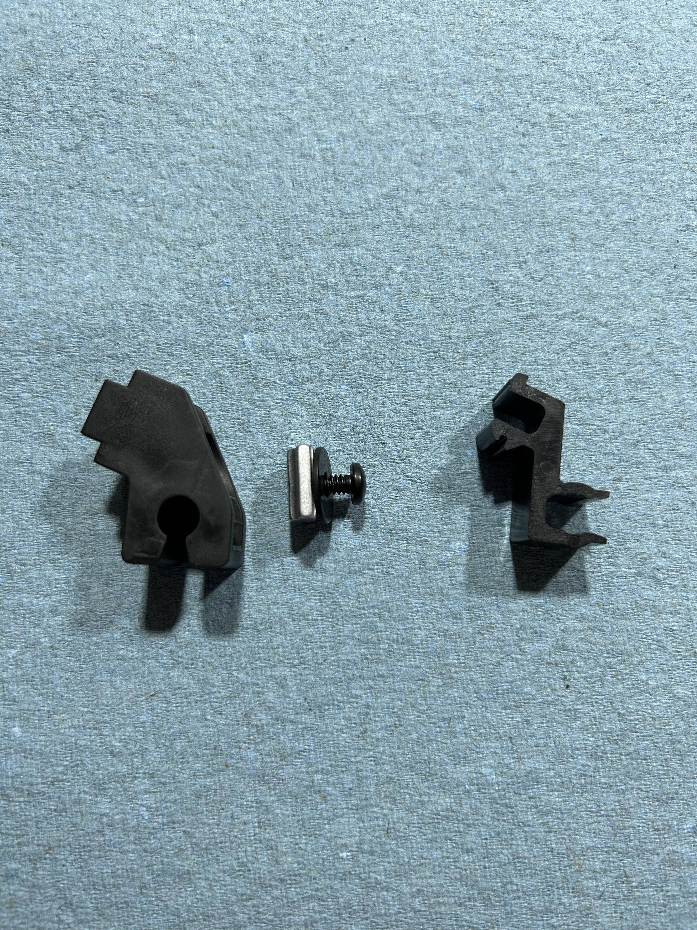

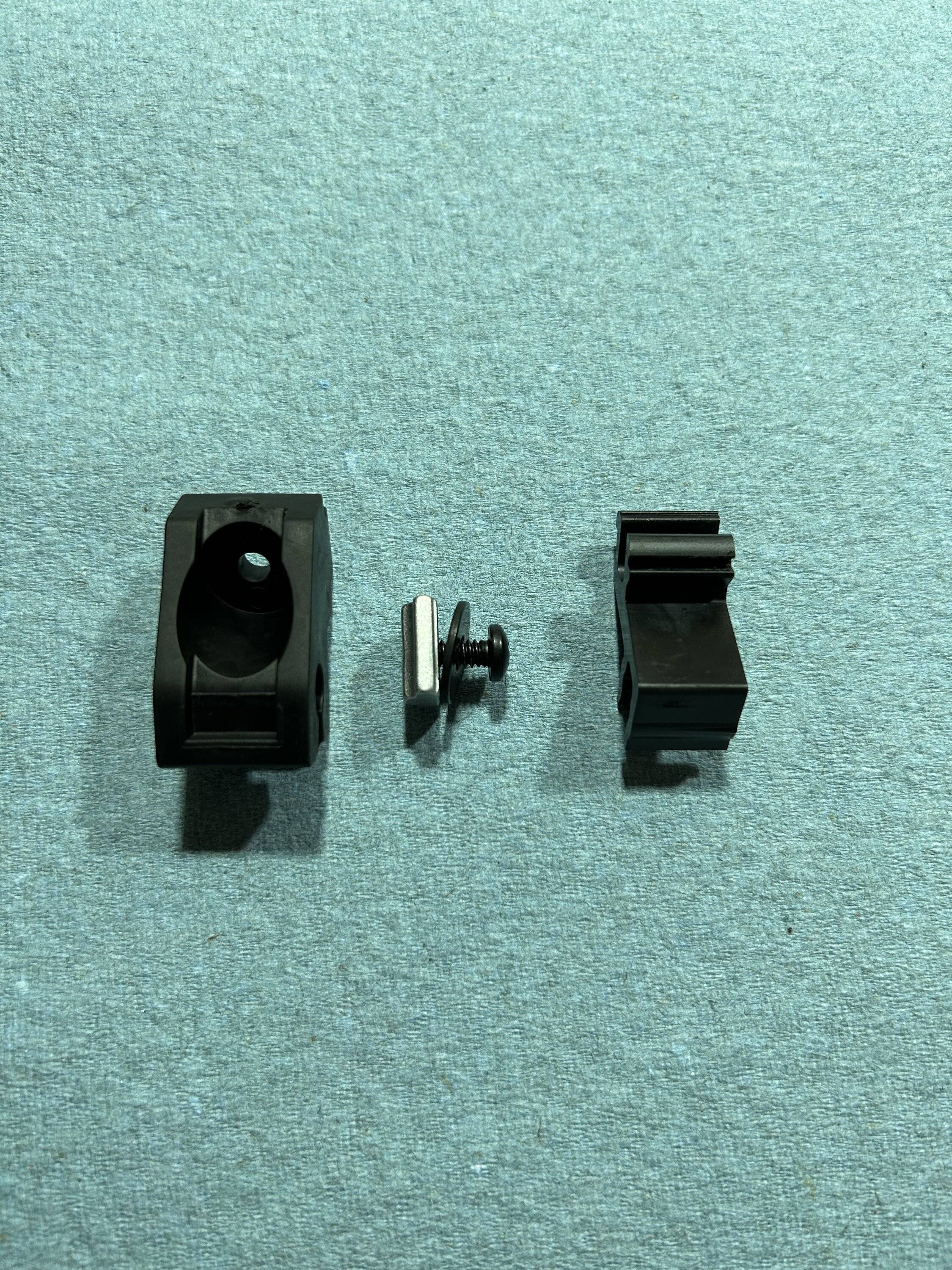

Found this in a search (before calling). Got my cover in late 2021 and one of my clips broke this last weekend. I just called Rugged Ridge at (855) 466-1985 and had a free set of updated replacements on the way in 5 minutes. The gentlemen I spoke with was apologetic and helpful and indicated it has been a bigger problem than it should be, hence the updated design and free replacements. A+ for my experience with their customer service…now to see how the new clips do!
Average Oregonian
Jul 10, 2021
138
197
Oregon
2021 JTR

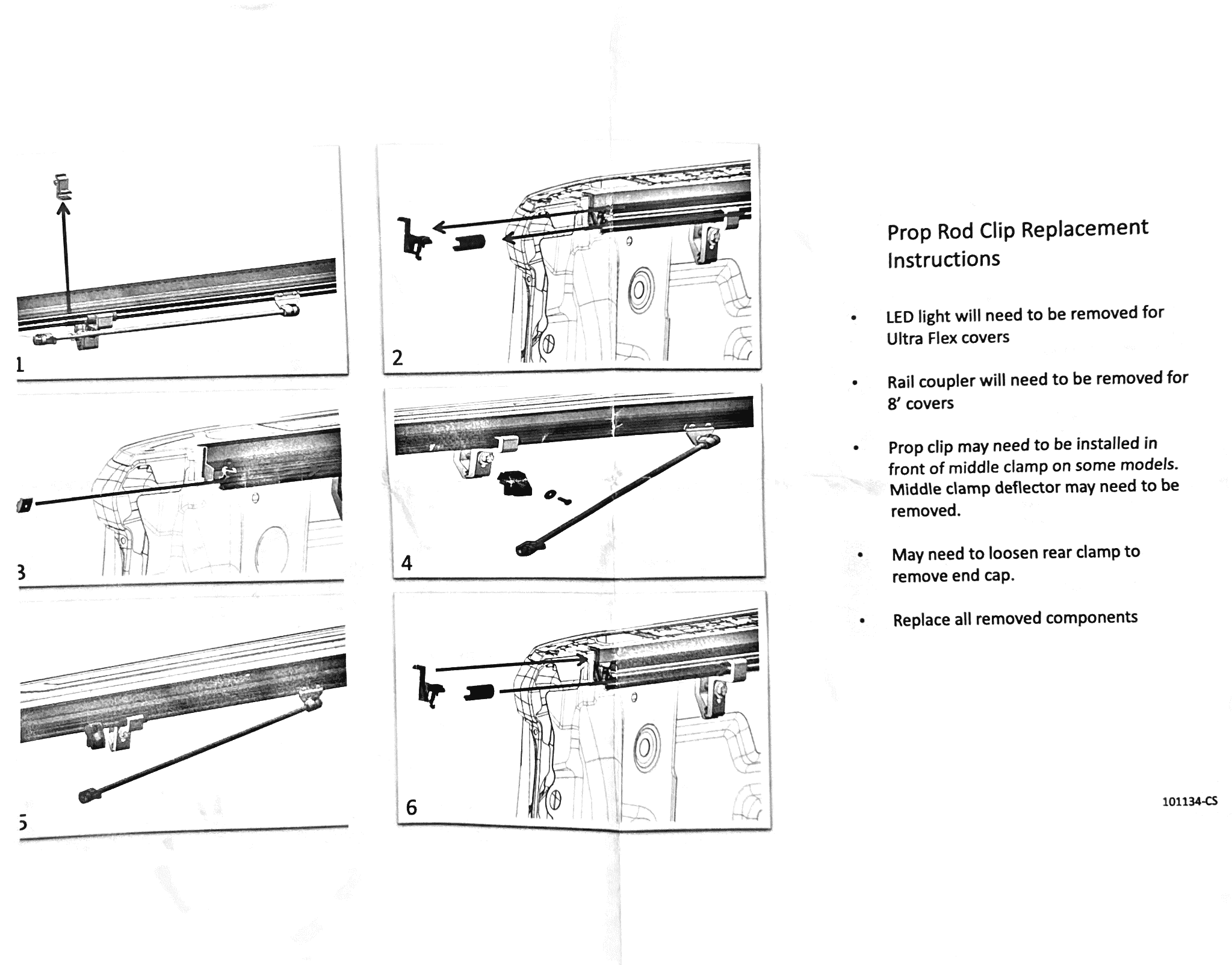

Got my replacements today and installed the broken side. The new design is a flexible rubber and bolts on. This should be a permanent solution ? Props to Truck Hero and Rugged Ridge for the update and customer support. It would be a 5 minute install if not for opting to use Vibra-Tite on the bolt.
