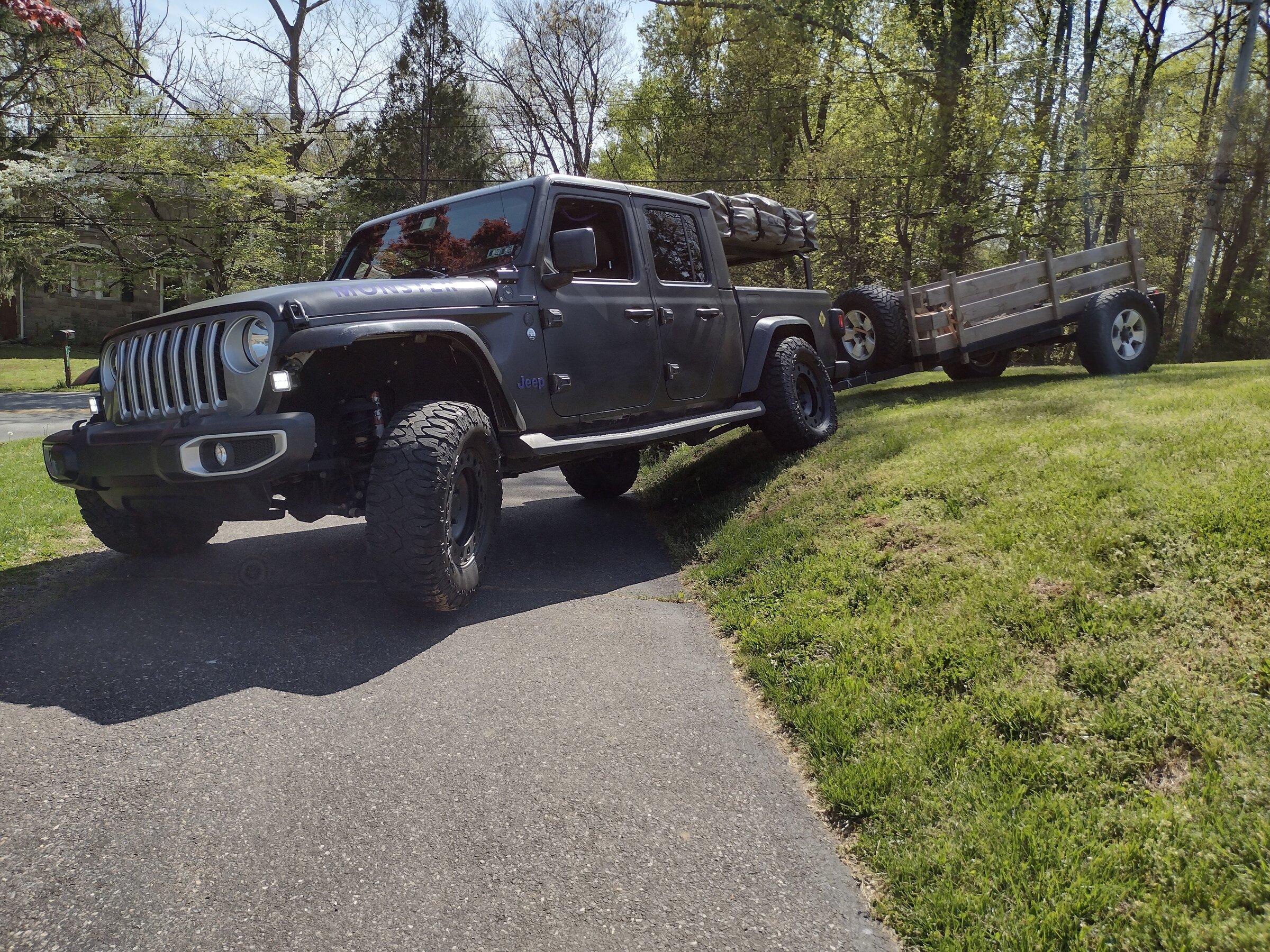

Probably? I gutted the fenders on my Overland edition so I can clear tires without a lift (35s for sure, maybe 37s). And all the parts were still in usable condition after I pulled them apart and broke the plastic welds. A model/hobby shop that specializes in miniature figures or similar would probably be a good source for the right kinds of plastic adhesive to do the job. But lining everything up would still be a right bitch.

So you don’t think there’s anything that will glue or bond the 2 pieces together I had an old fender and it came right apart and it snaps back together because of the tabs on one side I am try something to bond them together before I take the good fenders apart
Gutted fenders
