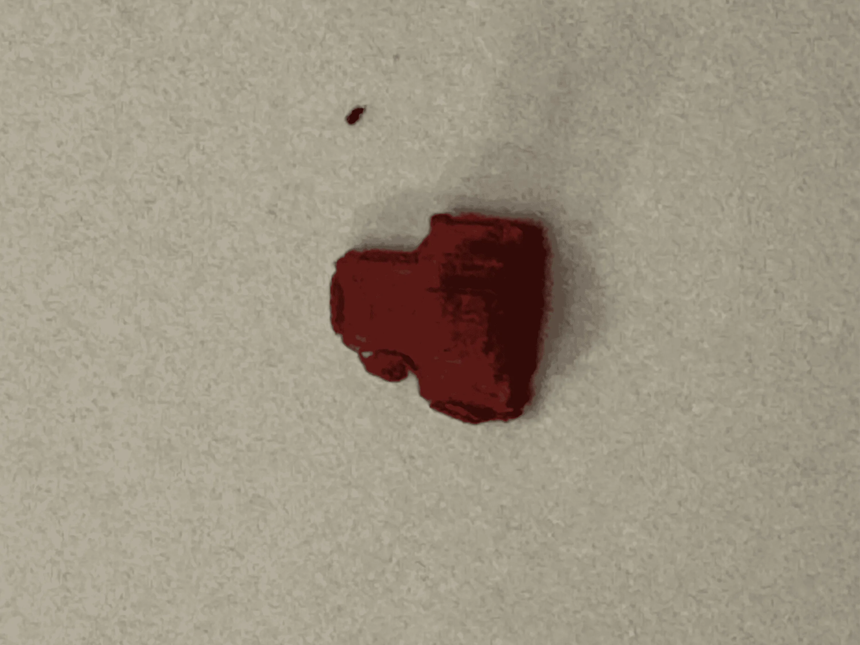

So I went to check the codes to see which sensor was not working, front or back, and it came back as C1416-13. From what I can tell, that's the front. This is interesting because that's a newer front axle after I had it replaced with an Ultimate Dana 44 about 1.4 years ago.
Sometimes I hate working on my truck. I went to install the bypass and broke the little locking tab on the original connector. And I still couldn't get it off. So now I'm not sure how to pop that piece off to install the connector.
