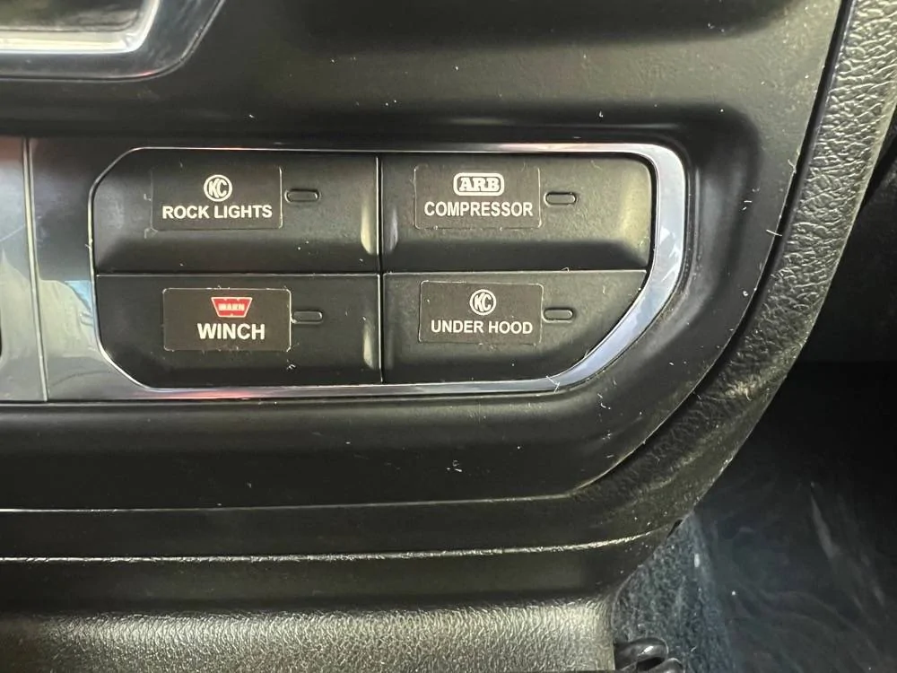

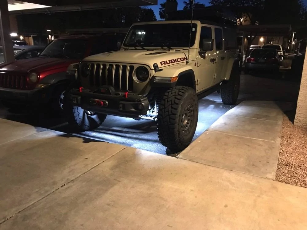

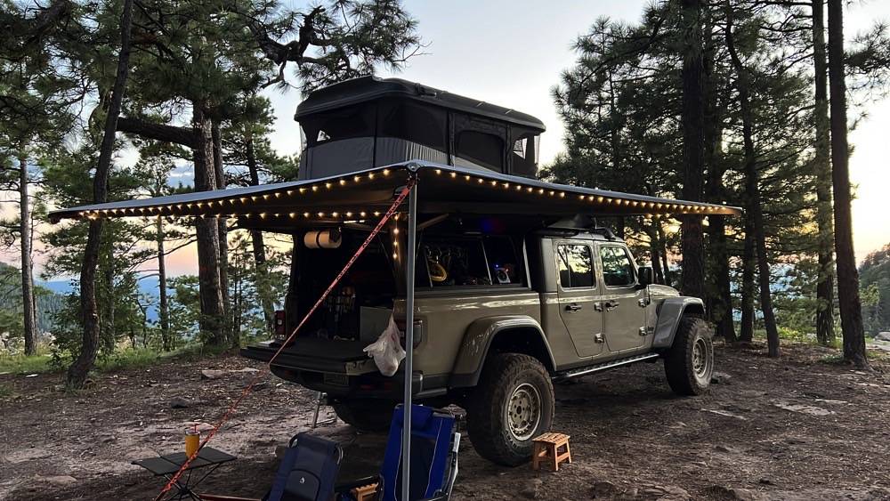

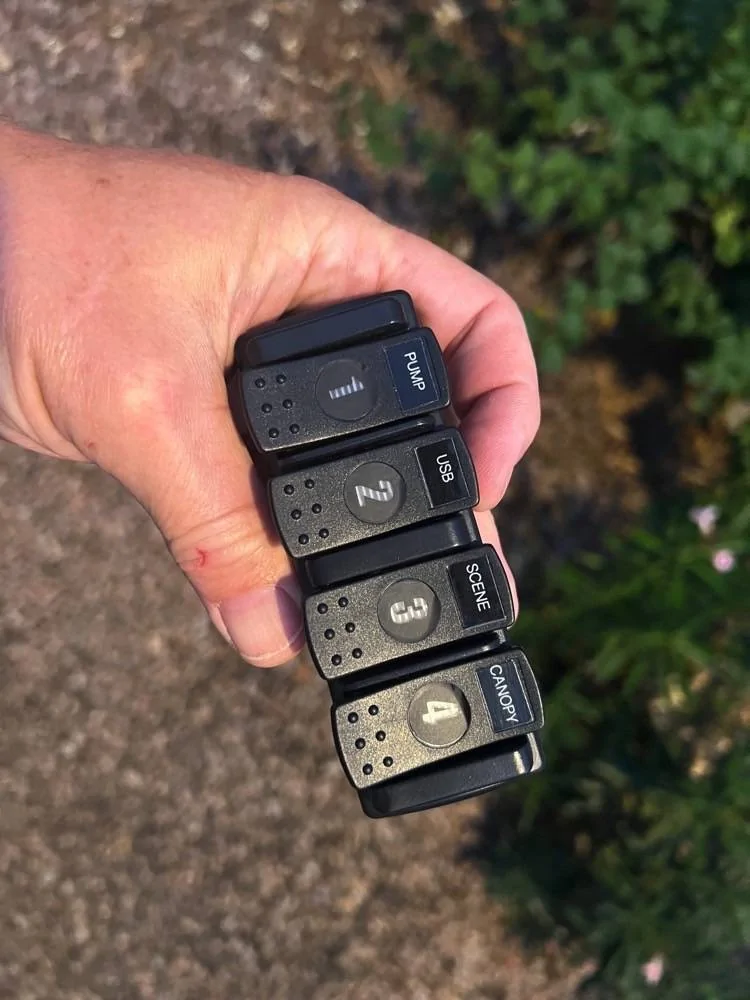

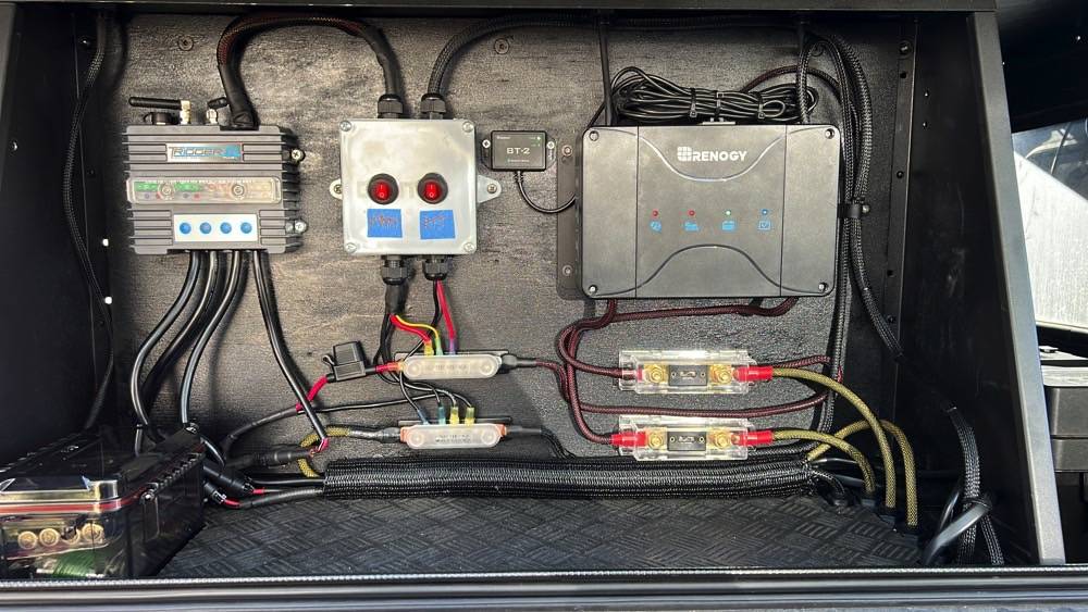

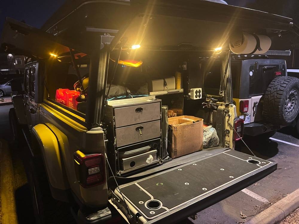

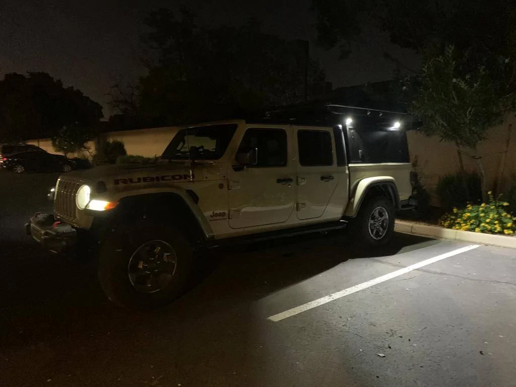

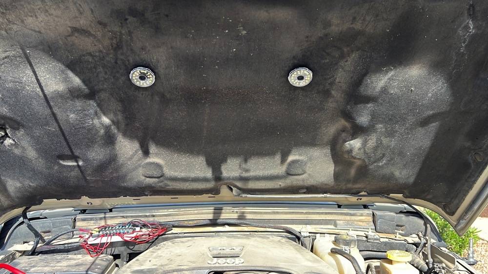

HooliganActual Well-Known Member First Name Robert Joined Jun 27, 2020 Threads 9 Messages 1,410 Reaction score 3,601 Location 10 miles from the Sun Vehicle(s) 2020 Gladiator Rubicon Occupation Retired Feb 6, 2024 #2 Well that's a wide open request! Let's start with Underhood lights - sorry but I have no pics at night with them on: (2 KC Cyclones tied into Aux 4) Scene lighting: (4 KC C2 LEDs tied into house load controller) Rock Lights: (8 KC Cyclone tied into Aux 1) Awning Lights: (23 Zero Mood Setter Light String plugged into House USB Panel) Canopy Interior Lights: (4 Amber KC Cyclones tied into house load controller) There are also the same string lights as around the awning perimeter that are strung inside my RTT but I don't have a pic of that. Aux Switches: House Loads run off Trigger4 Plus Controller (left side of pic): Trigger RF Remote:
