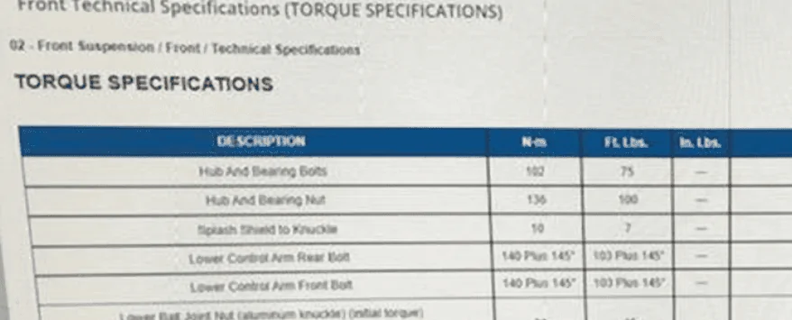

Lower control arms are to be 103 ft/lbs plus 145 degrees. That's the JEEP specs right from their tech info.
I believe the 190 is likely from a kit - and aimed at people who can't deal with torque plus angle.
It was definitely not at 145, turned with one hand and socket! Mines an aftermarket Metal Cloak game changer lift so went with torque specs from Mopar 2” lift spec sheet? Not sure if 190 will be an issue long term?? What do you think? It’s no prob to loosen and re-do if needed tho!
40,444
53,867
The 190 will be fine - it's still MOPAR specs for the 2" lift kit parts.
The 145 is 145 DEGREES after you reach a torque of 103 ft/lbs.
Torque to the 103 and then turn the bolt an additional 145 degrees of rotation - that's most likely well over 190 but I haven't actually measured it ............ yet. I plan on comparing when I strip this JT of mods to put them on the new one.
The control arms, upper, lower, front and rear, are torque plus angle. Torque to the spec mentioned and then turn the bolt another 145 degrees in the case of the lower arms.
145 degrees is roughly 2.4 "flats" of the hex head. A full turn is 360 degrees, turning the bolt 180 degrees is a half turn, and so on.
