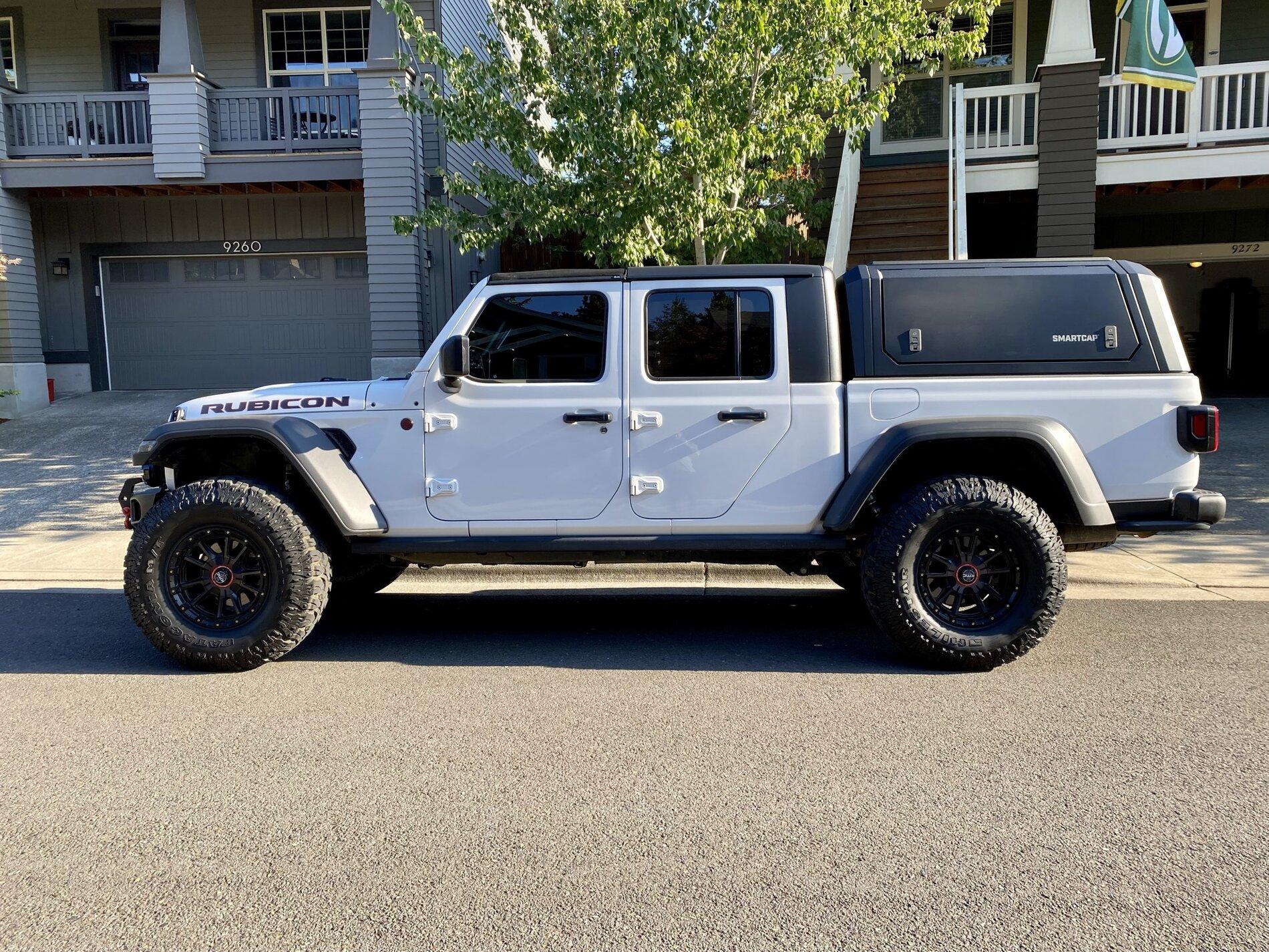

I have the Clayton fronts and Icon rears. The Clayton front springs gave me more like 2.25” in the front and the Icons were pretty much dead on at 1.5”. Clayton front springs are awesome and the Icons are so-so. Def great offroad, but pretty soft on road. I am using Fox 2.0s and have an RSI Smartcap installed. Lift is exactly what I wanted, height wise.

Nice. Do you have pictures? What size tires?

That looks great. Exactly what Im looking for. Thank you!
