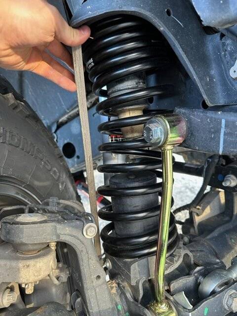

Had the 3.5" front and 2" rear SJ lift installed on my MJT. Noticed passenger front spring was bowed and the truck sits 3/4" lower on the passenger front side only. Called SJ and they said to rotate the spring 180 degrees but that would cause the spring to be seated incorrectly. Took it back to the installer and mentioned it could be a bad spring. They said to add a spacer to level it out, but that seems like a BS fix to me and won't correct the bowed spring. Thoughts?

It kinda looks like the front track bar needs to be adjusted. Truck looks like it pushed too far over the axle...
