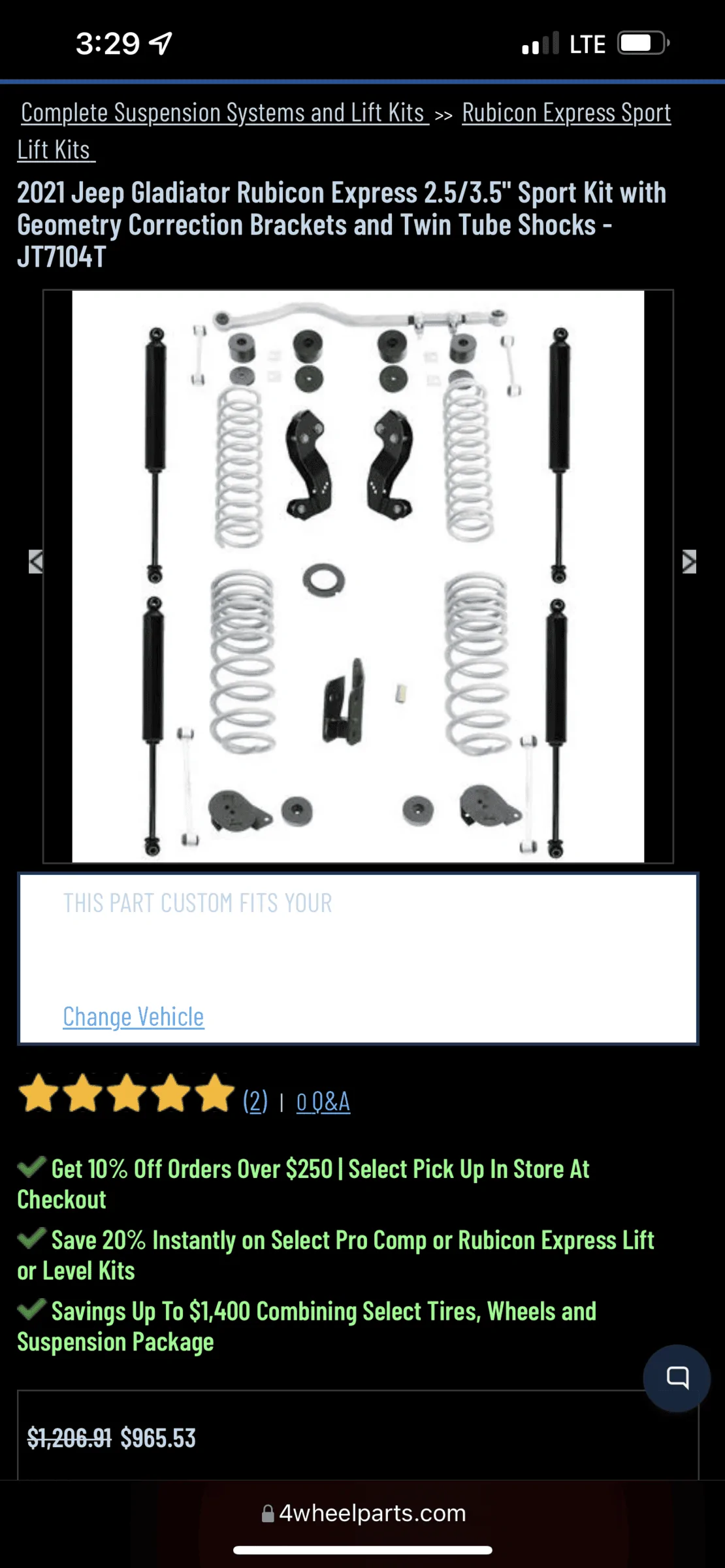

After shocks and install I’m looking at prob twice as much. Although I’d love that kit.
