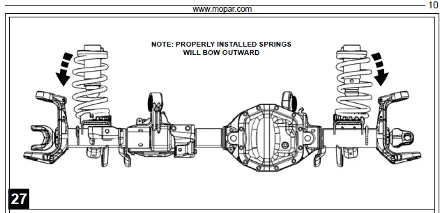

Spring bow is a common thing with Gladiators. There are stock Gladiators that have spring bow. And the Mopar 2" lift instructions tell you how to orient spring bow.
Jeep Gladiator Spring Size for 3.5" Metal Cloak Lift Gladiator spring bo
