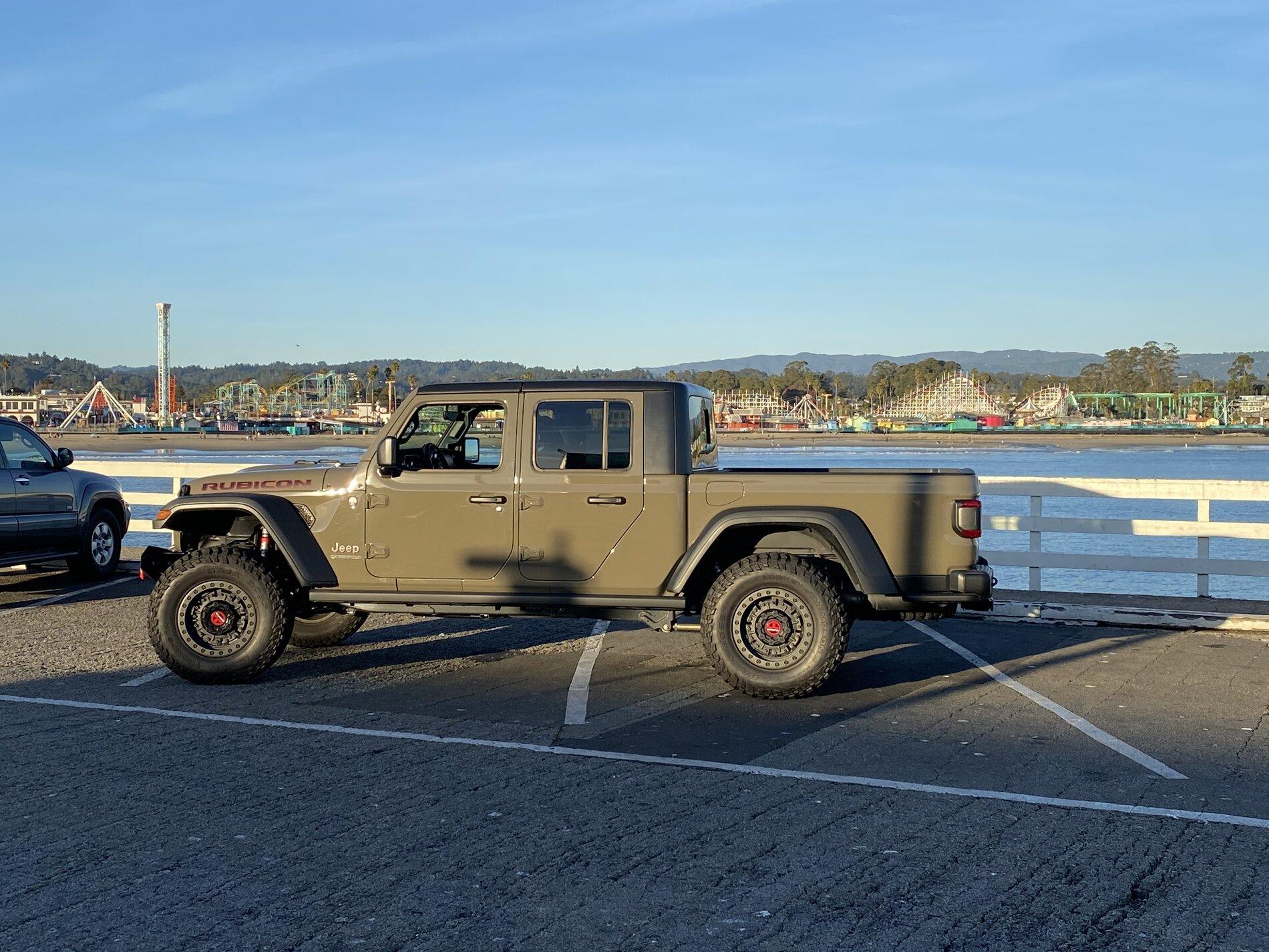

Jeep Gladiator Metal. Cloak game changer 3.5 7084EE7D-EE5E-4AD7-BBB9-C4FF59C72266
This is the 2.5 leveling kit. No rear lift with 35s. If I had to to over, I would got with 3.5 Game changer and be done. My 2 cents. Good Luck

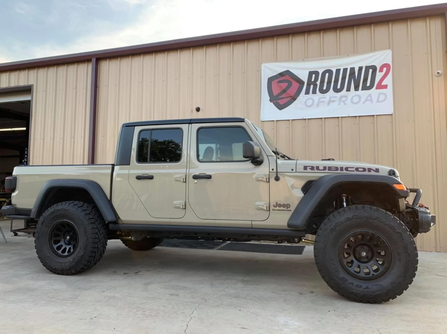

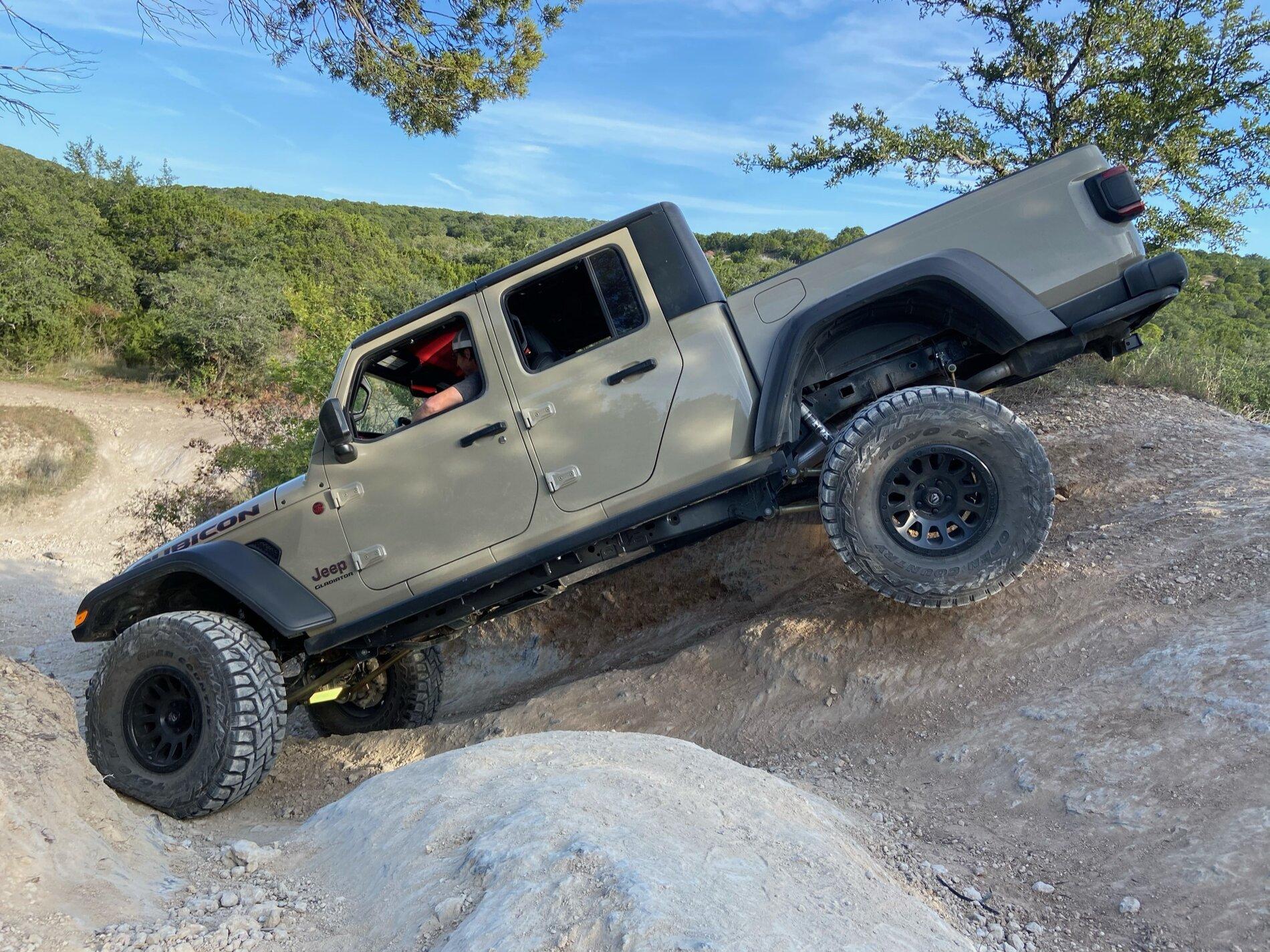

I’m running it with 37s. What would you like me to measure?
Would you mind measuring the height of the door sill (bottom of drivers door) and the bottom of the tailgate? That’ll give a sense of the overall height and rake change. For reference the stock Rubi on 33 MTs measures 23” and 32” respectively. Thanks!

Middle of driver door sill 28-1/8. And tailgate is 34. My Toyo r/t are about 35-1/2 tall. I don’t have a spare in the back so it may be higher than most in the rear.
