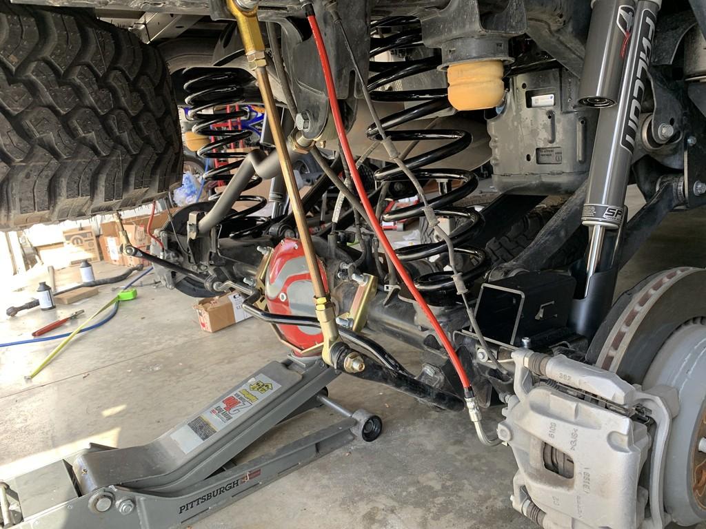

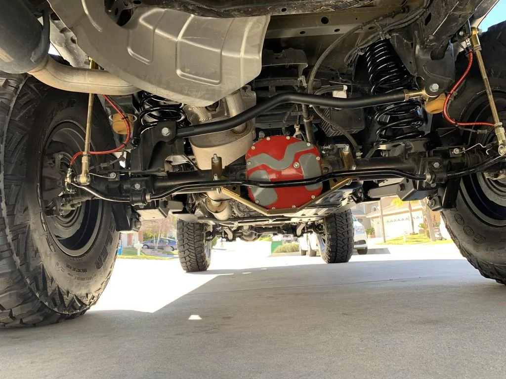

Anyone install the MC Game Changer on their 2021 Rubicon rig? Experience any issues with new extended rear brakelines and associated abs/wheel speed sensor wire being to short in comparison?
Jeep Gladiator Metalcloak 3.5" Game Changer Install Questions 20210803_132813
I installed, following the directions, but the sensor wire is a lot shorter (even after removing all OEM clips on frame and brakelines) so as to over extend and possibly tear away during full flex.
Any insight would be appreciated!

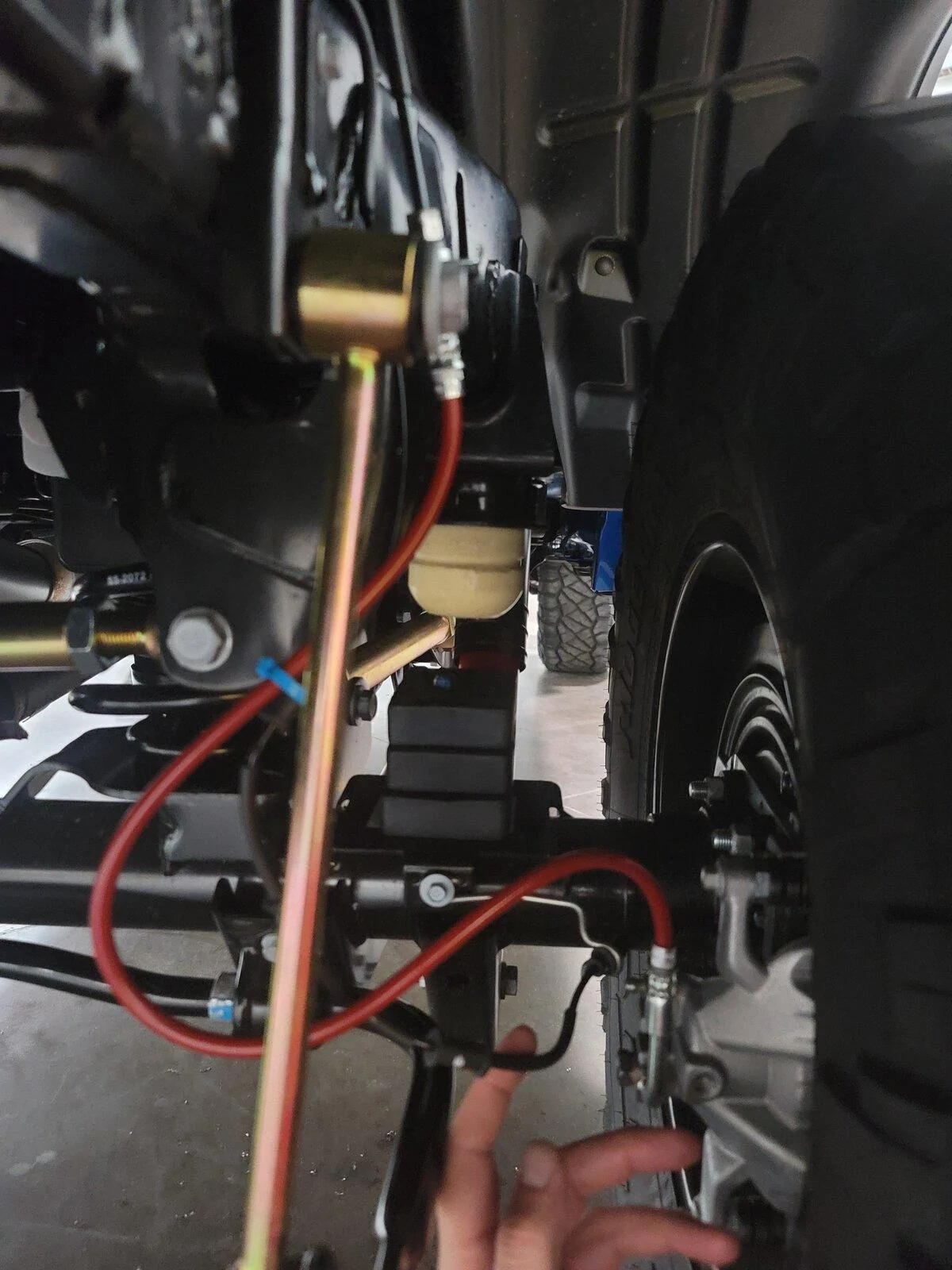

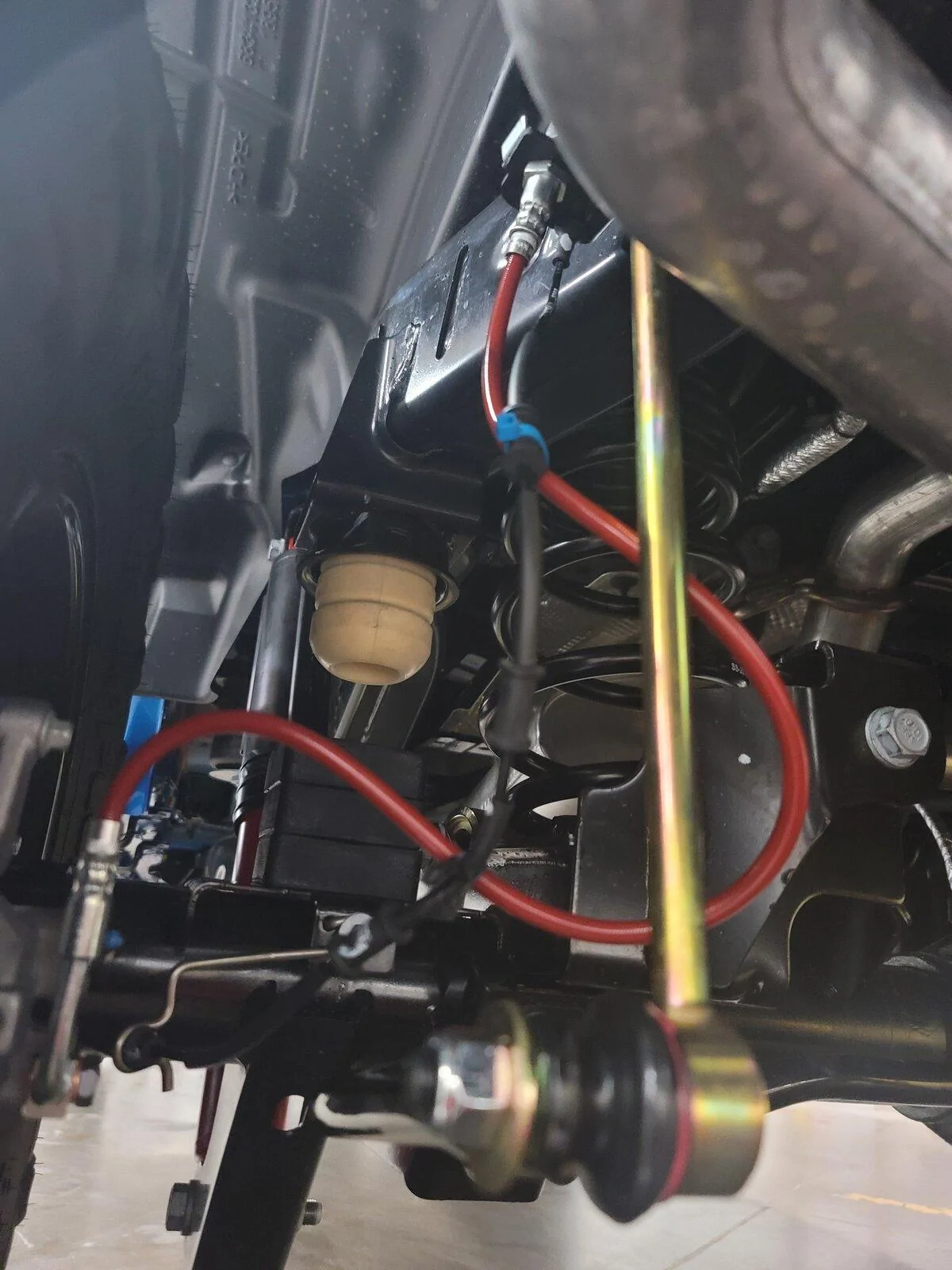

I have the Clayton 3.5" kit. I was able to unhook those factory brackets up top and get full extension on the ABS line. Mine is a 2020. Then, I zip tied the extended brake lines and abs lines together. I think Jeep thought about this ahead of time... There should be a lot more slack to get after that "blue zip tie" you show on that last rubber bushing. You can see on mine, I was able to get much more slack after your "blue zip tie". Here are some pics.

You need to unhook the ABS wire from everything and then zip tie to the brake line.
