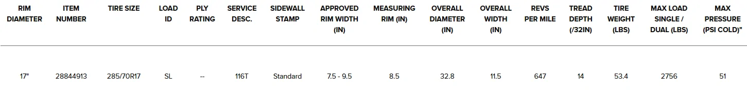

The thing you're forgetting is the size of the obstacles. A stock Jeep is not going to be taking on obstacles that need a 37" tire. Things that size need more sidewall and lower pressures.
You also knocked a full inch off a 33" tire, that's not the case. At larger sizes you can be down as much as an inch, but at a smaller 33" they are closer to the true size. The discrepancy is percentage-based, not just 1". Take the Falken Wildpeak AT4, the 33" tire on a 17" rim is 32.8" true measurement - your estimate was off by 80%.
From the Falken website:

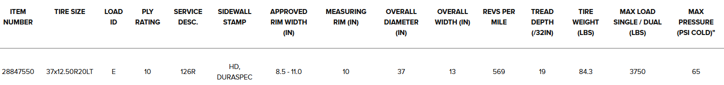

Not debating who wheels more. There are tons of guys on 37s that never wheel.
Take manufacturer measurements for both sizes if that's what you're going to use.
From the Falken website, a 37 is a 37:
