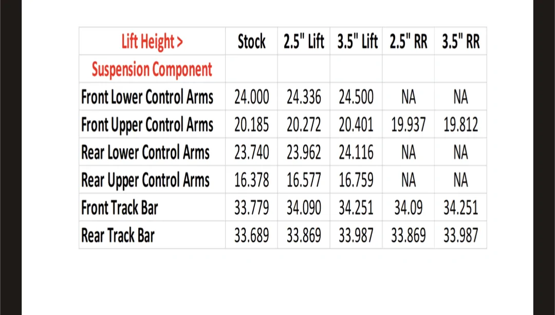

Personally still mostly looks like the axle is just all out of wack with it being super far forward. The shop got caster by just adjusting the lowers is my bet.
If this was my truck I'd adjust the lower and upper control arms to the Clayton 3.5" lift specifications which should be really close to teraflex 3.5 with .5 bump stop. That should get the axle very close to the correct position and then you can reevaluate. This can all be done on the ground one arm at a time so it should be fairly easy.
Edit: here is the measurements they give it will be damn close to between 5 and 6 degrees of caster.
I can adjust the control arms on the ground? Meaning all tires on the ground?? Sorry lack of experience over here.
Yes, unbolt one lower, adjust lengths, reinstall. Do the next lower, then do the uppers. For the uppers you will probably need to unbolt both at the same time or you won't get the tilt you need potentially.
