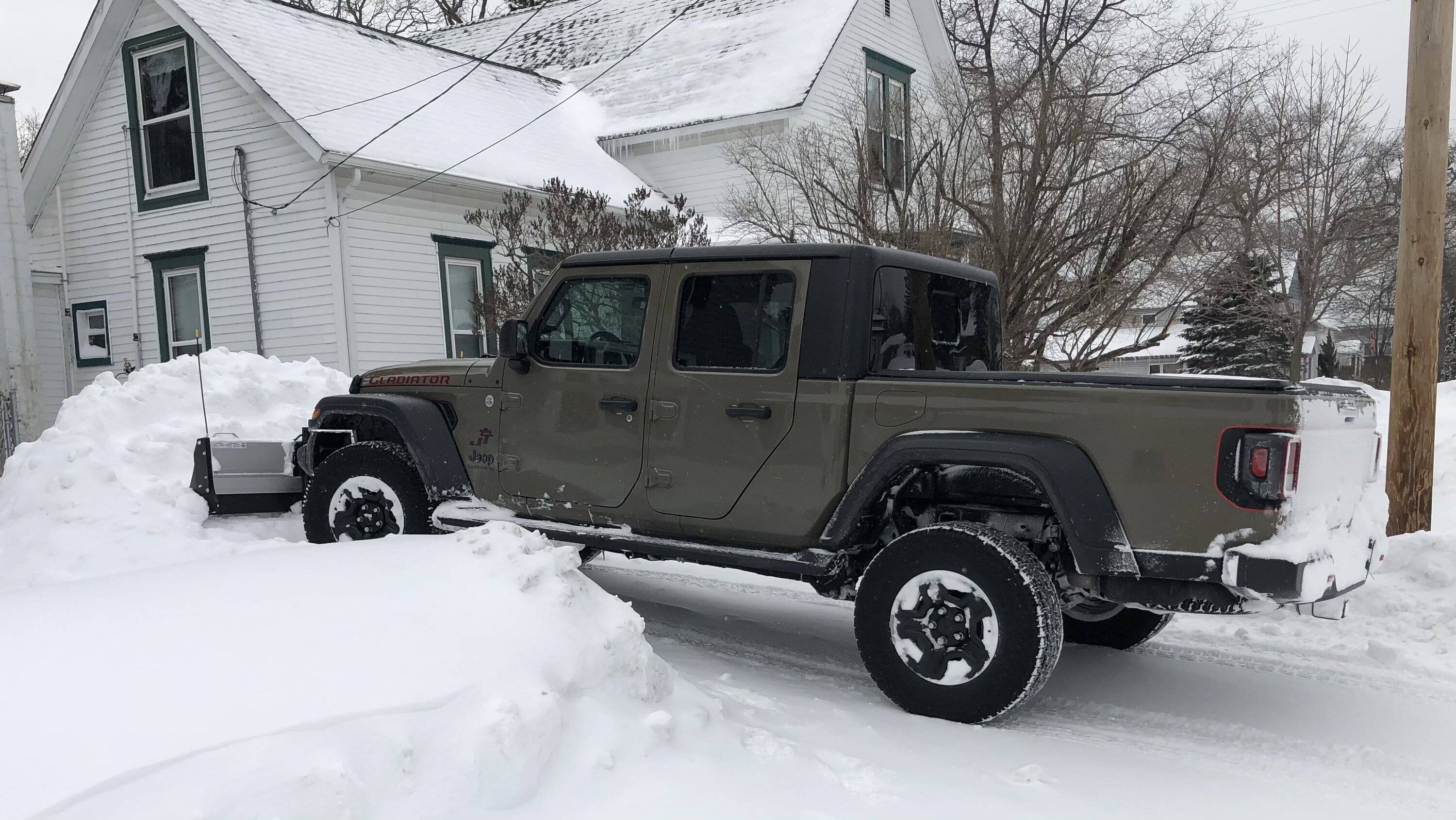

My 2011 Silverado 1500 4x4 would very easily handle a plow like I've got for the JT.
No question. It's wider, longer, more stable, the PS is stronger (would handle the load of the heavy blade out front) and the weight of the rear of the Chevy would keep the rear end planted more firmly than the JT ever could.

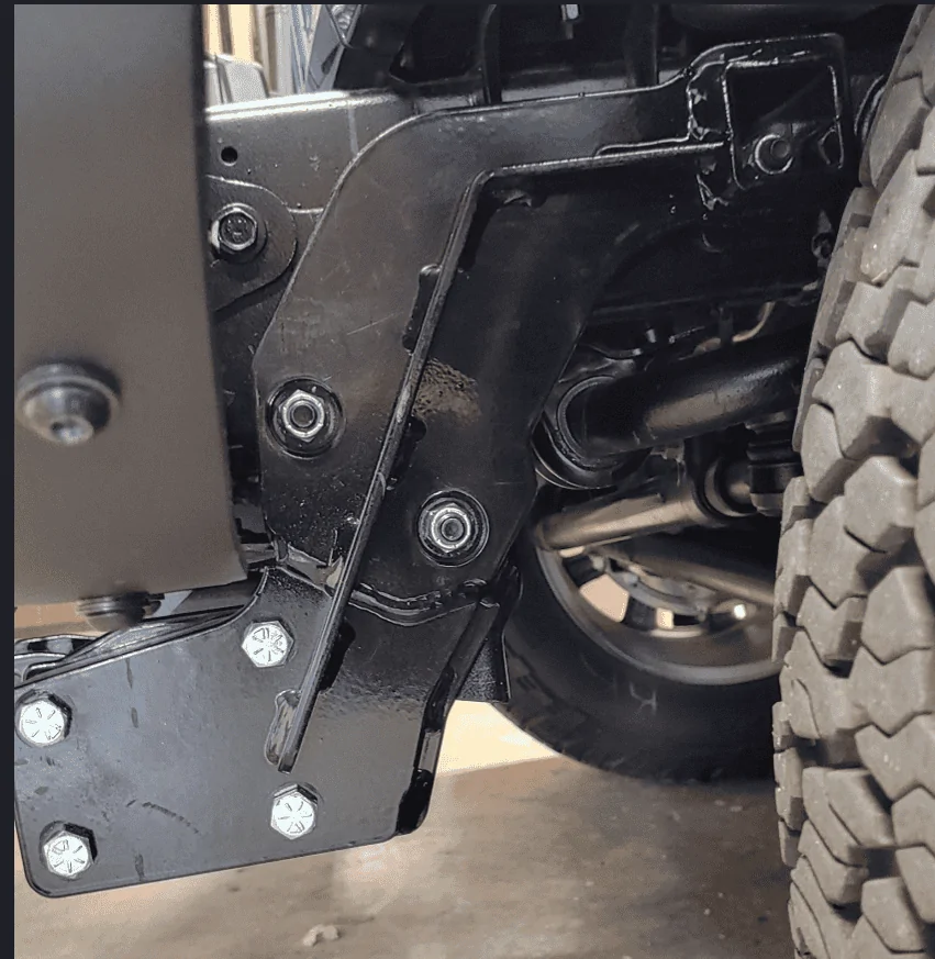

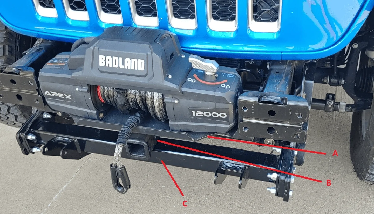

I have a feeling the JT's frame will be more prone to damage than the crazy heavy-duty plow structure. (C in the pic below)

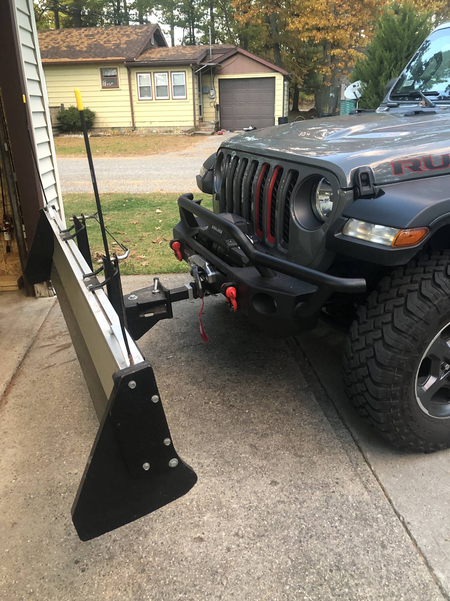

I’ve been looking for a snow plow for Overland diesel and everything I’ve seen online only gives options with the gas motor. Called the local western plow dealer and he said they can’t mount one with the diesel motor. Anyone had any luck finding one for the diesels and why wouldn’t they offer one for the diesel Gladiators?
This Snowsport is light but floating. No wires, hydraulics, aluminum and maybe 100#. Just need to add a front receive and does not block airflow.
I considered something like that, in fact, it was the secondary reason to have a receiver up front (primary was for parking and maneuvering my car hauler in the narrow spaces I have by my shop)
But after communicating several times with a forum member who has had plows on Jeeps and plowed with them, I decided not.
Biggest negatives for me - with my Raynauds, and back issues, climbing out and in after every single pass to angle the blade and such - it would be easier to use the John Deere lawn tractor. I need power angle and power lift, power down. I need to back-drag away from things. My neighbor is 80 and not getting around well these days so I figure I may pull up to their garage door and drag the drift back off the concrete approach. A drift always forms after our storms here right in front of their garage and our garage. The deepest snow is usually there due to the way the wind goes around the houses.
I can drag snow back away from his shop door, off his shop's concrete approach.
He'd never let me do his driveway - he's made clear - "NO BLADE on the gravel!!". (doesn't mean I can't drop the skids and float lightly over it LOL)
There were other factors, of course......pictures and such. So I changed my mind and told my wife - figure the blade budget x3.
But it was honestly close - those have their places - a lot of people are going to love 'em. The light weight means pretty much any "capable" Jeep can do it. I had already looked at and priced a couple similar to yours.

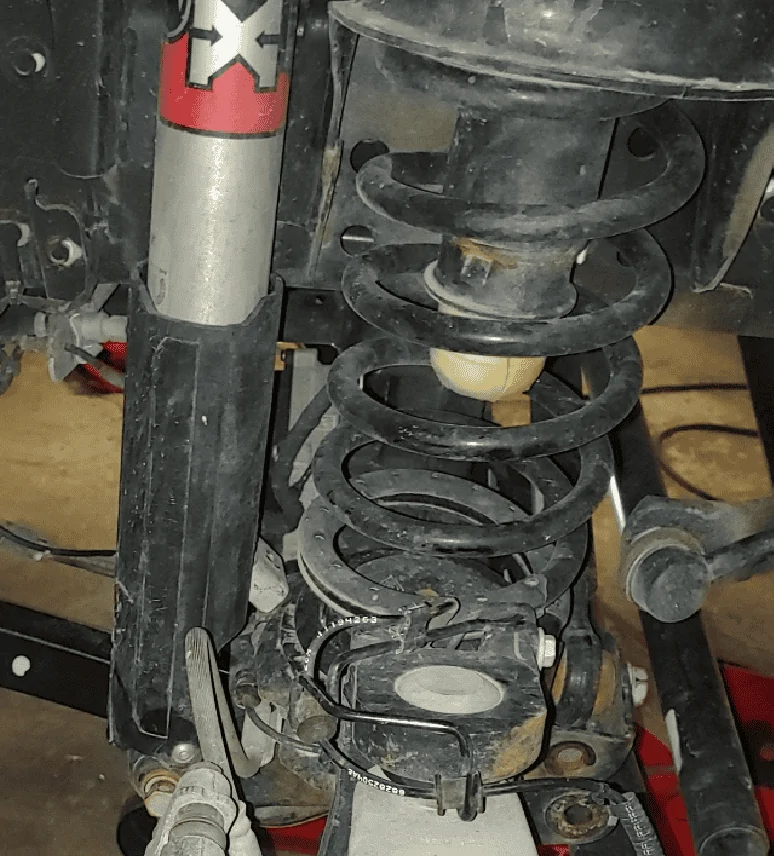

Just my 2 cents. can you put airbags in the front springs to help with the load and keep the truck more level. I do not use a plow but my blade on my kapota does a good job.
40,440
53,854
Not sure how you could do that considering the location of the bump stops.............
This is with suspension fully extended down -full droop, and there's not much space -
Jeep Gladiator Snow plow 1671210640957
This is with weight off the truck, but suspension not extended or pulled down. Sitting on the wheels normally loaded there's even less space than this inside those coils.
They'd be really tiny/short and interfere with the normal bump stop operation and in fact, could push up against it.

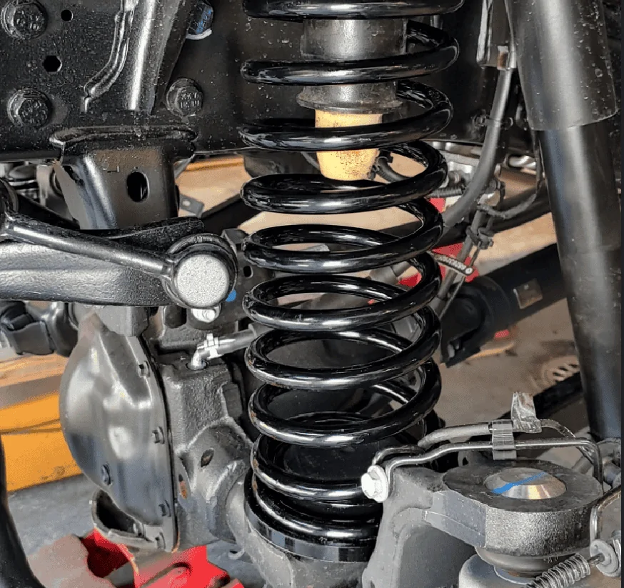

I see that won't work but how about the old rubber spring spacers the old hotrodders used for raising the rear of their GM cars back in the 60"s. You had to twist them into the springs .
JEGS 60836 Coil Spacer Boosters 1" Lift
40,440
53,854
Problem there is that you'd take a spring already pushed down, compressed, and take some of the coils out of play. Those aren't exactly something I'd use in a decent truck. Hard on springs, IMO.
The only true way, IMO - is springs with a higher rate. That's going to impact your ride when there's no plow on it. Next best is perhaps a spacer above the front spring so that the whole spring still works. That would lift the front when there's no plow on the front, though.
For me, it will likely be another pair of Synergy springs - they are multi-rate and won't impact the ride much. I have the 1" lift springs, I'd try the 2" lift springs.
When I put the steel bumper, winch, heavy winch plate, and front receiver up there it took the front of my Overland down about 1".
The 1" synergy springs were supposed to lift a Rubicon with steel bumper, winch, skid plate and so on 1" but all it did for mine was put it back to normal Overland ride height.
So the 2" springs should get me back to normal plus raise it 1". And if you look at my truck, there's a lot of rake without the plow loaded up.

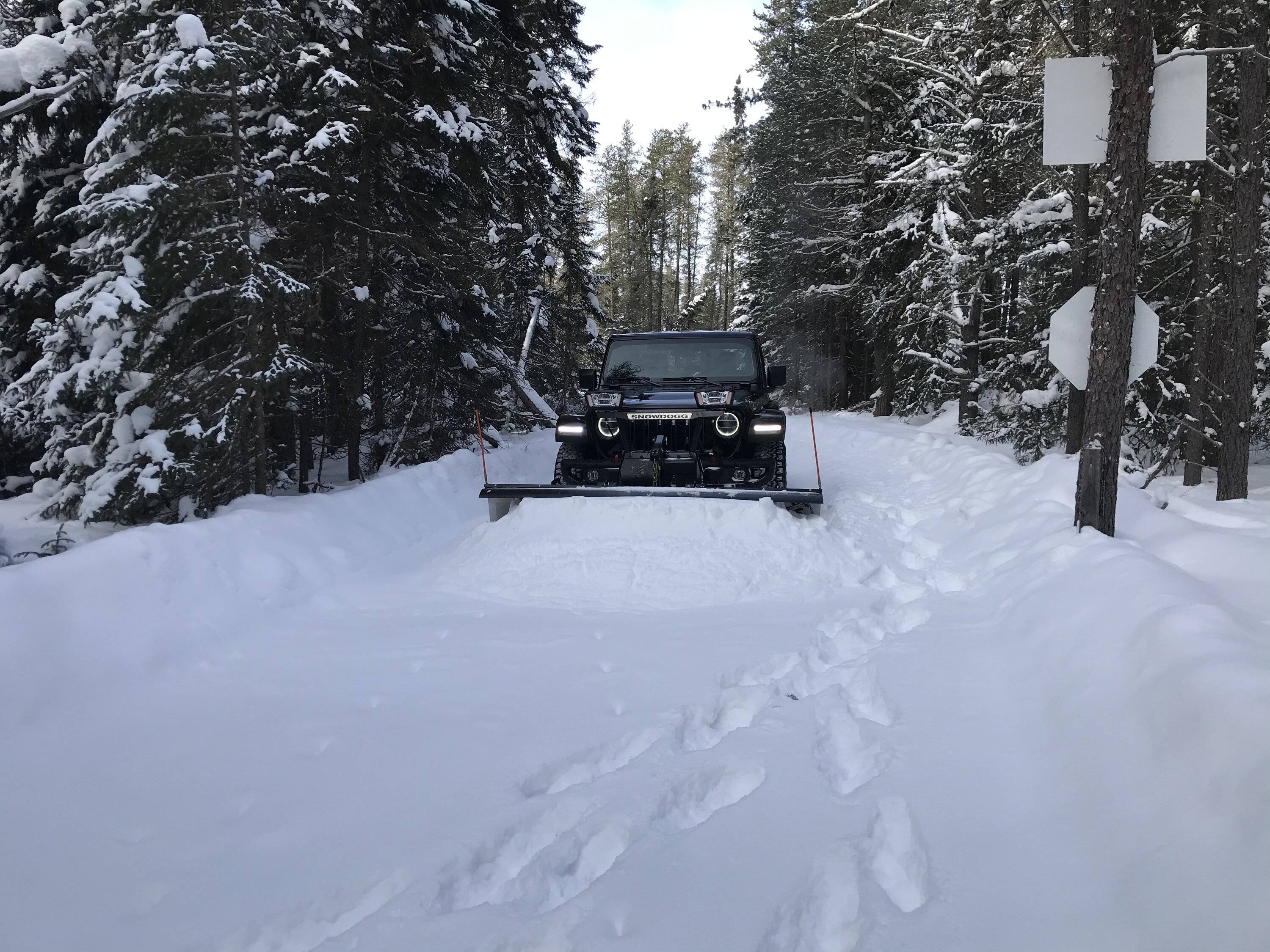

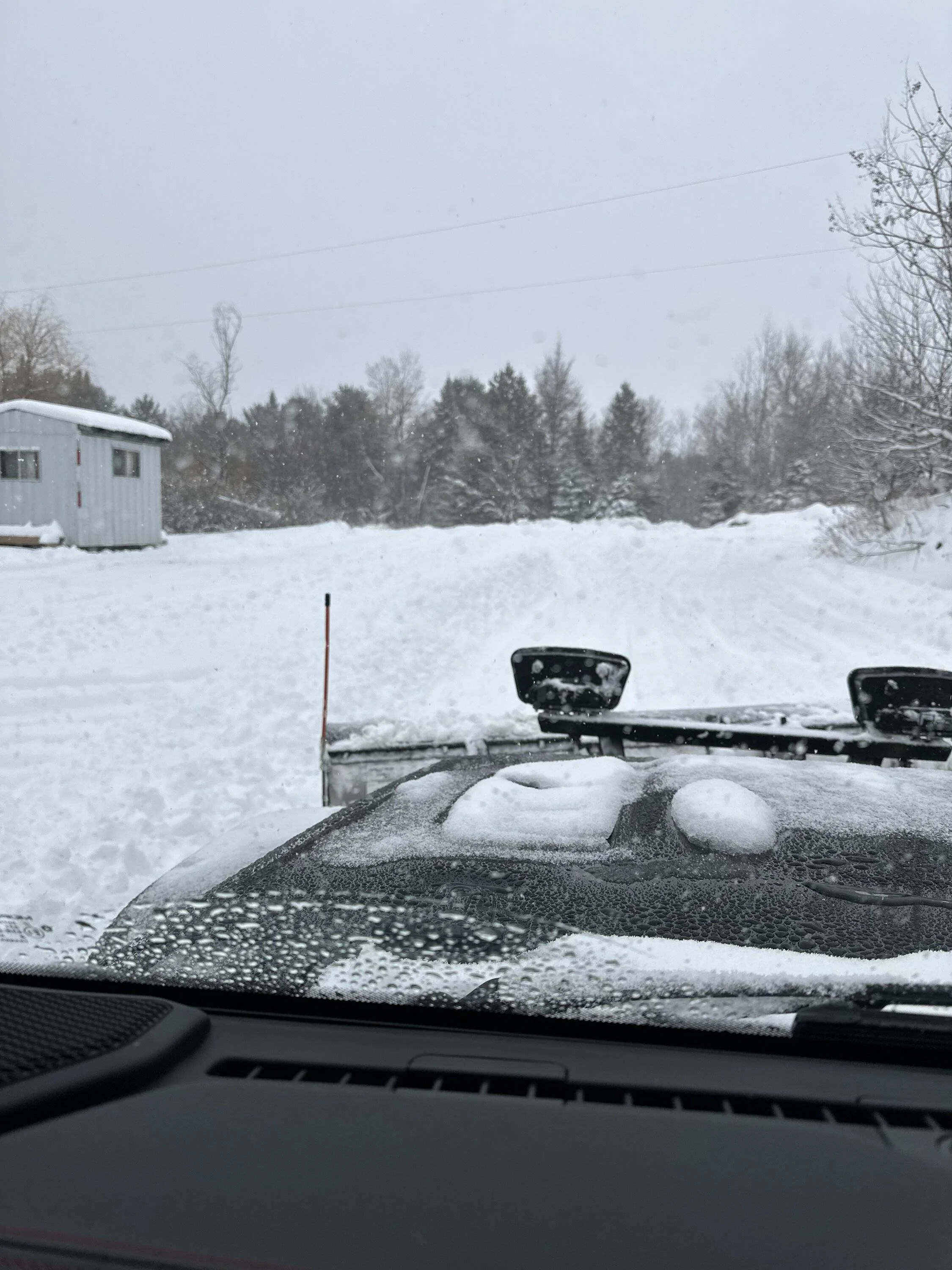

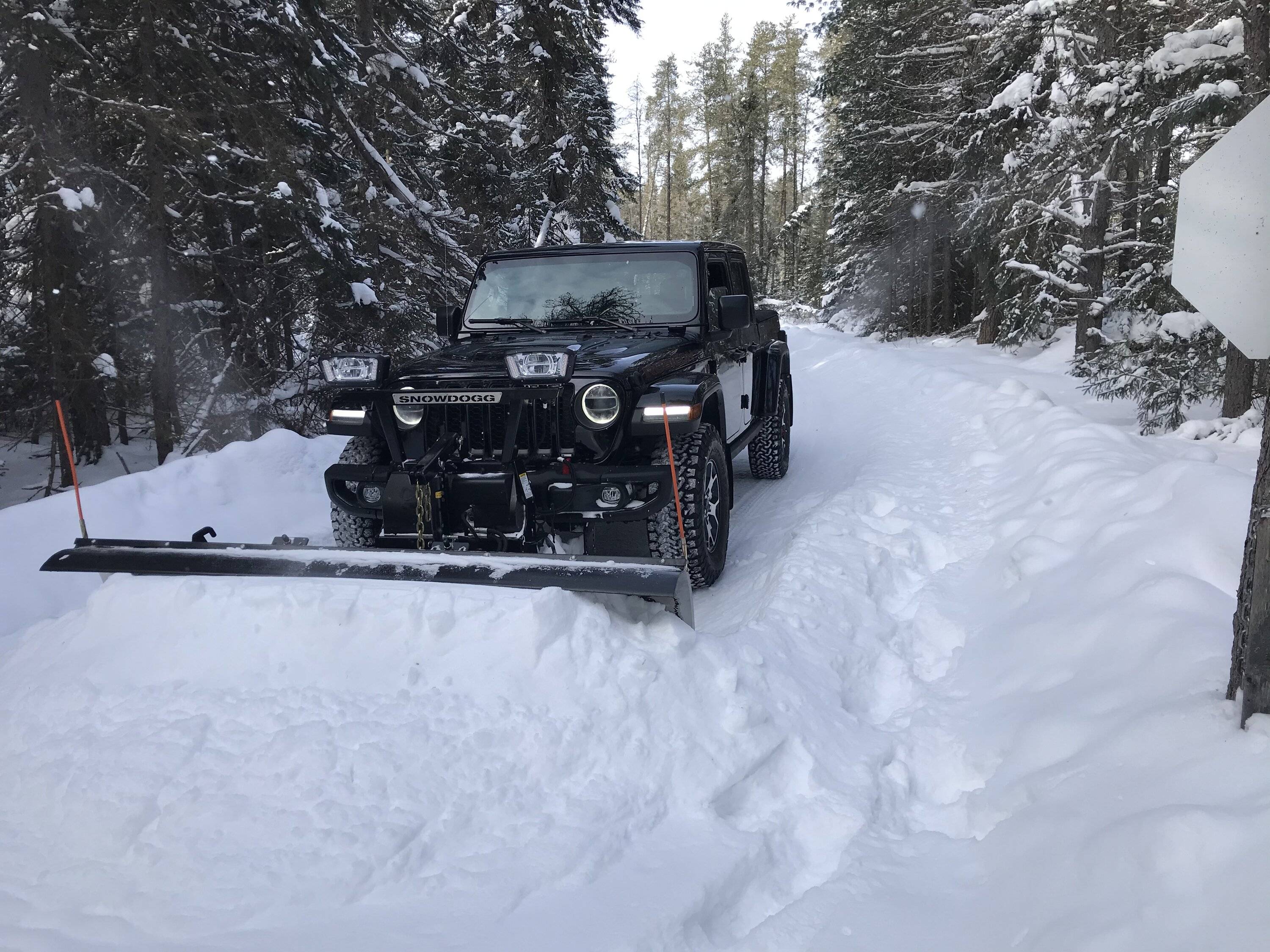

Well I have had both 1st was a gas rubi now I have the exact same only eco diesel I will tell you the gas did better holding the plow up, the eco is pretty much on the bump stops all the time, springs are to weak for sure, hit any bump or Train tracks it hits hard, as for heating issues Non existent , I am in Ontario CANADA it’s cold, eco diesels will bottom out new with nothing on the front they need different springs, I am putting on my Aev spacer kit so will see if it helps at all, mine is a snow dog plow for the gladiator or reg jl steering and all are fine , I installed this plow in both jeeps the first gas last winter and the eco this fall
