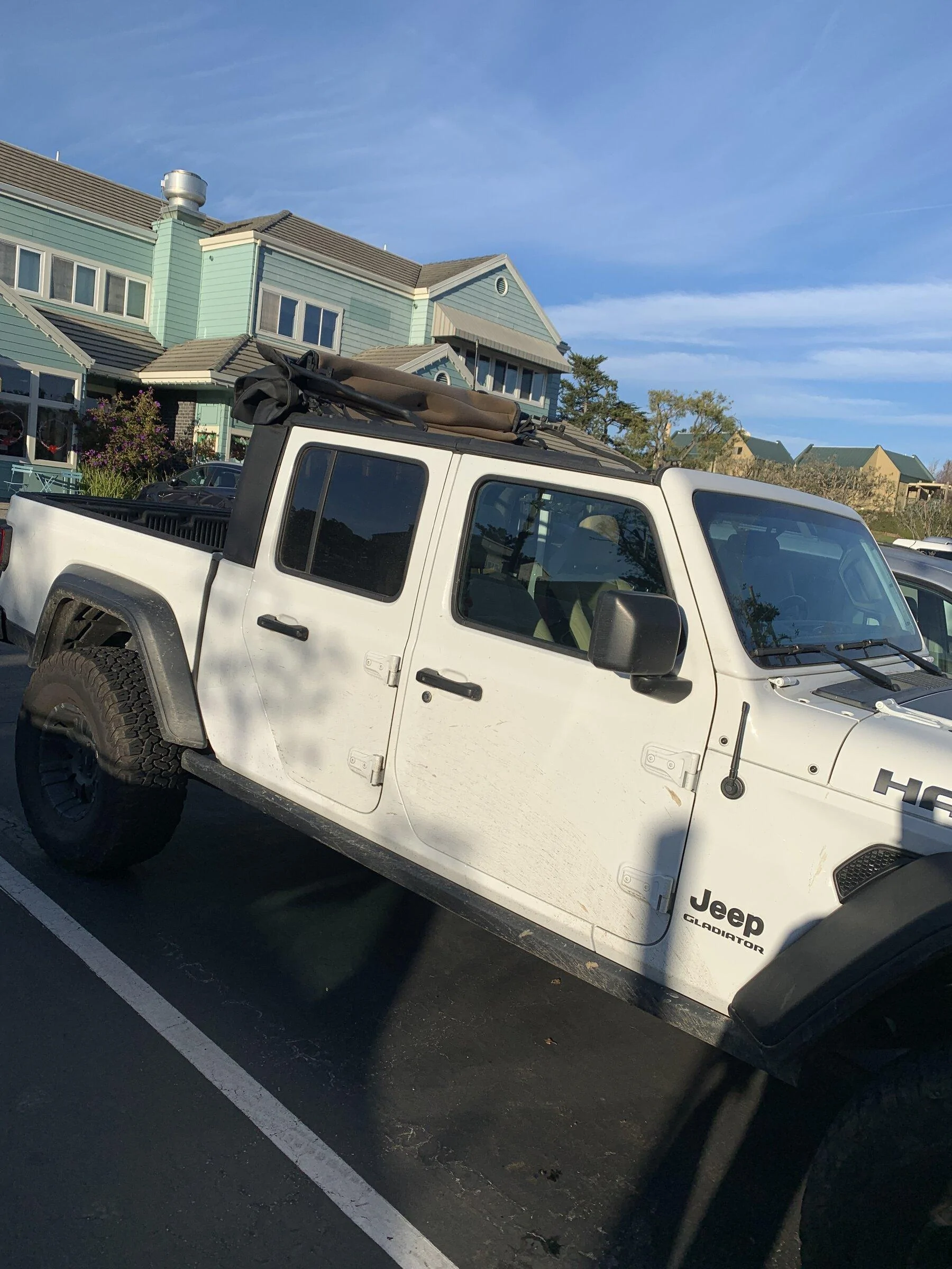

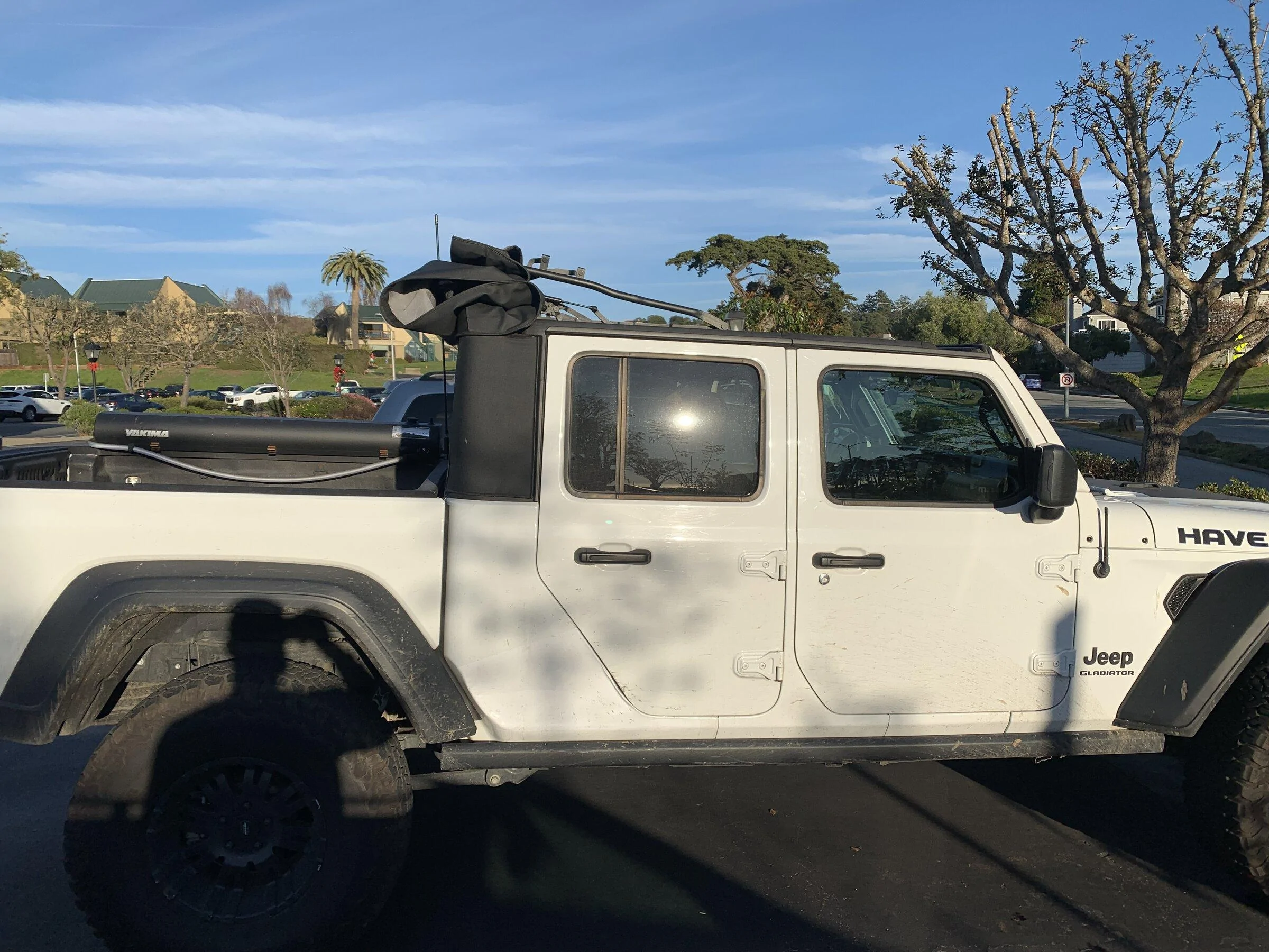

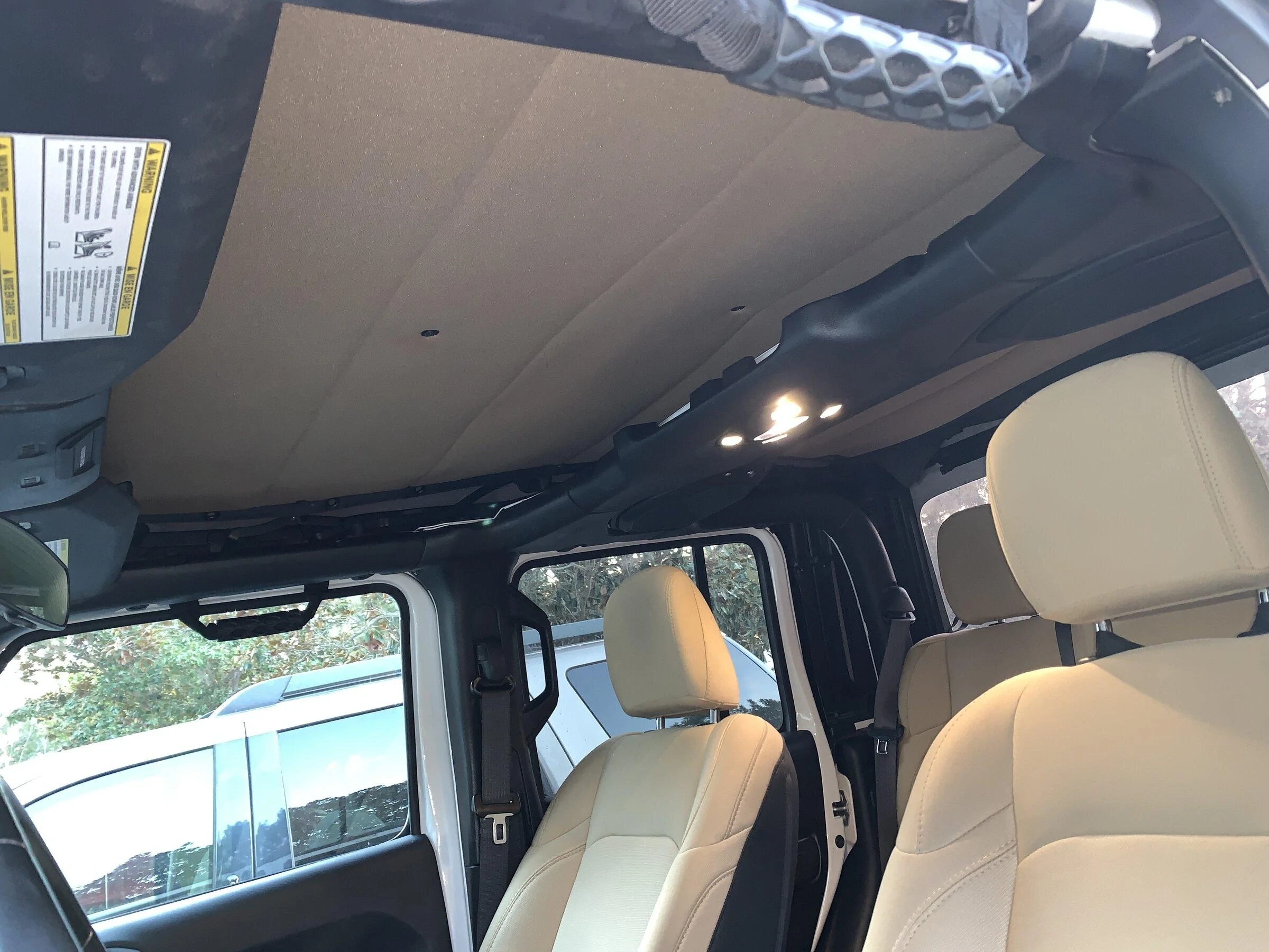

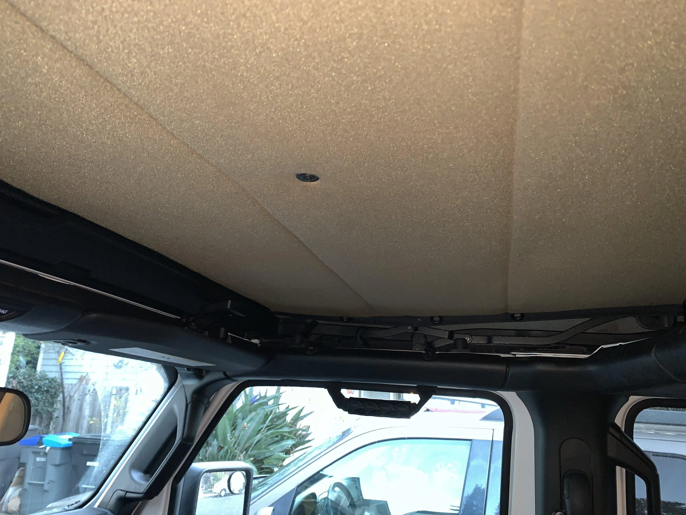

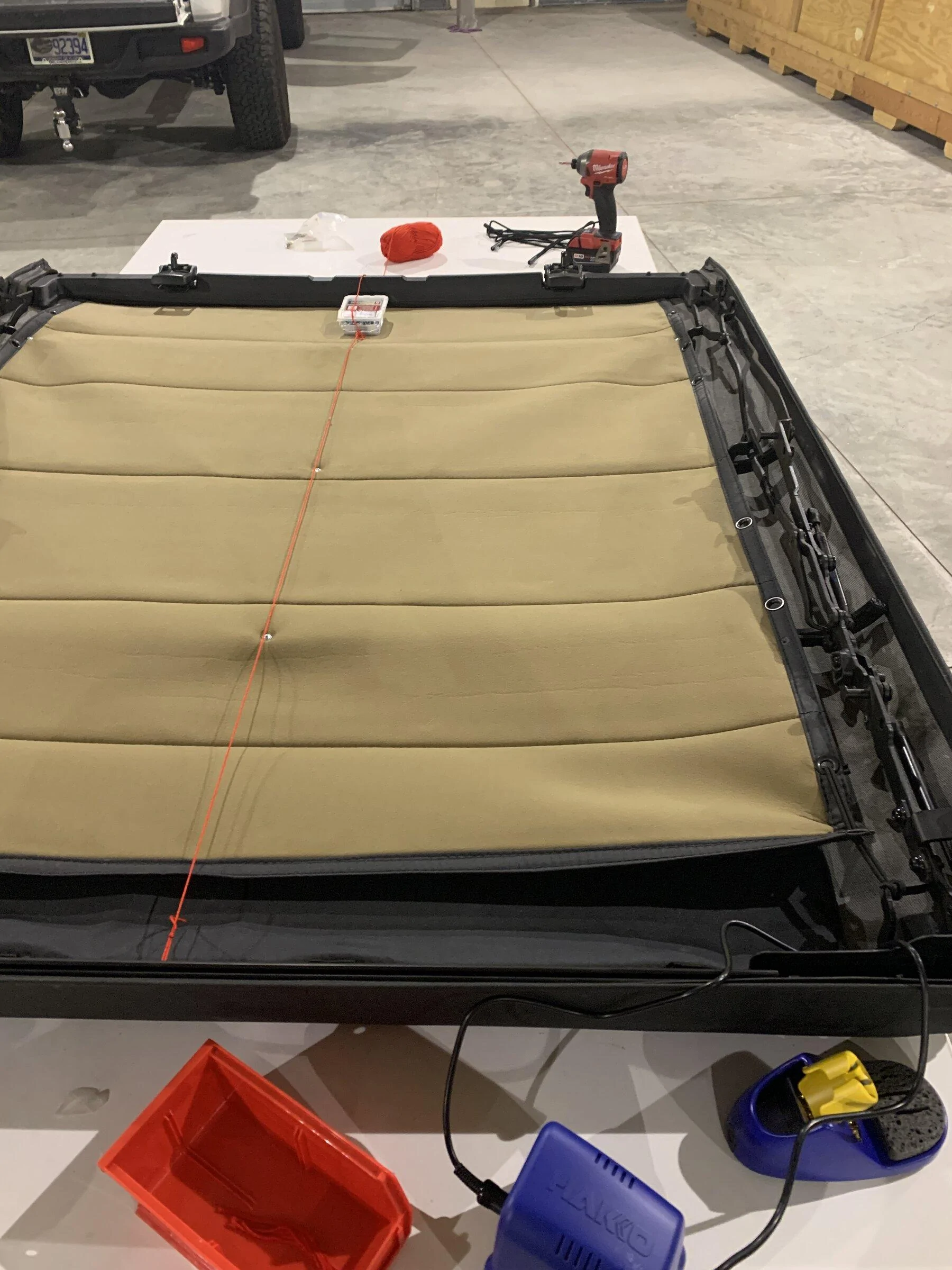

I just went ahead and screwed my hotheads to the frame with self tappers and overall it’s pretty acceptable. The folded pictures are after ~10 miles on the highway @ 70mph.

This is so intriguing. The Hot Head is just attached along the perimeter, nothing in the middle?
What benefit are you noticing? Is the sound in the interior noticeable quieter?

The difference in wind noise is noticeable, but still sounds like a Jeep. I got this more for thermally insulating the top and I’ve already noticed a huge benefit on that front.
There are fasteners in the middle to help keep it all together. Funny enough, the center holes come predrilled from the factory. I think they are there for moisture, but I’m not sure—they work great for this though.
