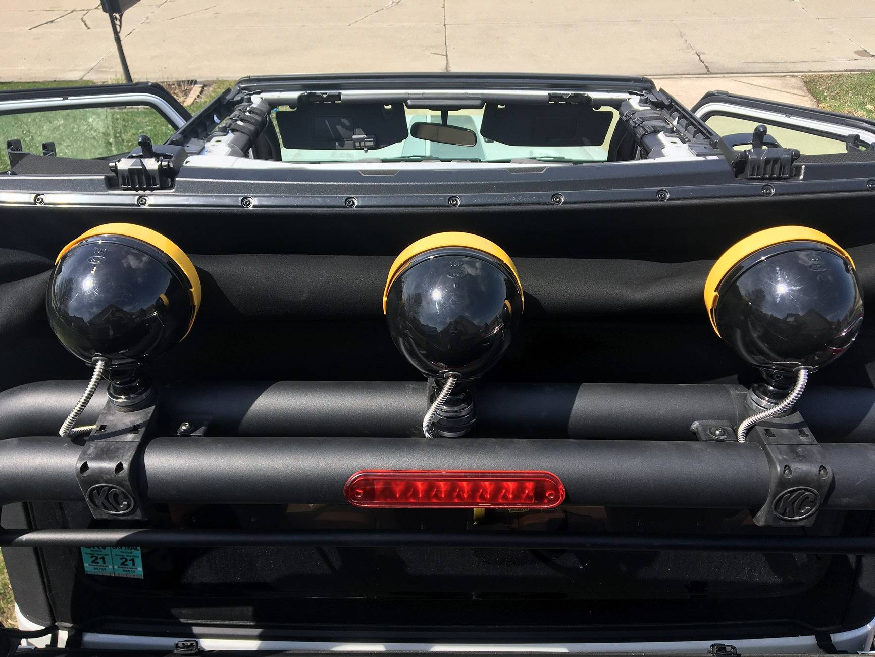

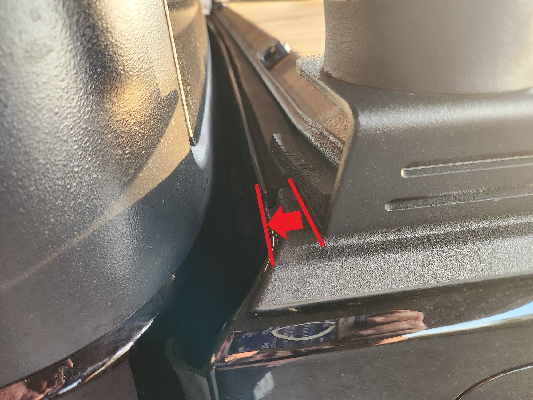

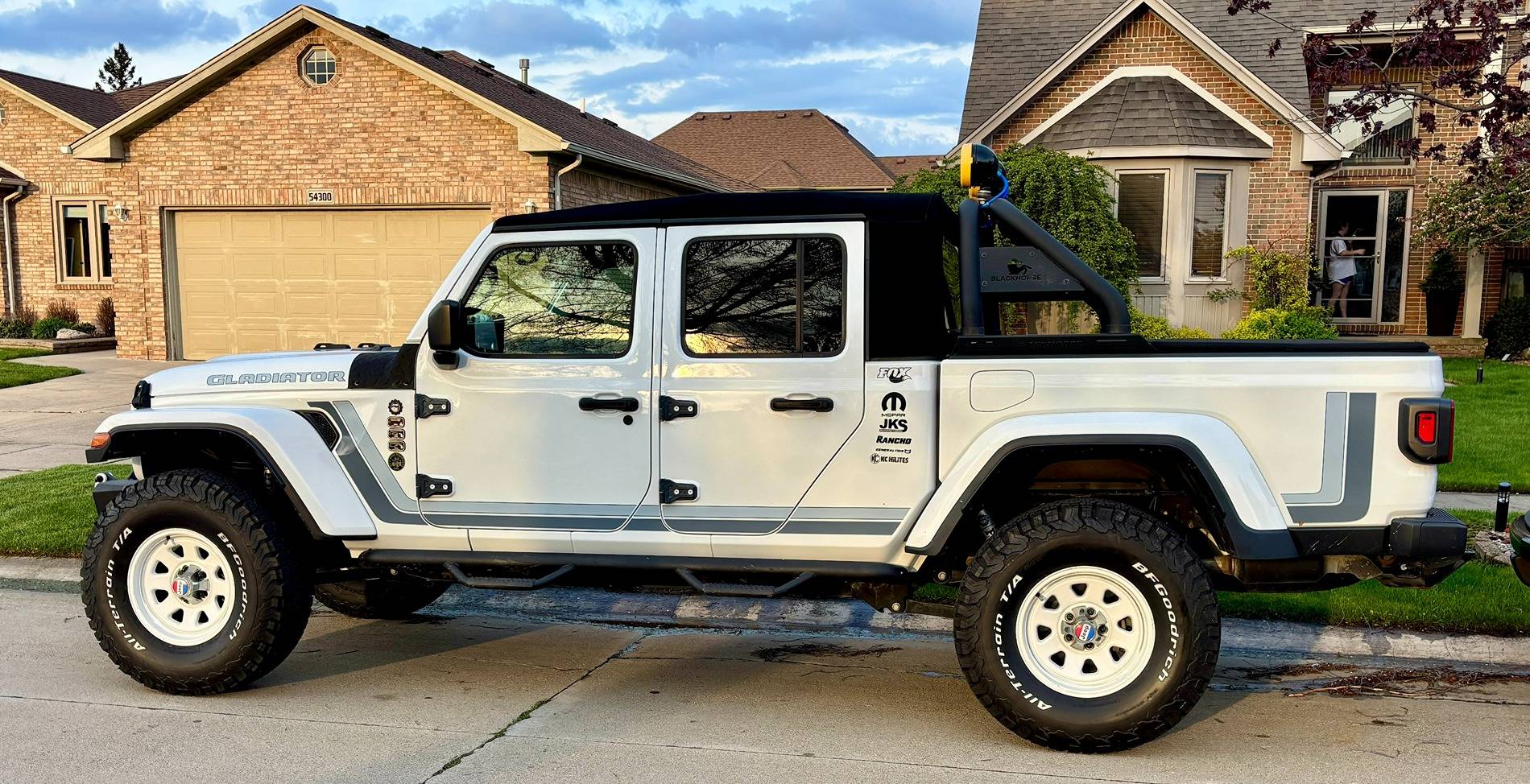

I've always had the soft top with my Blackhorse and KC lights. Its a few inches off the front of the bed (can measure tomorrow if you want exact dimensions). I set it up so it barely clears the lights when open. I also added spacers to get the lights higher up on the mounts as they tend to hit the bow just above the rear door (hinge point) in the soft top and not let all the light shine in front of the jeep.
I didn't want it so far back that it looked silly with rear window and side panels off with the soft top still on.
The 2nd pic is before I installed the larger spacers on the KC bolts to move the lights higher up. I can take updated pics tomorrow if you want

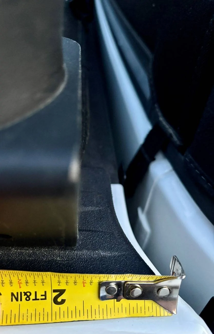

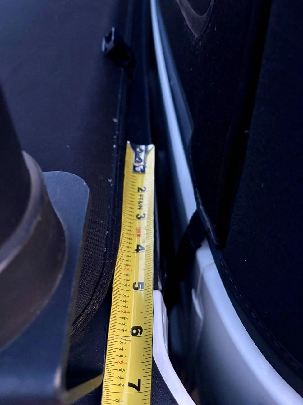

Here are the measurements. Its exactly the width of the tape (1") from flat edge of bed rail protector to front of roll bar base. Or 1 5/8" from the pointed edge of the bed rail protector. Or about 1 1/4" to 1 3/8" from your mark to the front of the base
Hop this helps

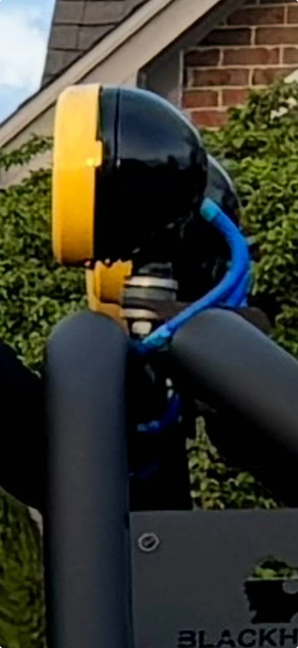

Keep us posted on what you end up with. I forogt you asked about the KC mounts. To clear the soft top, I ran the outer 2 on the back bar canted towards the front of the jeep but because the rear brake light is in the rear tube in the middle, I had to mount the center one on the front tube, but reverse the mount so its cantered towards the rear of the jeep
Here they are. They are sold in pairs and singles. 3" diameter tube
https://www.amazon.com/KC-HiLiTES-7...ocphy=9016806&hvtargid=pla-2281435177898&th=1
Let me measure the spacers for the lights. You're very limited if you go with KC because the bolt is captured unless you want to swap it out somehow. I want to say they are 5/8" tall, with a 1/2" hole for the bolt and 3/4" in diameter to match the metal and rubber spacers that come with the lights. I'll verify that tomorrow
