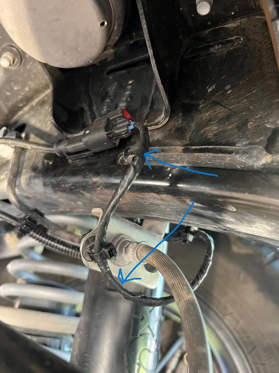

Mine was bad wires in the same place. About 4" upstream towards the main wiring harness after the ABS connector. As I was removing the tape to inspect, the wires just pulled part in my hand. Spliced them back together and all is good now. Pic of the wire location after repair.

I have a Mojave 3.6 gasser, no front locker. If you trace the pair of wires from the ABS sensor starting at the wheel hub (passenger front is where mine was) the wire runs up over the ball joint, then around and under to the inside of the frame. There, it has a connector. If you buy a new ABS sensor this is where it plugs in. After that connector, it's still two wires that run back out to the outside of the frame and then up and into a main wiring harness by the passenger side head. This is the section of wiring where mine was broken.
I know the drivers side is slightly different after the ABS connector. On mine it goes up and plugs into a harness on the firewall.
I found my problem by having my buddy start the truck while i got under and started wiggling wires till the ABS light would come on. Eventually I narrowed down where the issue was, and made the repair.

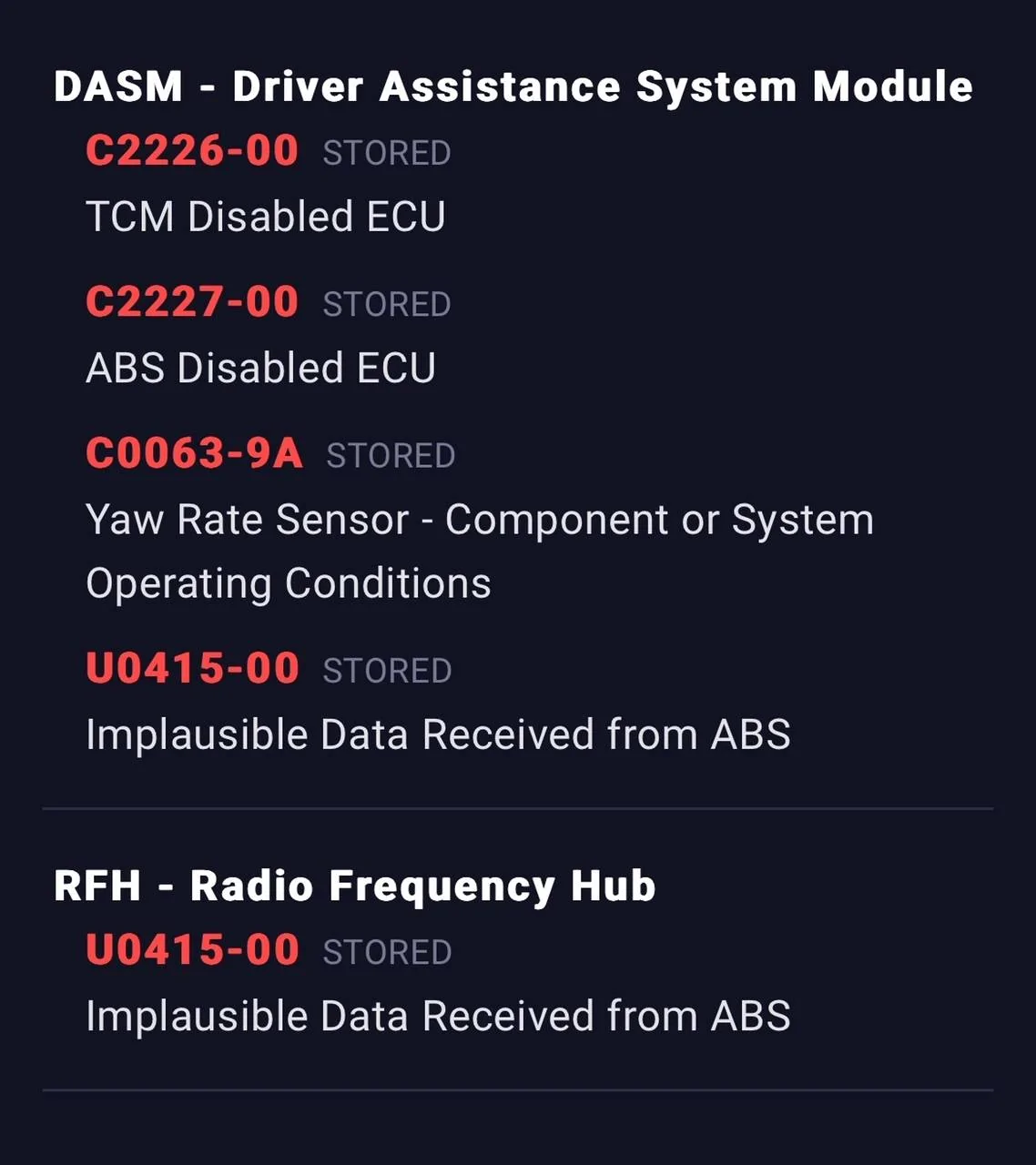

By the way, this image shows the pins on the ABS module that are associated with each wheel speed sensor.
