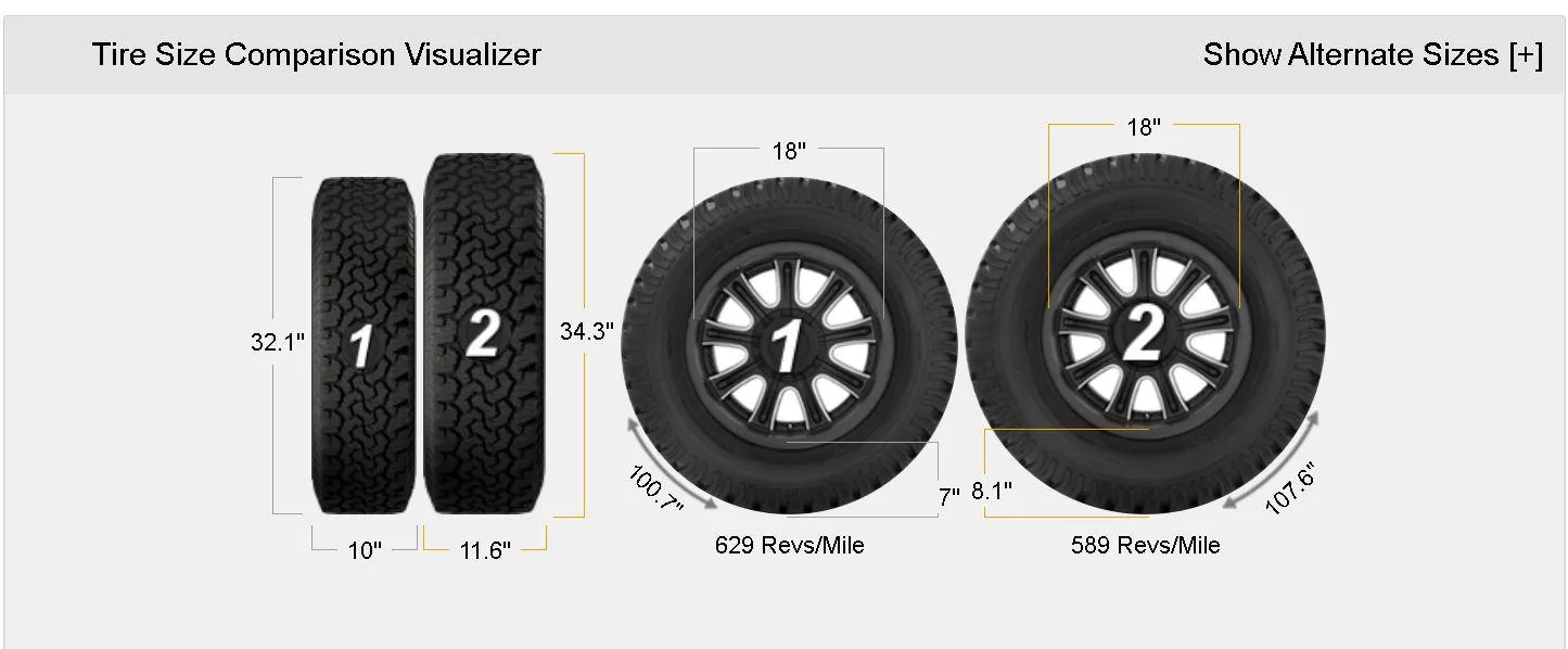

What are most people doing when they size up in tires.
Was most likely going to 295/70 18" on stock wheels.
Jeep Gladiator Spare Tire question. Captur
Should I go with a 315/70 17" on Spare to be close, or just deal with spare being smaller in case i need to use it?

I think a 285/75r17 would be closer in size
The 295/70 18 has a height 34.3”
The 315/70 17 has a height of 34.36”
The 385/75 17 has a height of 33.84”.
I based the size purely on closest height.

I went with 35x12.50 on stock wheels and its just fine. Same with the spare, I kept the steel wheel under.
But my rims are 18” and Spare is 17”
