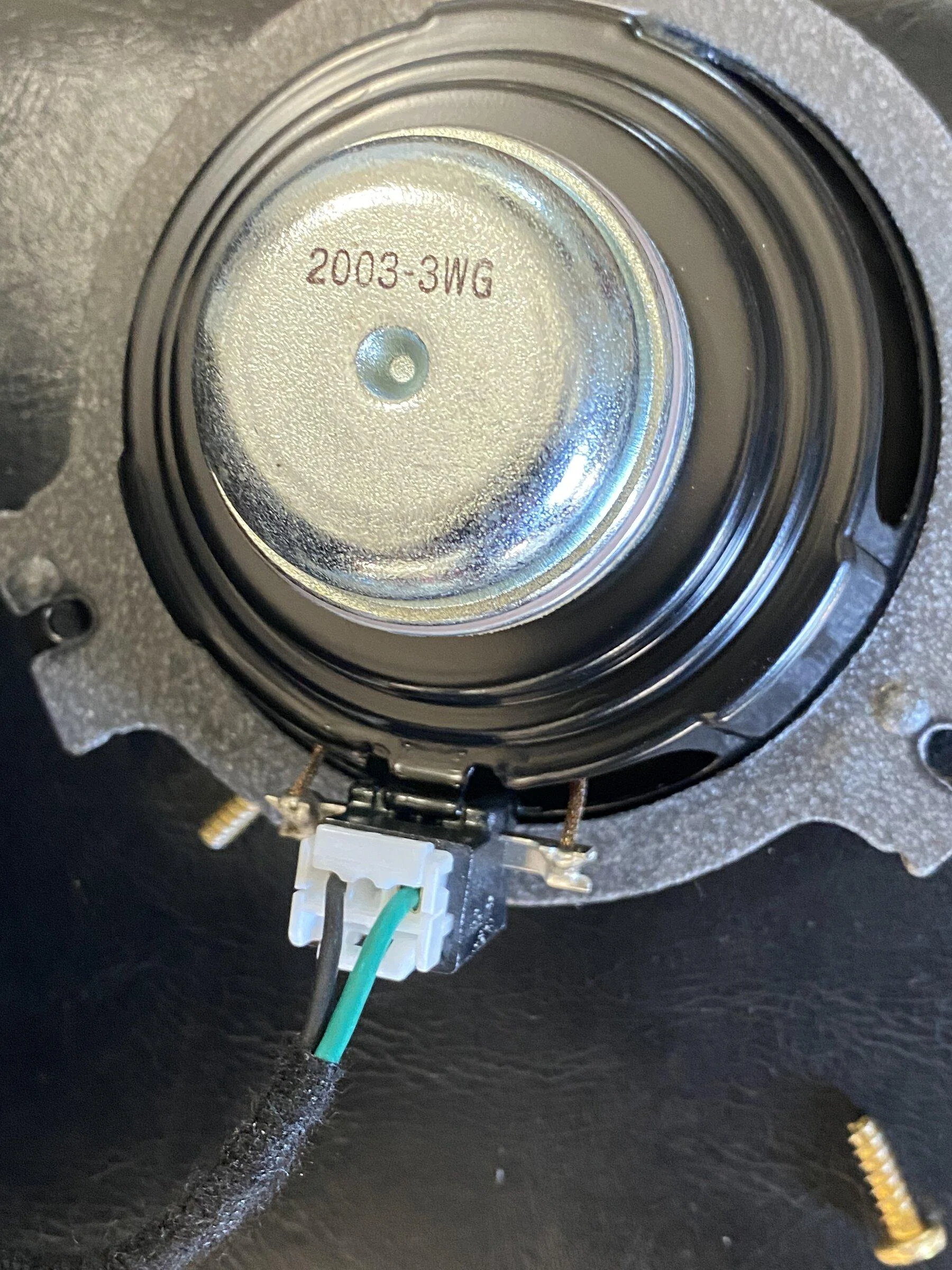

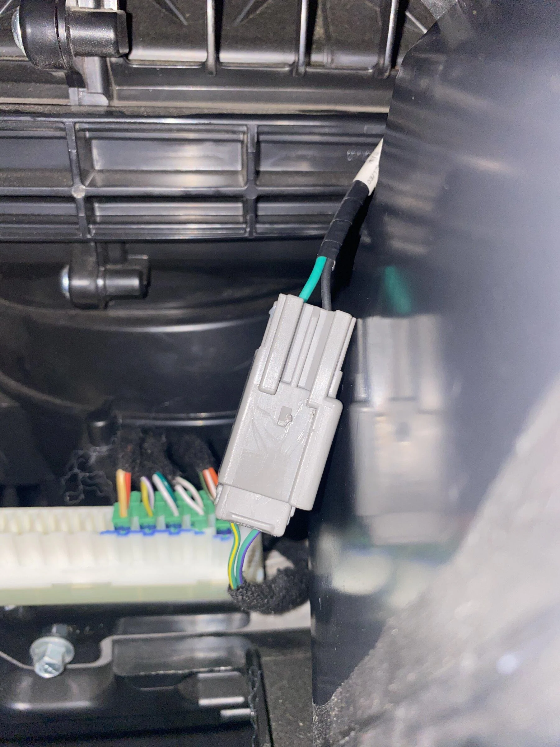

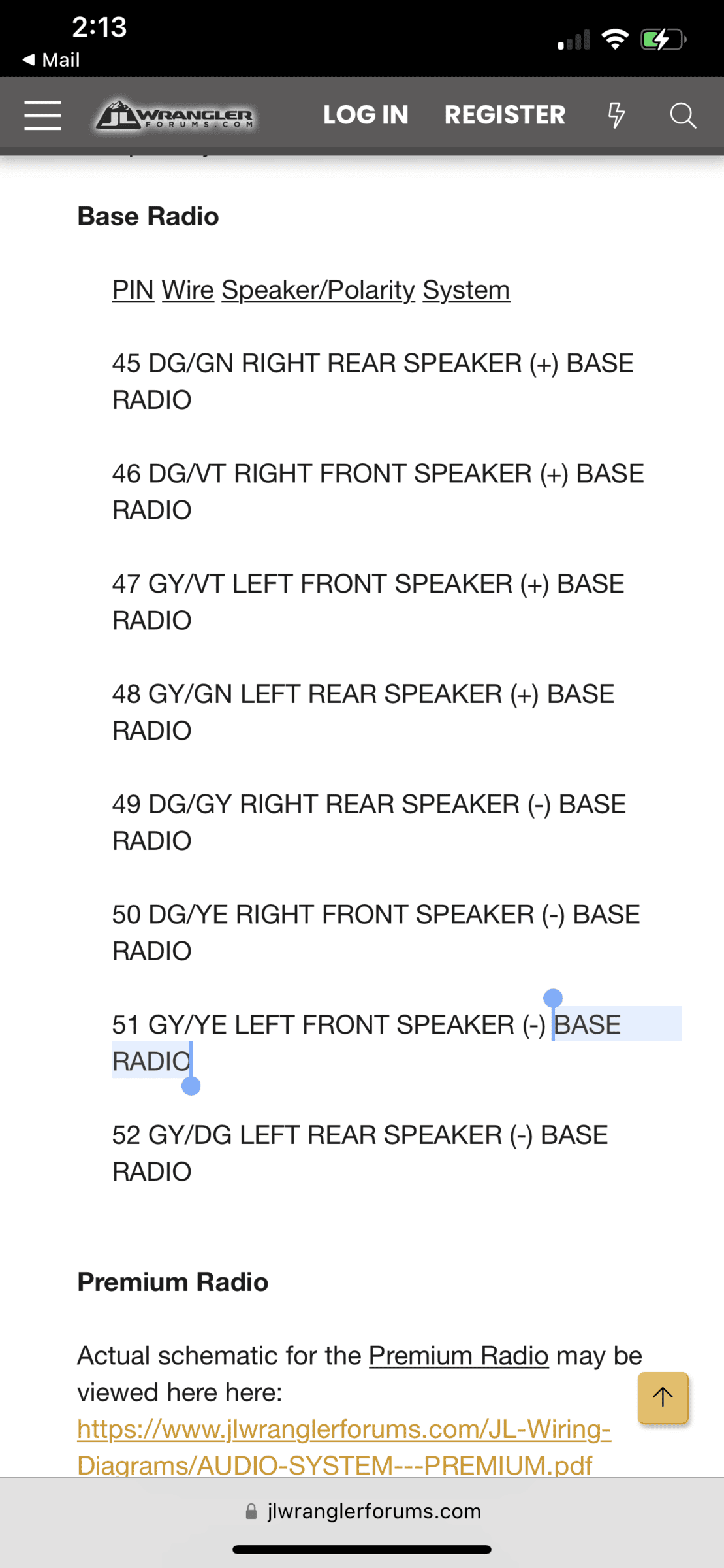

So here’s some more pics ….so I checked the stock speaker with a 9 volt battery to check polarity … battery test determined the right side is positive …as you see the green wire is on the right ….so on the factory harness the green wire should be attached to green /violet for positive … but as you see it’s attached to green yellow .. which means jeep wired it wrong ..I used the polarity app to the Check polarity before install and it was negative while all the rest were positive … I did swap the wires around in the Metra harness to make make the new speaker polarity positive …

So here’s some more pics ….so I checked the stock speaker with a 9 volt to check polarity … battery test determined the right side is positive …as you see the green wire is on the right ….so on the the factory harness green wire should be attached to green /violet for positive … but as you see it’s attached to green yellow .. which means jeep wired it wrong ..I used the polarity app to the Check polarity before install and it was negative while all the rest were positive … I did swap the wires around in the Metra harness to make make the new speaker polarity positive …

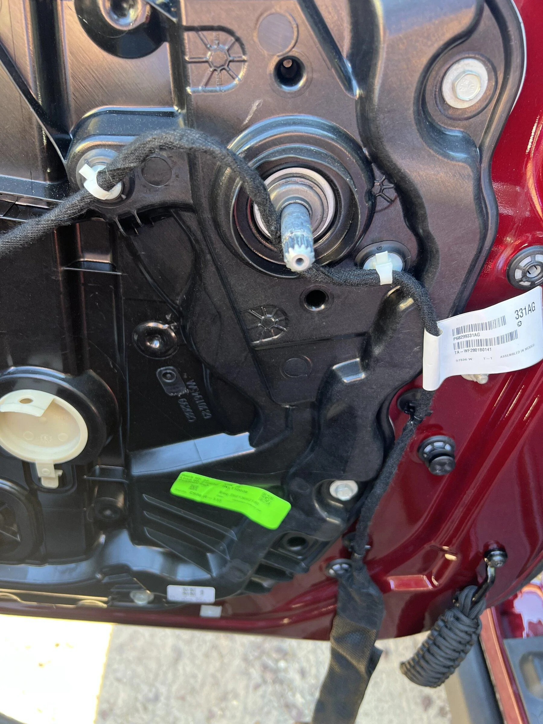

I wouldn’t say wired wrong, because it seems to be consistent, but definitely reversed for some engineering reason. I’m not gonna defend them because I just found this beauty of wire routing in the door. Just route the harness right up against the window crank, by design🤦🏼‍♂️
Jeep Gladiator Speaker polarity 73D78895-7068-4980-AEC3-2A345BA5B092
That’s crazy right there !!
