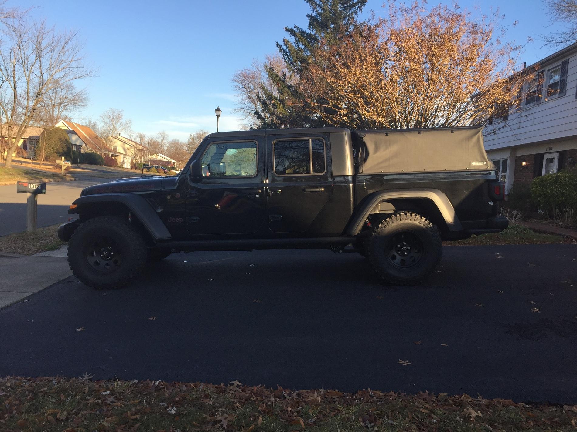

Oct 24, 2019
525
636
A couple of notes on installation for anyone else who gets one of these:
A metric wrench (I think it was a 13mm or 14mm) fit better on the clamp bolts than the suggested 9/16” wrench.
When attaching to each other the three rear window bars, it helps to drill a starter hole in each of the outer two smaller bars in the correct places with a 5/64” drill before trying to screw the two small self-drilling screws into the smaller bars.

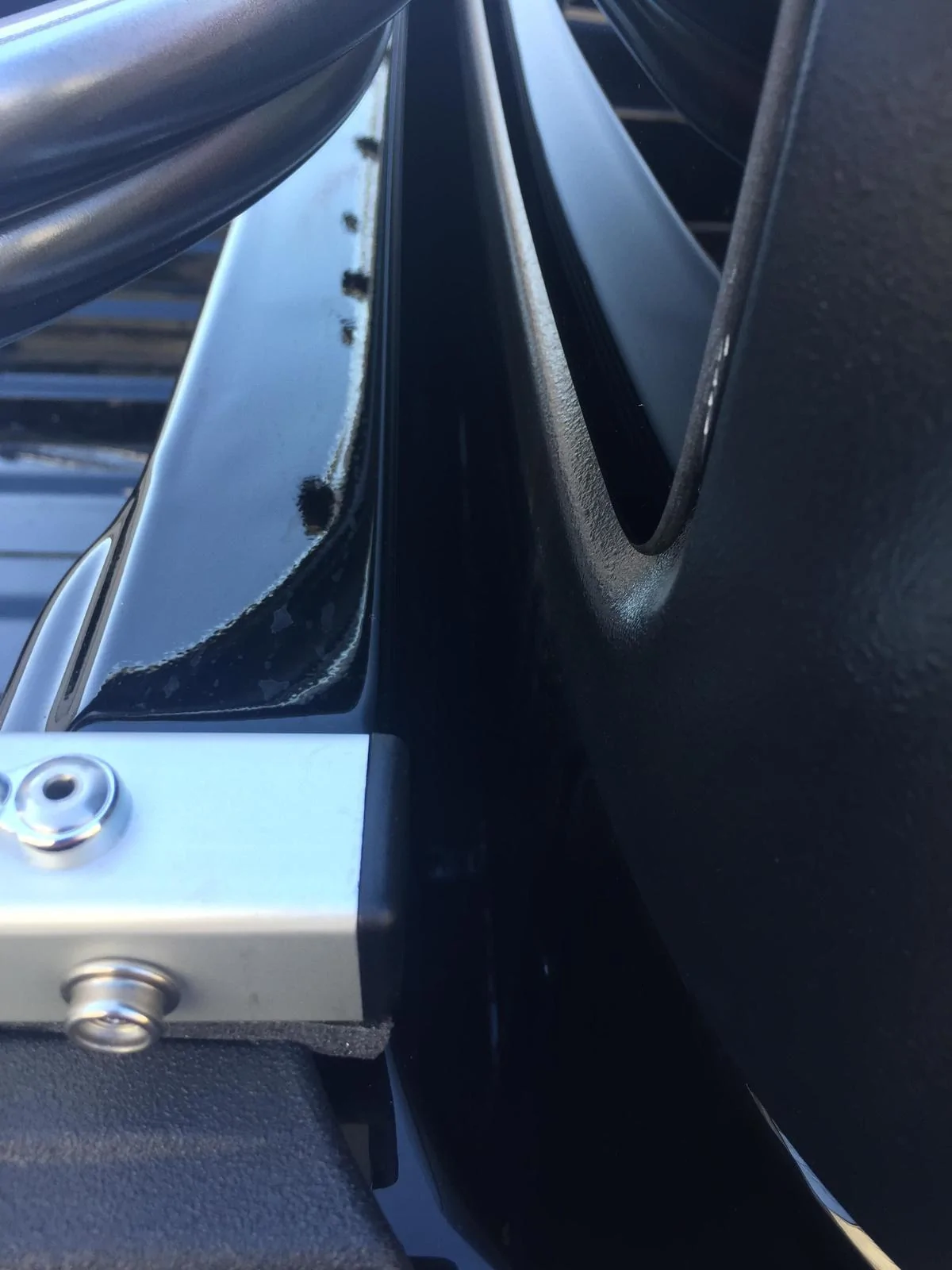

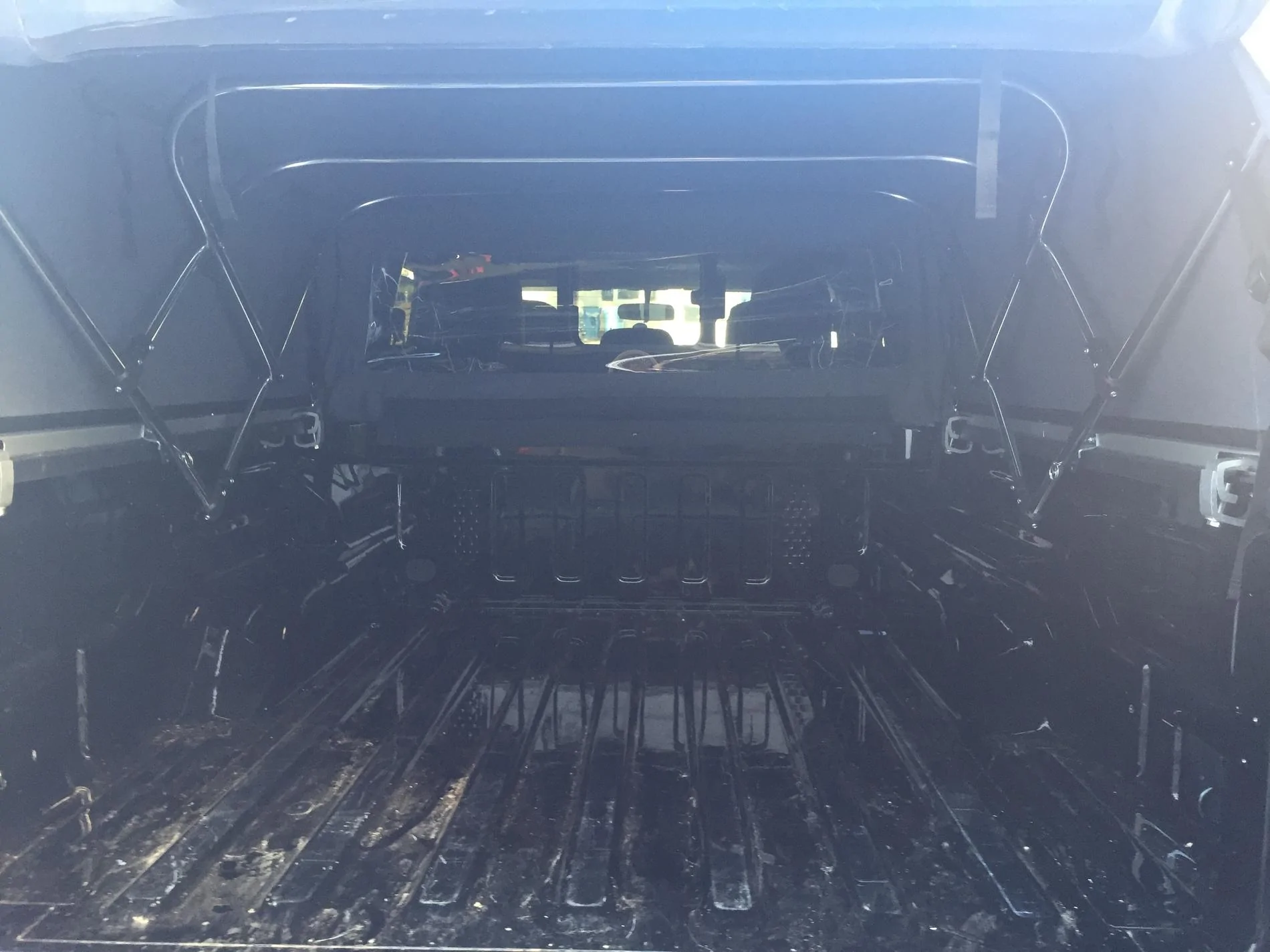

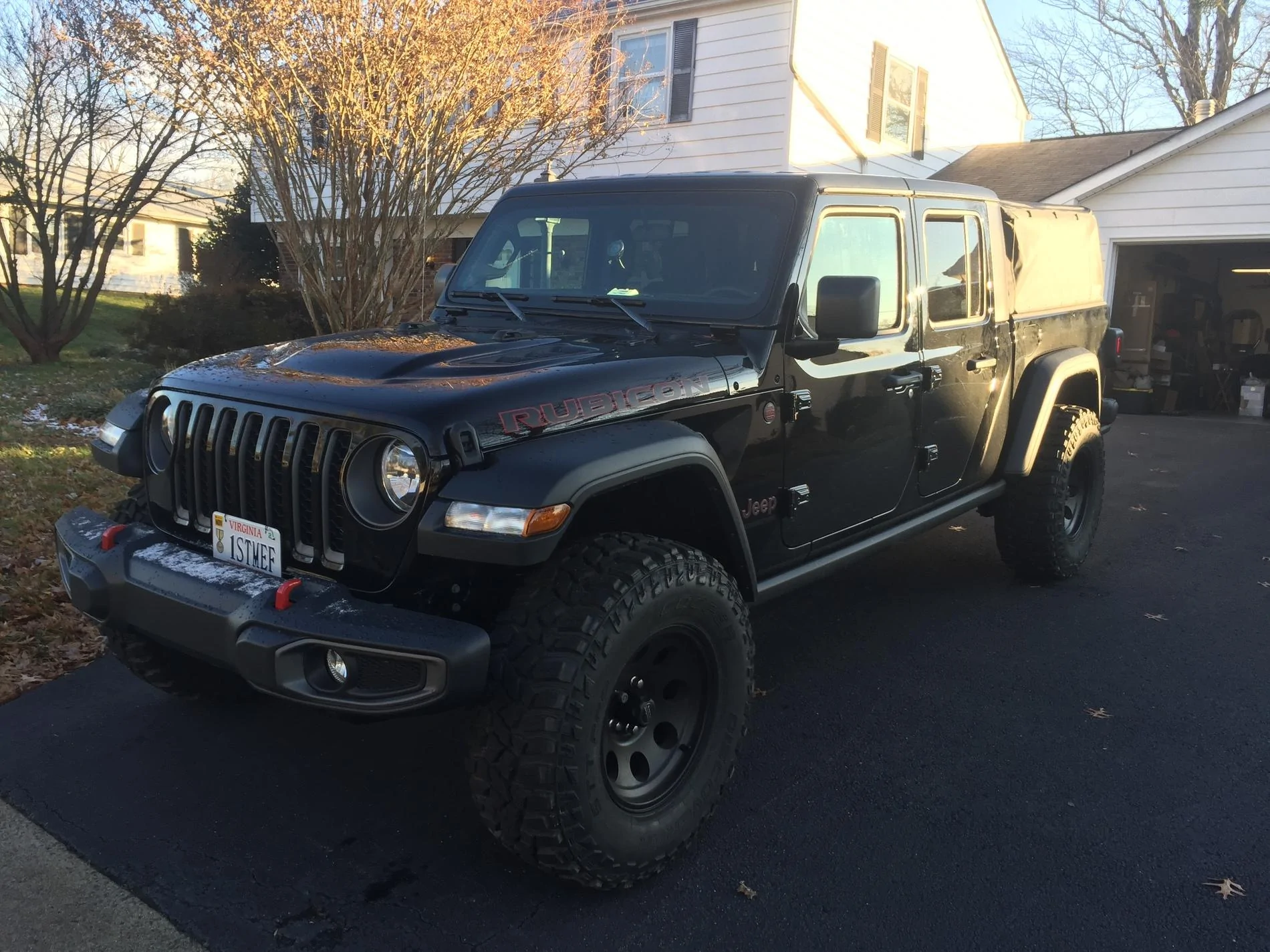

The instructions suggest starting out by placing the front end of the bedrails flush with the front end of the bed before tightening them down. That looks something like this:
Jeep Gladiator Special Ops JTR (w/ SoftTopper installed) g2hgeky

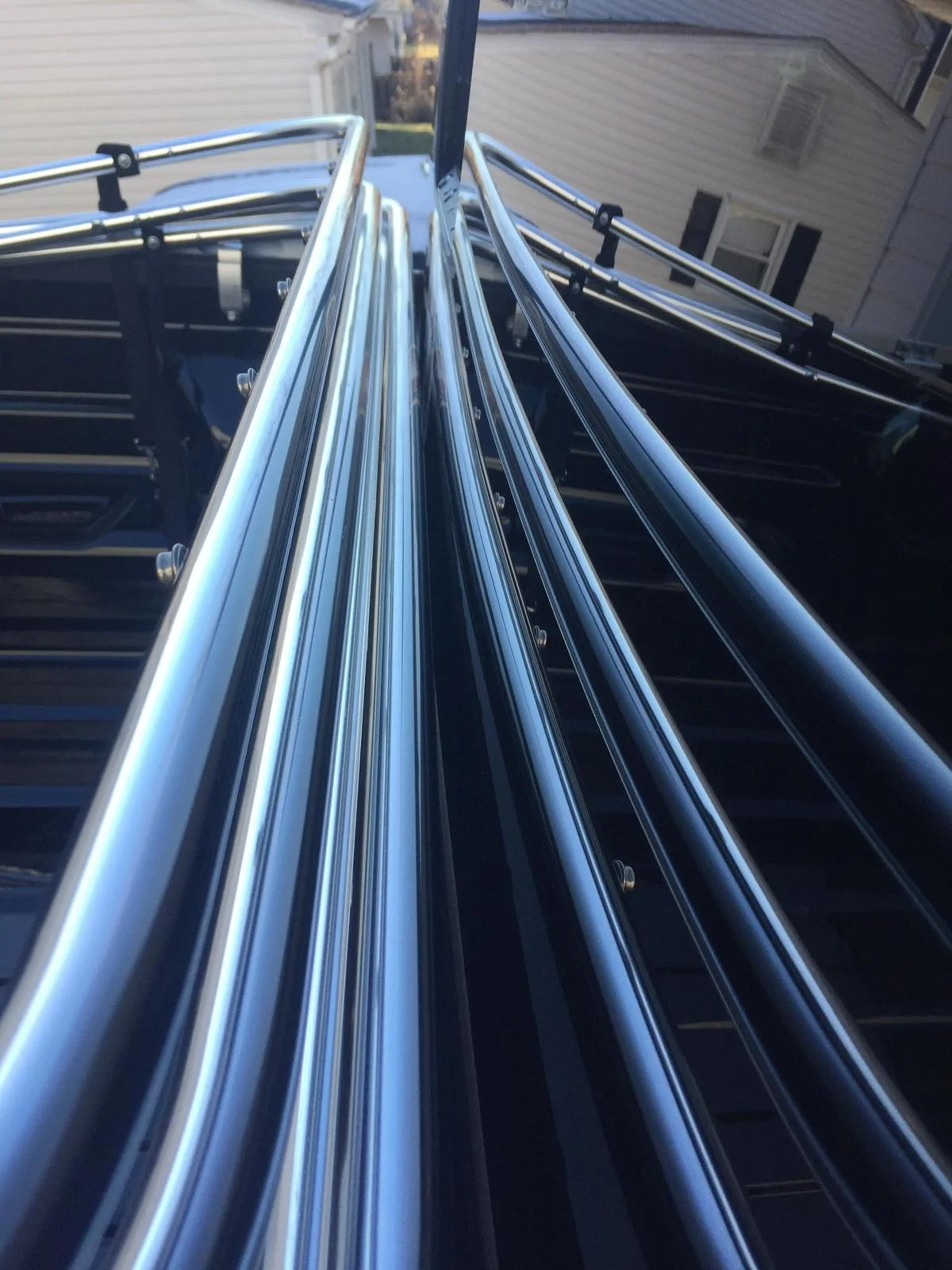

However, when doing that, the front most bar was only about 1/4” from the cab rear window, which was too close for me:
Jeep Gladiator Special Ops JTR (w/ SoftTopper installed) EgEoeHq

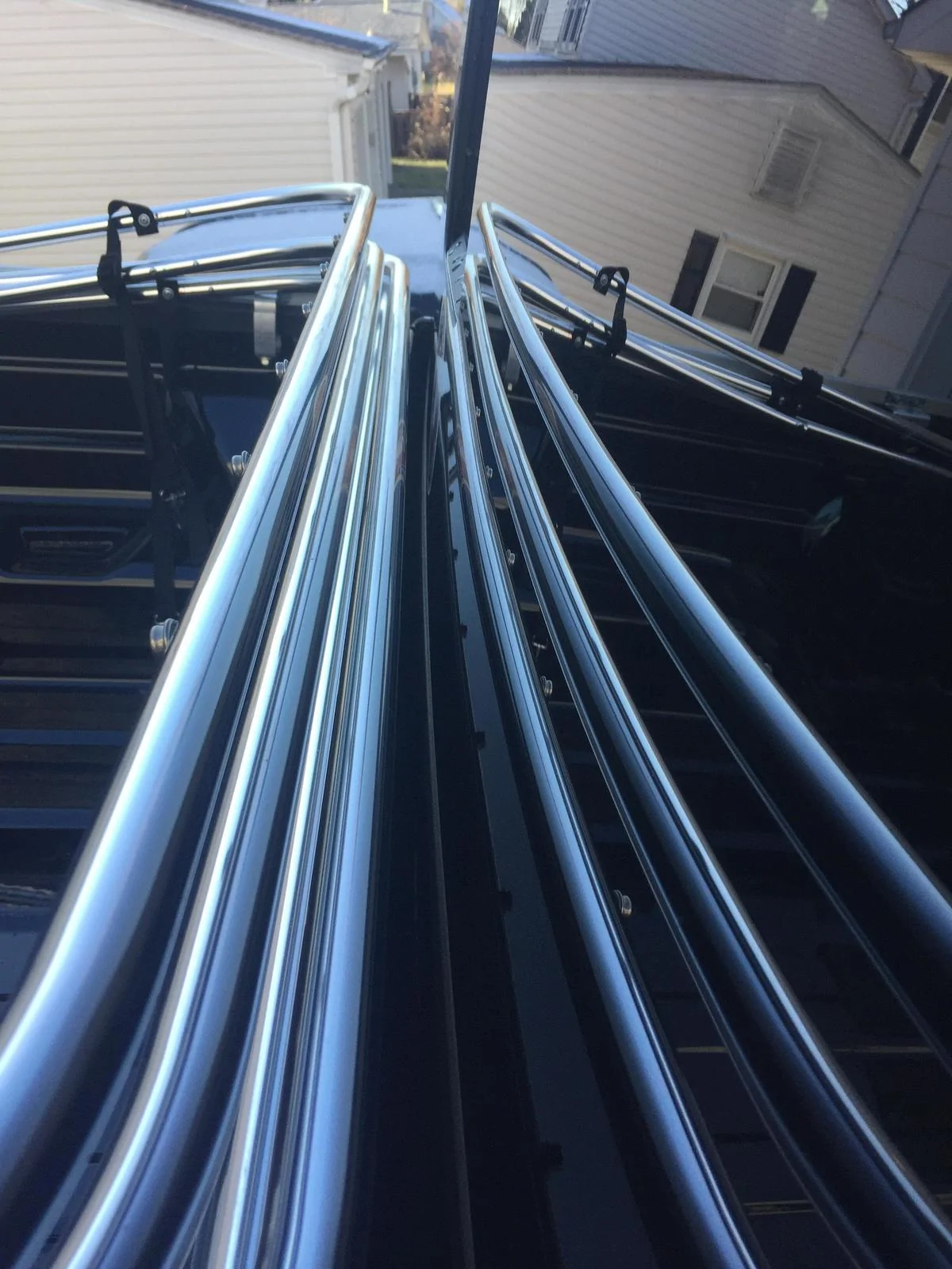

So, I moved the bedrails back about 1/4”, so that they look like this:
Jeep Gladiator Special Ops JTR (w/ SoftTopper installed) iMX74PB
That left a more-sufficient gap, IMO, between glass and the poles when they are laid forward:
Jeep Gladiator Special Ops JTR (w/ SoftTopper installed) Z7ZDLz

The more I see the SoftTopper the more I like it. Your rig looks great!
Thanks Dwosgood. I'm going to hang a black curtain from the rear bar that I can keep rolled-up when I want, and keep rolled down when I want to keep prying eyes out of the inside of the bed.

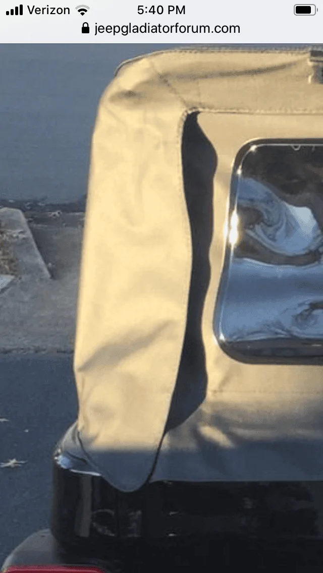

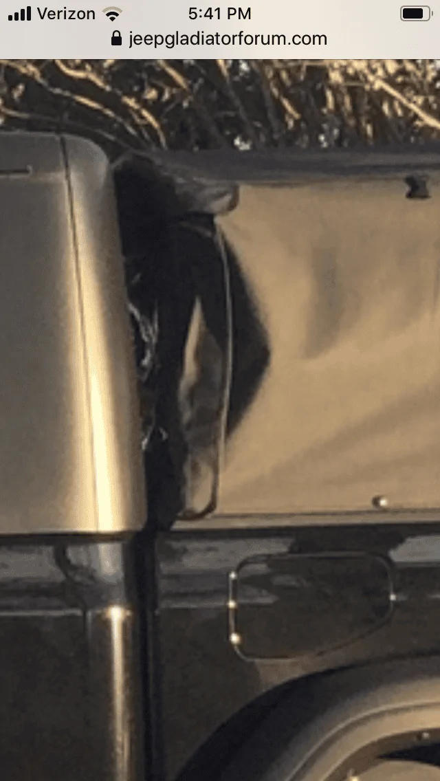

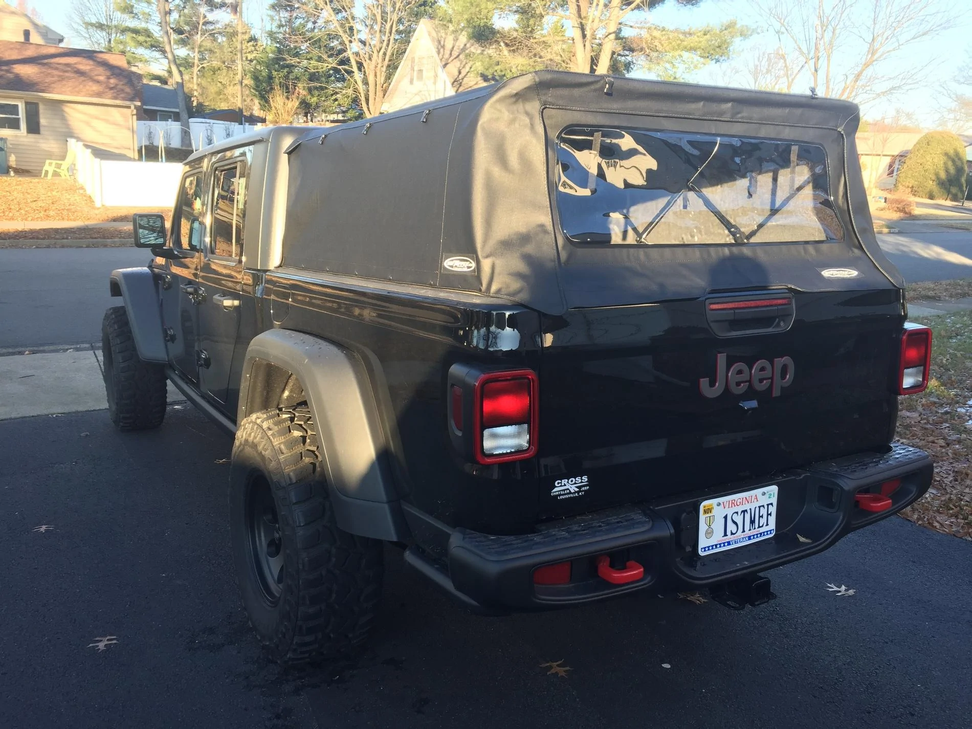

Something doesn’t look quite awesome at the corners. Is there a way to tighten the fit in these areas?

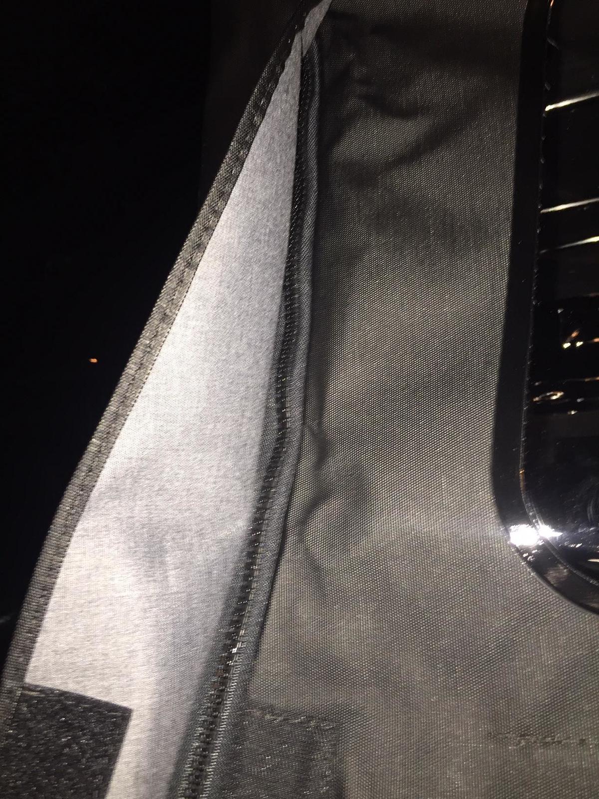

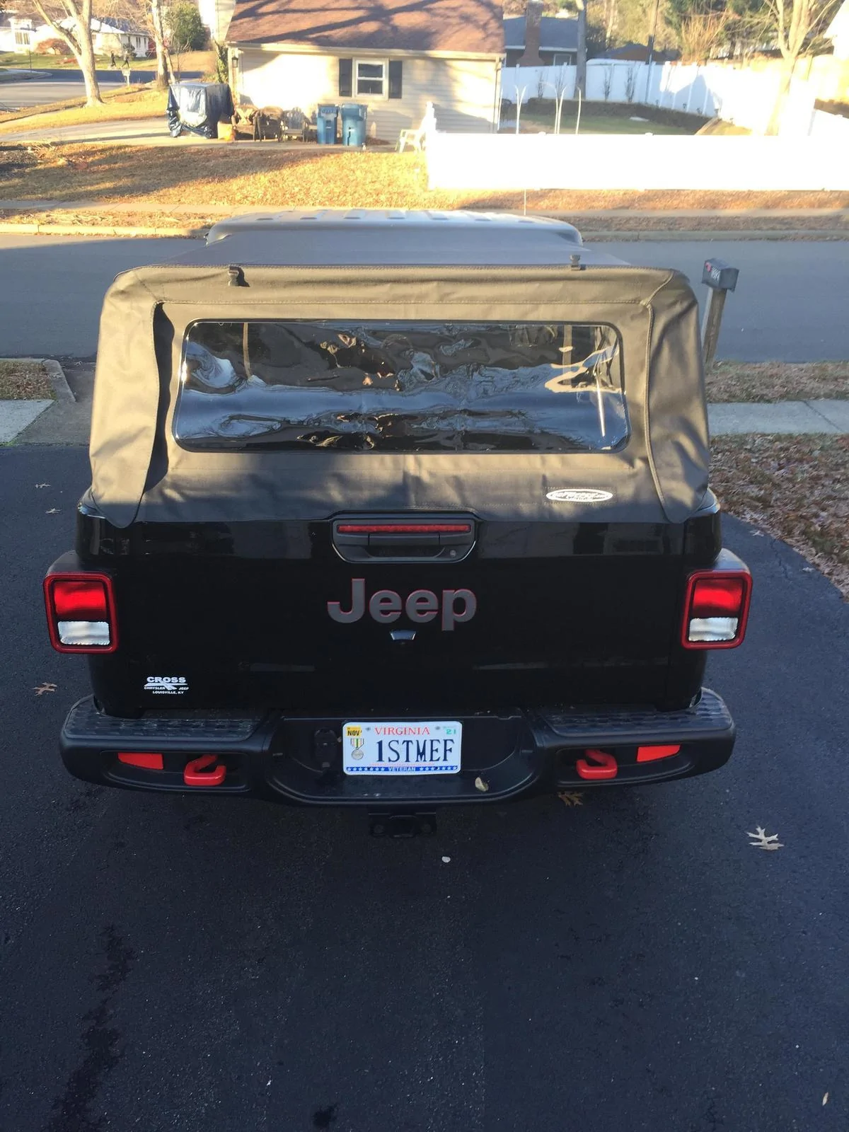

The rear pic is just the flap that velcros over the rear door zippers:
Jeep Gladiator Special Ops JTR (w/ SoftTopper installed) uNJPYcZ
It is as it should be.

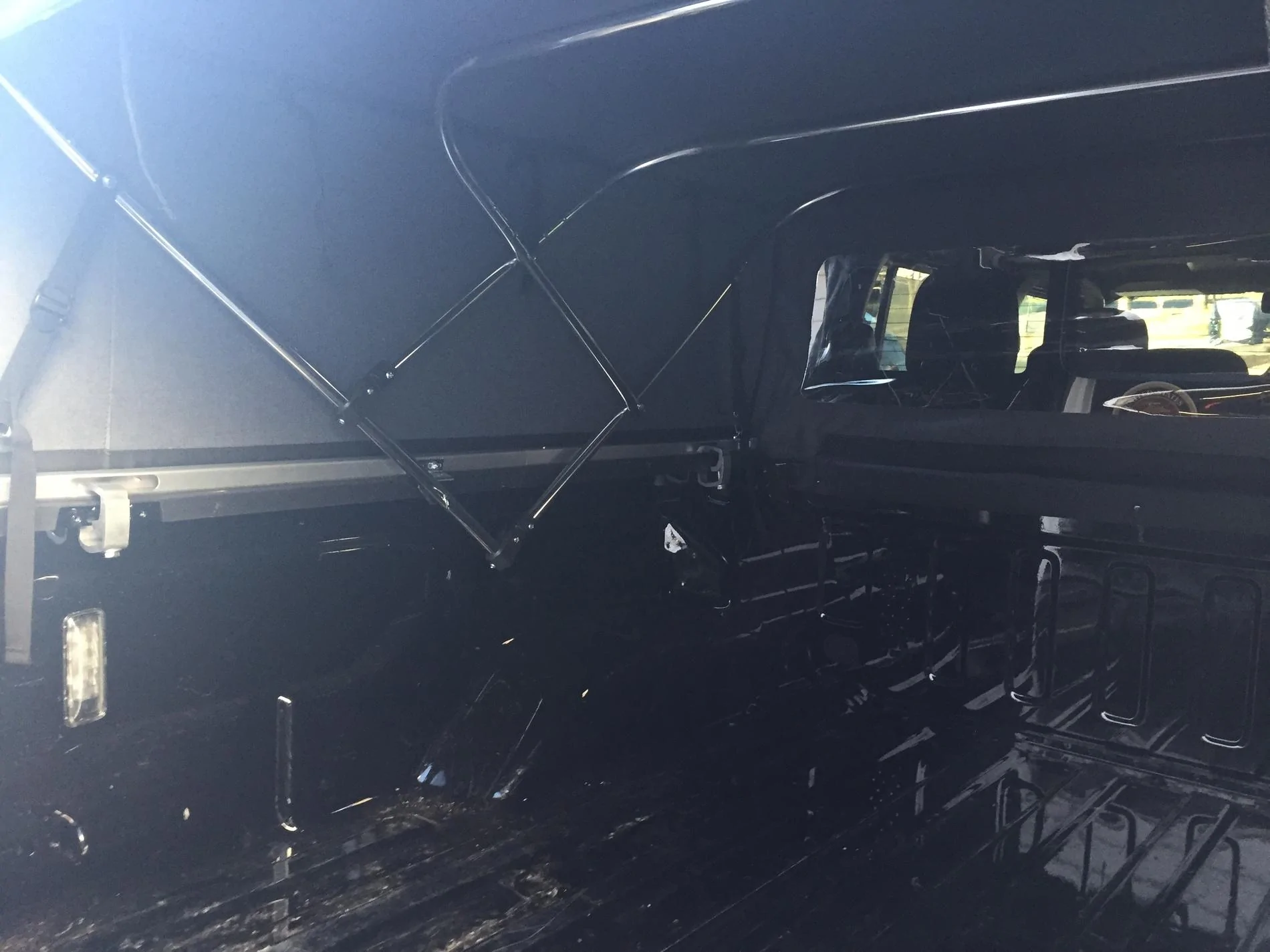

I loosened the inside strap on the front, which tightened it up a bit, but it's all cosmetic, as it is built like rock.

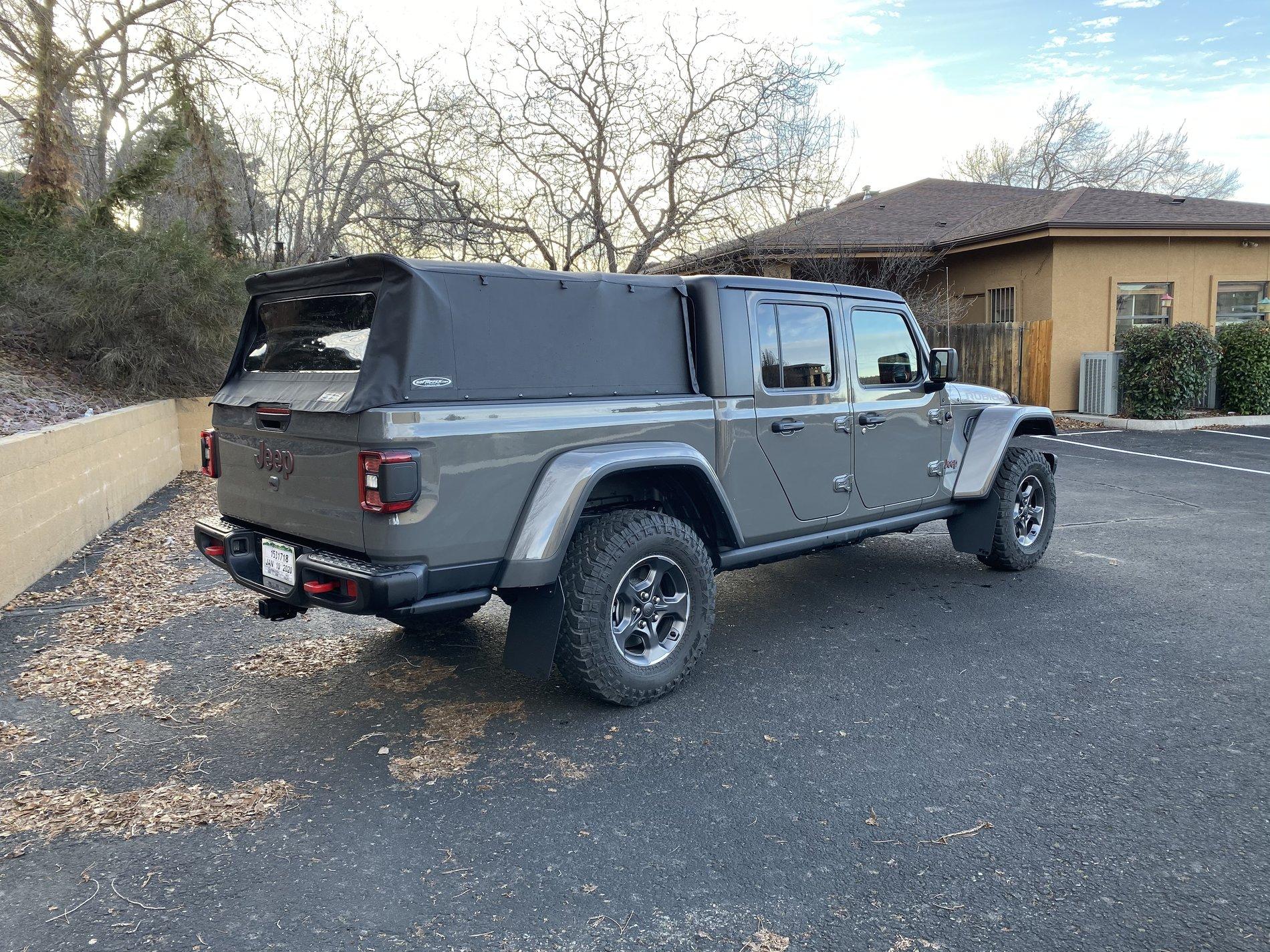

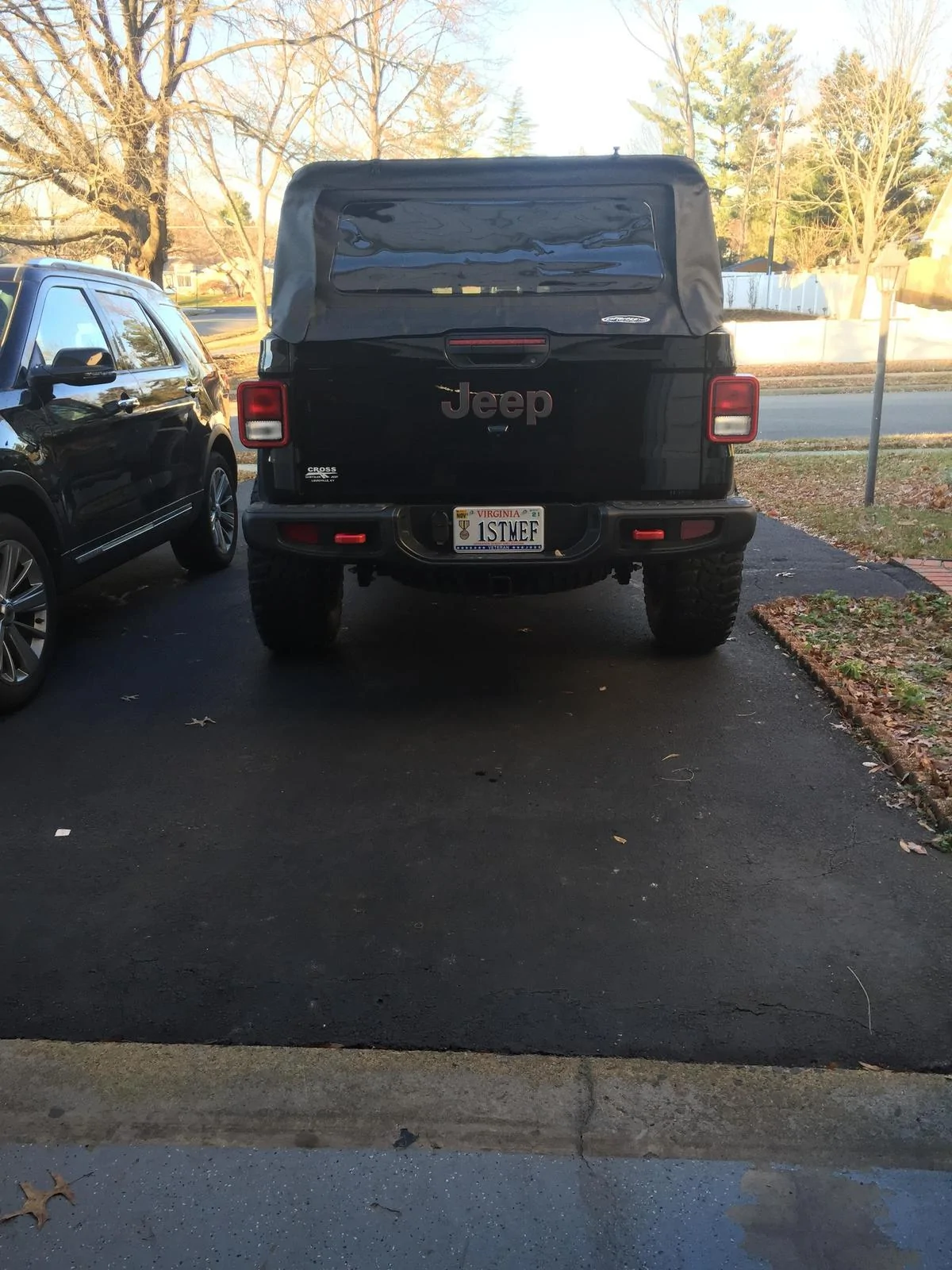

It isn’t adjusted properly. Here is how mine looks after I adjusted things to fit right
Jeep Gladiator Special Ops JTR (w/ SoftTopper installed) 3E84DDAB-FB45-4615-8F75-D8C90D205E9E
