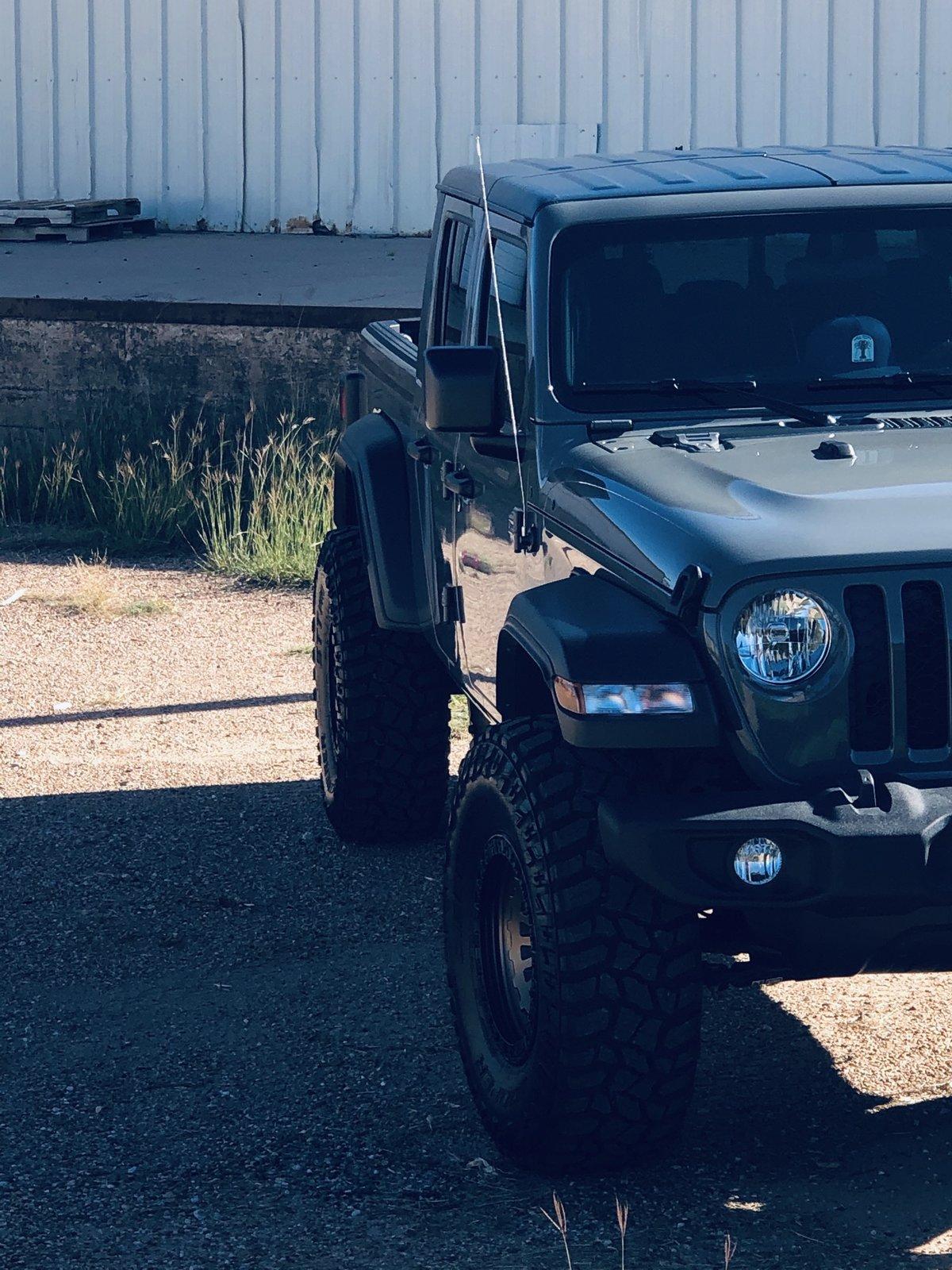

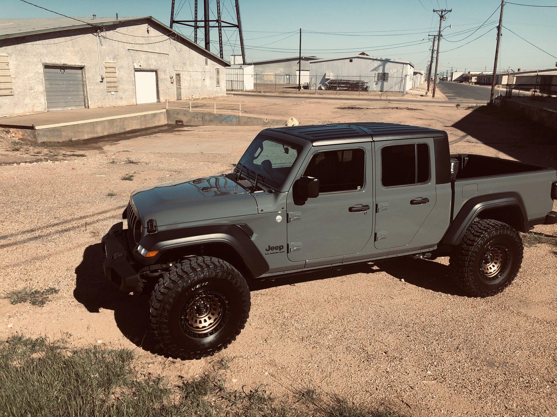

I’m moved on from the Mopar 2” lift after the issues I had. my dealership was honorable enough to replace the lift kit entirely after they did an incorrect install (of which I had pictures to prove). The Mechanic installed shocks upside down in the rear and installed the rear springs in front and vice Versa.
I got a new Mopar lift installed and it was great no sag same control HOWEVER, I decided to upgrade back in February. I had the Mopar lift removed with less than 3k miles, and had the RockKrawler Pro-X 3” lift installed. Its been great.
