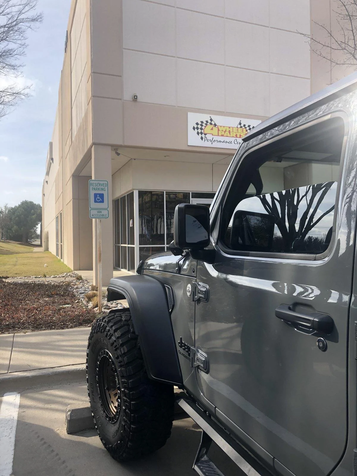

Moved a few hundred miles from home changed occupations built a house a few things as to why I have been unable to sit and do a write up.
But their are updates:
I’m moved on from the Mopar 2” lift after the issues I had. my dealership was honorable enough to replace the lift kit entirely after they did an incorrect install (of which I had pictures to prove). The Mechanic installed shocks upside down in the rear and installed the rear springs in front and vice Versa.
I got a new Mopar lift installed and it was great no sag same control HOWEVER, I decided to upgrade back in February. I had the Mopar lift removed with less than 3k miles, and had the RockKrawler Pro-X 3” lift installed. Its been great.
Also I purchased a few parts that were put on hold until recently:
Evo mid height bed rack-
2- 2gal rotopax gas containers mounted on rack
2- rear facing KC Hilites spotlights mounted to rack
On hand but yet to be installed:
Evo 1/4 Pounder front bumper
Evo 10s winch
Factor 55 fairlead
Factor 55 shackle mount
2- KC Hilites RZR driving lights
