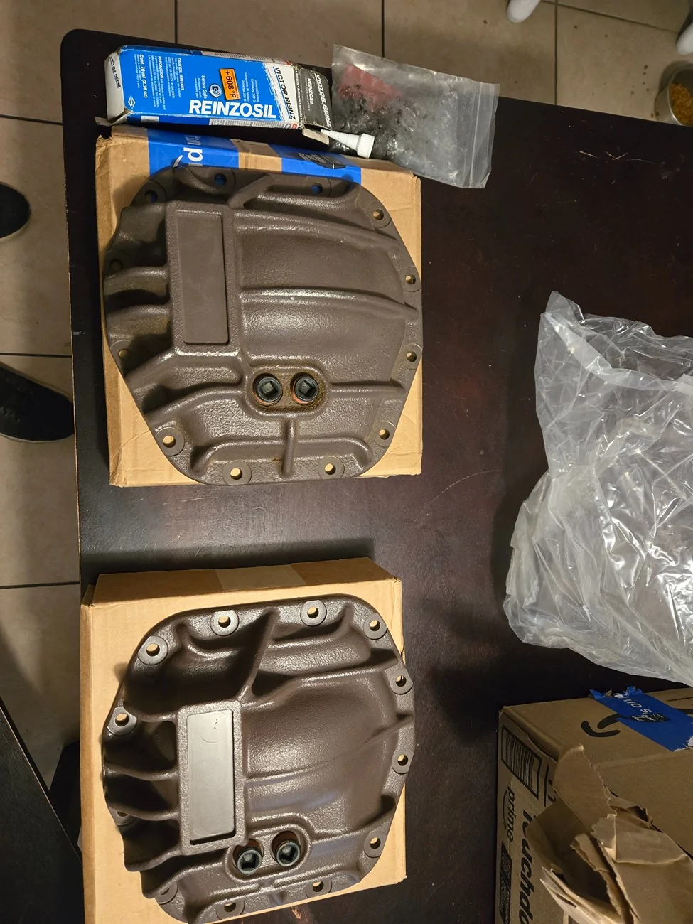

My diff covers came in. Got the primed Dana covers. The top one was from Amazon Warehouse as a 'used-mint conditon' return that I rolled the dice on for $67. Everything was there! A little dirty and worn from being shipped several times. The other one (bottom) was brand new on sale at Amazon ($110). So $180 in on two solid diff covers that I plan to paint black. I can deal with that.

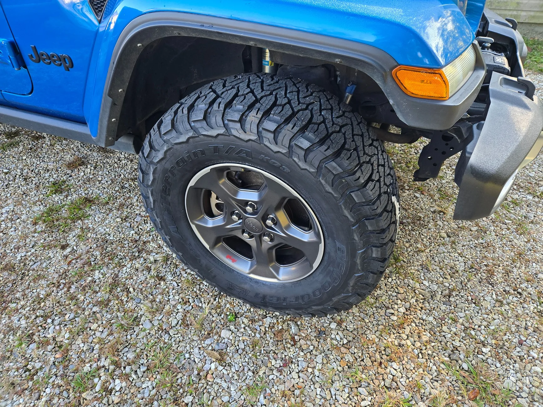

Old Falkens had gotten pretty noisey. Replaced them with BFG KO3s. Same size (285/70R17).
Initial observations - very quiet seeing as they are new, ride is a touch softer as they are lighter and not quite as heavy duty construction as the AT3W's.
