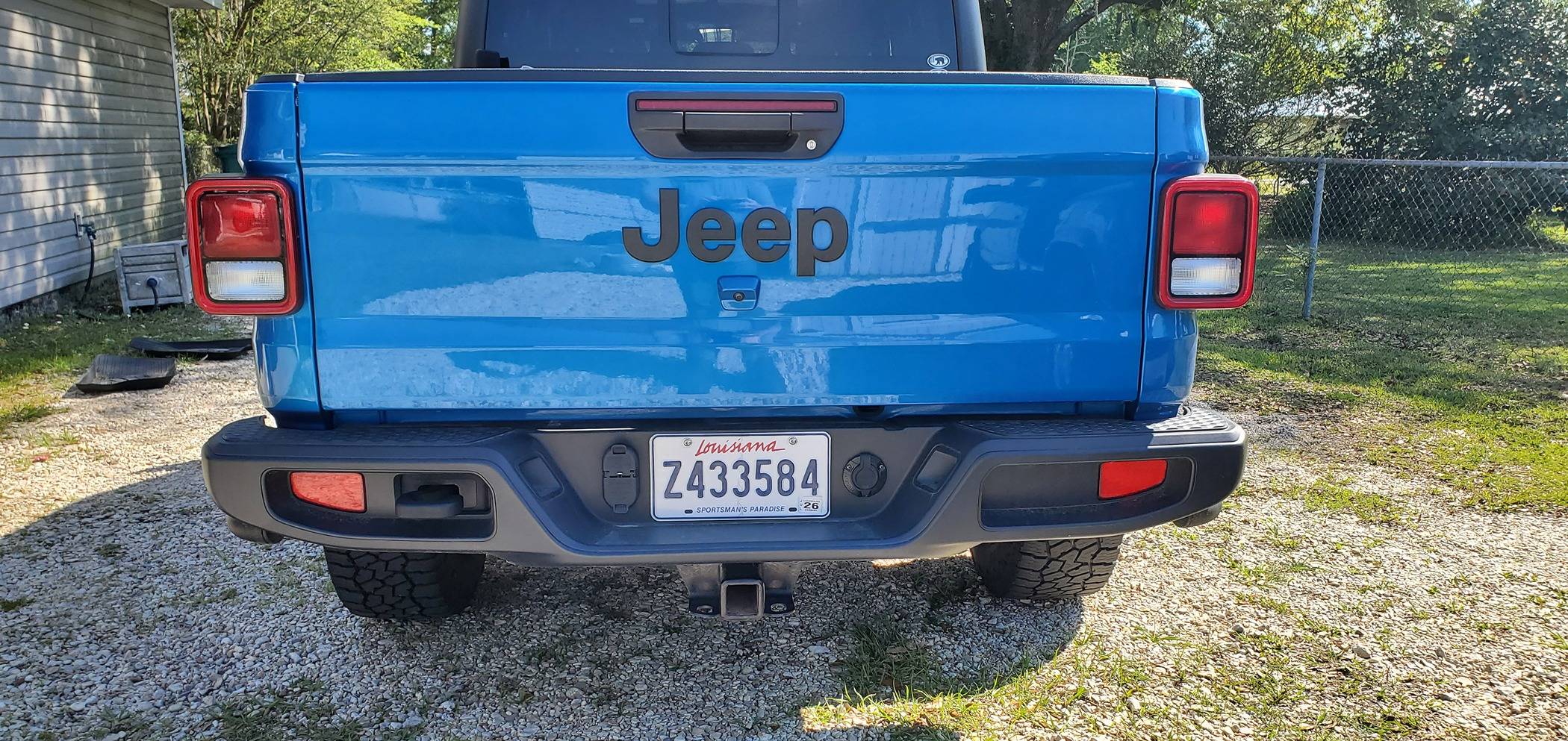

I installed the Noco inlet in the rear bumper, and the outlet into the plastic filler panel on the passenger side of the bed (where the factory 120V / 400W outlet would be) and connected the two together. Now, my APL55 can be plugged into the inside of the bed and when my truck is at home I can plug an extension cord into the inlet and override the 12V. This way, the fridge won't be needlessly taxing my battery when it doesn't need to. Also, this gives me an easy way to add a trickle charger or other feature to the truck later.

Here is the 12V receptacle and 120V receptacle installed. If you use the ARB kit in a Gladiator, be warned - it is barely long enough for these trucks if going to the rear of the bed. I followed the harness along the passenger frame rail and over the rear axle and was left with less than a foot of cable to pull through the bed wall. If you take additional short cuts, you'll have more length.
I used this cable kit because the ARB fridge cable screws into the outlet and cannot shake loose.

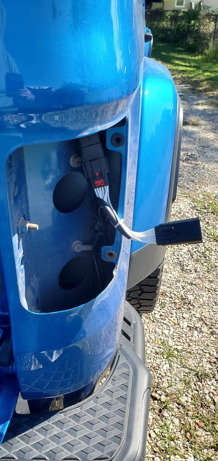

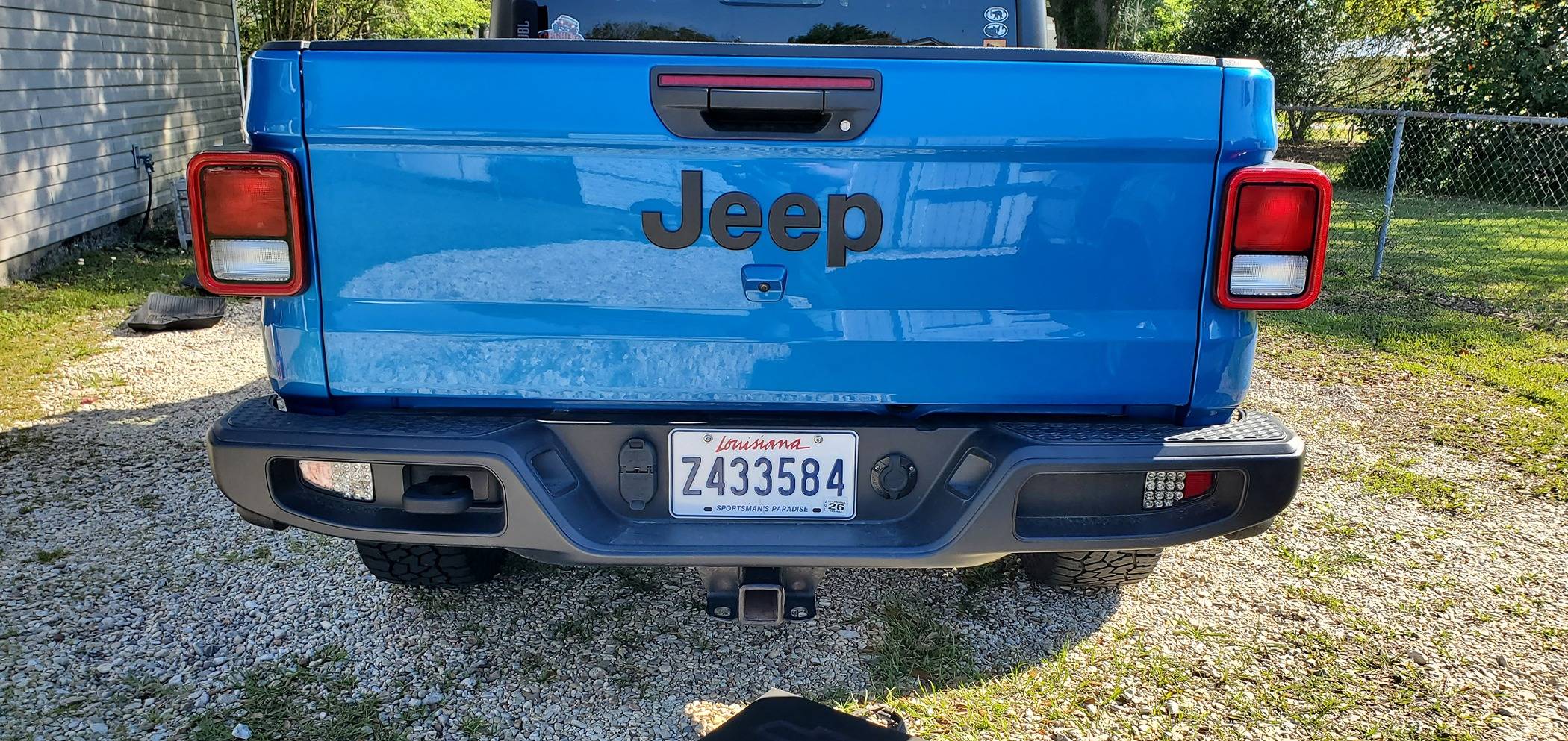

Installed Oracle bumper lights yesterday. Much better visibility at night now. This is the beginning of some lighting mods I have planned to do for a while.
Sold the rack, rack case, awning and awning tent recently. I enjoyed it but truthfully just won't get used by me enough to warrant it all sitting around.
Nice! That adds an impressive amount of light. I've had those sitting in the box waiting to be installed for a while now. I need to get around to it.
Those lights are extremely bright!! And they look good in your rig! Would you mind writing a review on our website for these?

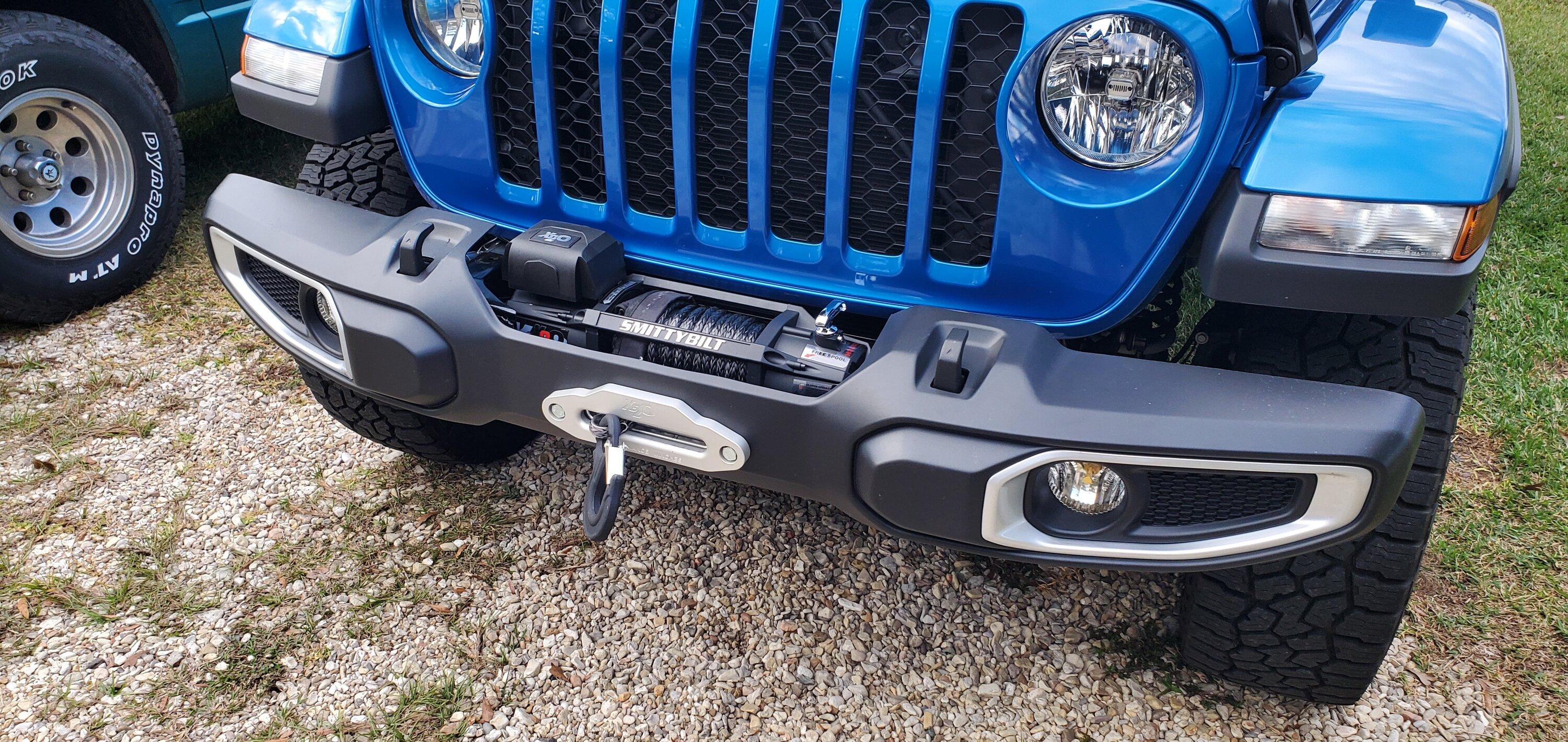

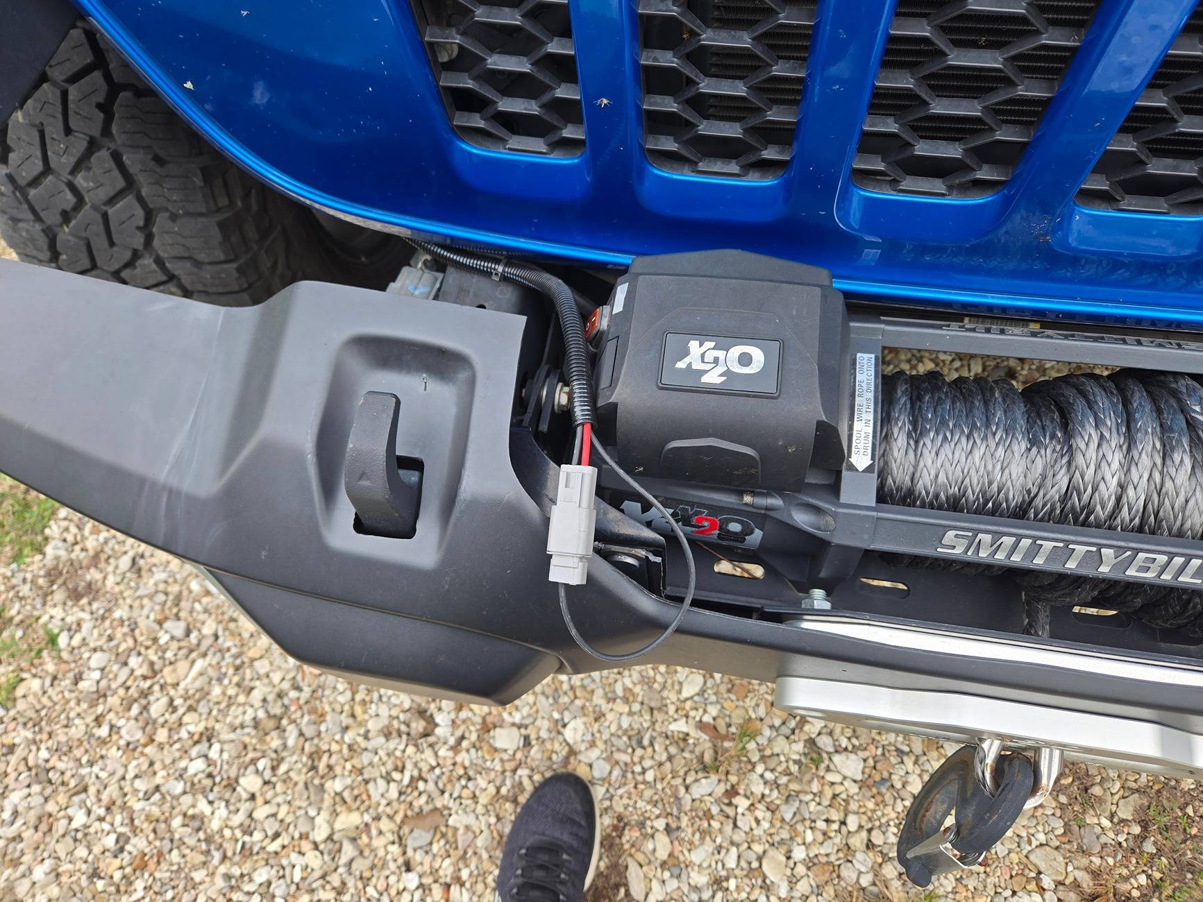

So - I crammed a Smittybilt Gen 2 X20 Winch into the stock front bumper. Used an LOD Signature winch plate, a Harbor Freight fairlead mount, a couple cheap aluminum fairleads from Amazon to act as spacers, and a lot of cutting and fitting. Love the result.
Read more about it here.
That gorgeous man! looks factory AF. If i didn't need a stubby I'd totally try to do that for my Mojave.
Thanks. I'm a big fan. This doesn't get wheeled the way my old JK did so being small or extra tough wasn't an issue. I like the OEM look, it saved a little weight, was a fun project, and it gets attention.

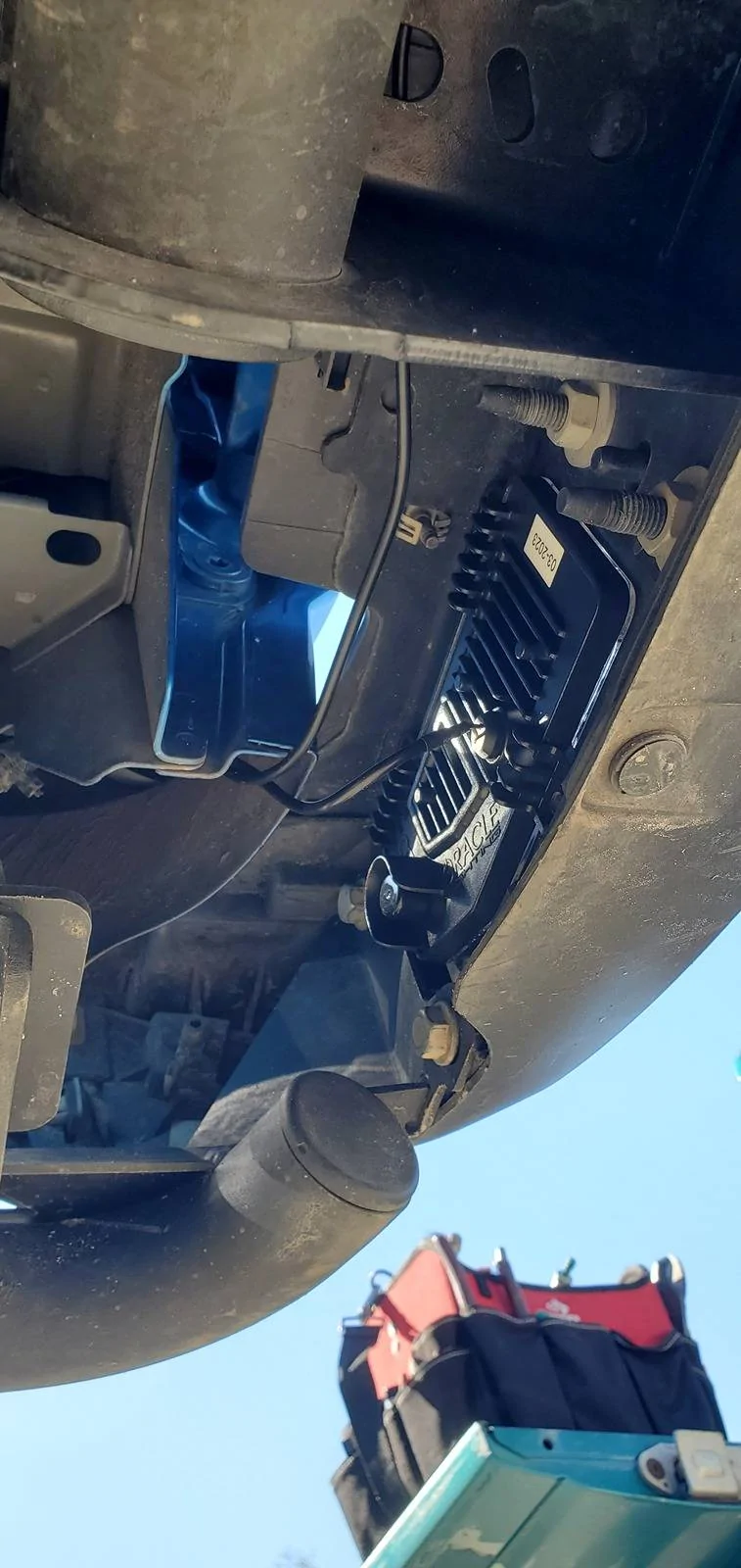

Last weekend I modified my Viair compressor to be more friendly to use. Previously I would need to pop the hood to connect the alligator clips and air up my tires. I have been doing that more frequently because two tires have slow leaks that I am procrastinating on fixing :LOL:
Regardless, this is still more streamlined.
Note: Would have posted more pictures, but my computer is being beyond ridiculous. May post more from my phone later when I don't feel like chucking the laptop out the window.
Added some 12G wiring and a Deutsch connector at the front bumper to plug the compressor in. I also cut the wiring on the compressor and added the mating connector to it - so for other vehicles / applications I can still attach the alligator clips but for the Jeep I can just plug the compressor into this connector and forgo lifting the hood, etc.
Connector has a mating plug with seals in it so that when not in use it's protected from the elements. The mating plug has a retaining wire inserted on the ground side that goes back under the loom and is heat shrunk alongside the other wires to hold it in place.
When connector isn't in use it tucks nicely under the plastic out of sight.

Love the Smitty winches. I've had two, including the one on my JL, which is 6 years old and has made many pulls, with not so much as a hiccup.
