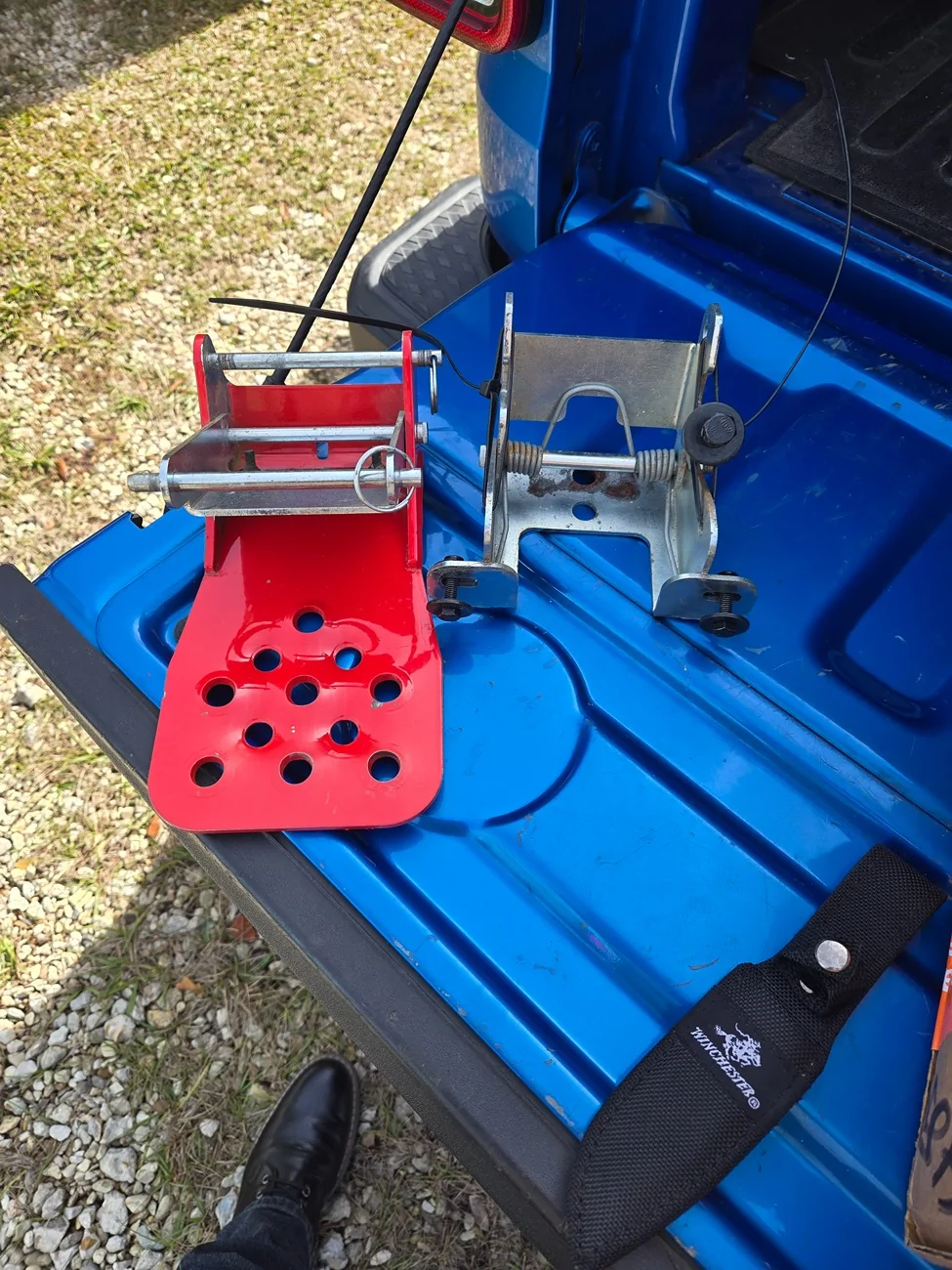

I grabbed this MORE folding step from another forum member.
I have a couple short women in my life and so far, they approve! I may still get an entirely different solution to accommodate the kids getting in the back seat, but this works great for now.
I didnt love the red in thought, but in practice I like that it makes the step easy to find in low light and push down.

Is that easily removable for off-roading?
Yep. If you look closely in the picture where the step is on my tailgate, on the step at left you will see two pins with keyrings on them. You pull those two pins and the step comes off of its bracket and you can put it away, and then the rock rail is unobstructed.

So far my mom and my fiance have used it several times and it works well enough for getting in. I just remind them to make sure they get a good bite on it before climbing up. You just hook the tip of the step with your toe and push it down, then slide your foot forward and climb up.

The holes are stamped upwards so it makes the step surface embossed and has good traction.

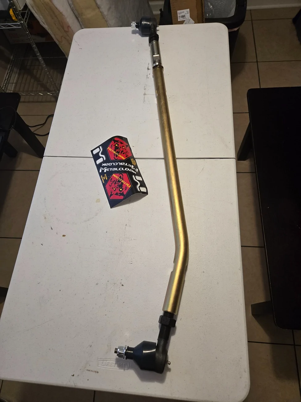

My drag link is clunking slightly and has led to light moments of death wobble.
So, no point putting stock parts in for the same cost.

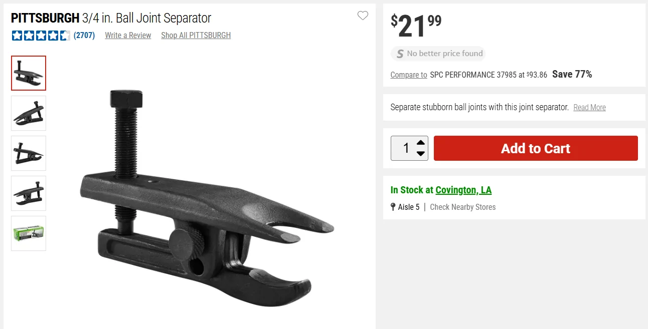

Ah yes. Drag link. So I eventually got the MC drag link installed and that cured the truck of death wobble, so it's been business as usual since. It was a lot easier with this ball joint separator tool. I used this to put some pressure on the end at the pitman arm then a couple taps with a 3 pound hammer knocked it right off.

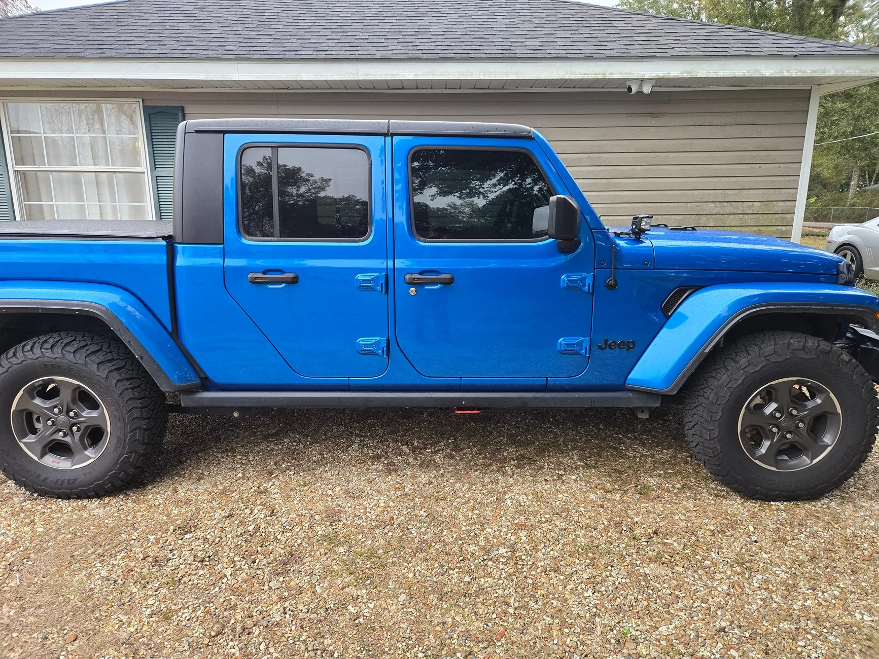

I finally saw a set of factory running boards come up for sale locally, so I removed the flip down step and put these on. All the short people in my life approve.
My rock rails are in storage - if I ever do a wheeling type trip I'll just swap them out. Only takes a few minutes - no big deal.

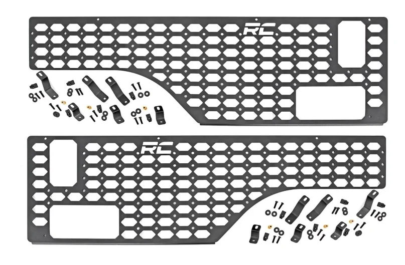

Next up, I have some bed molle panels coming in. I was running a toolbox in the bed but it took up so much space, so I reorganized some things into the cab and the remaining items I hope to put along the bed sides. My small shovel, hatchet, strap, etc. Right now I'm back to having all five feet of my bed free and it's been so handy lately.
I really wanted to go with an American designed/manufactured item like the ones 813 Fabrication makes as I like the design more, but I was looking at $210 shipped vs around $500 shipped. I could not stomach that, but if you can go check his stuff out. Looks nice.
My father in law has those on his Wrangler. They might not be the best looking, but the function good as a step.
I've looked at those molle panels, for the price, I'd go with them. Can't wait to hear your review.
