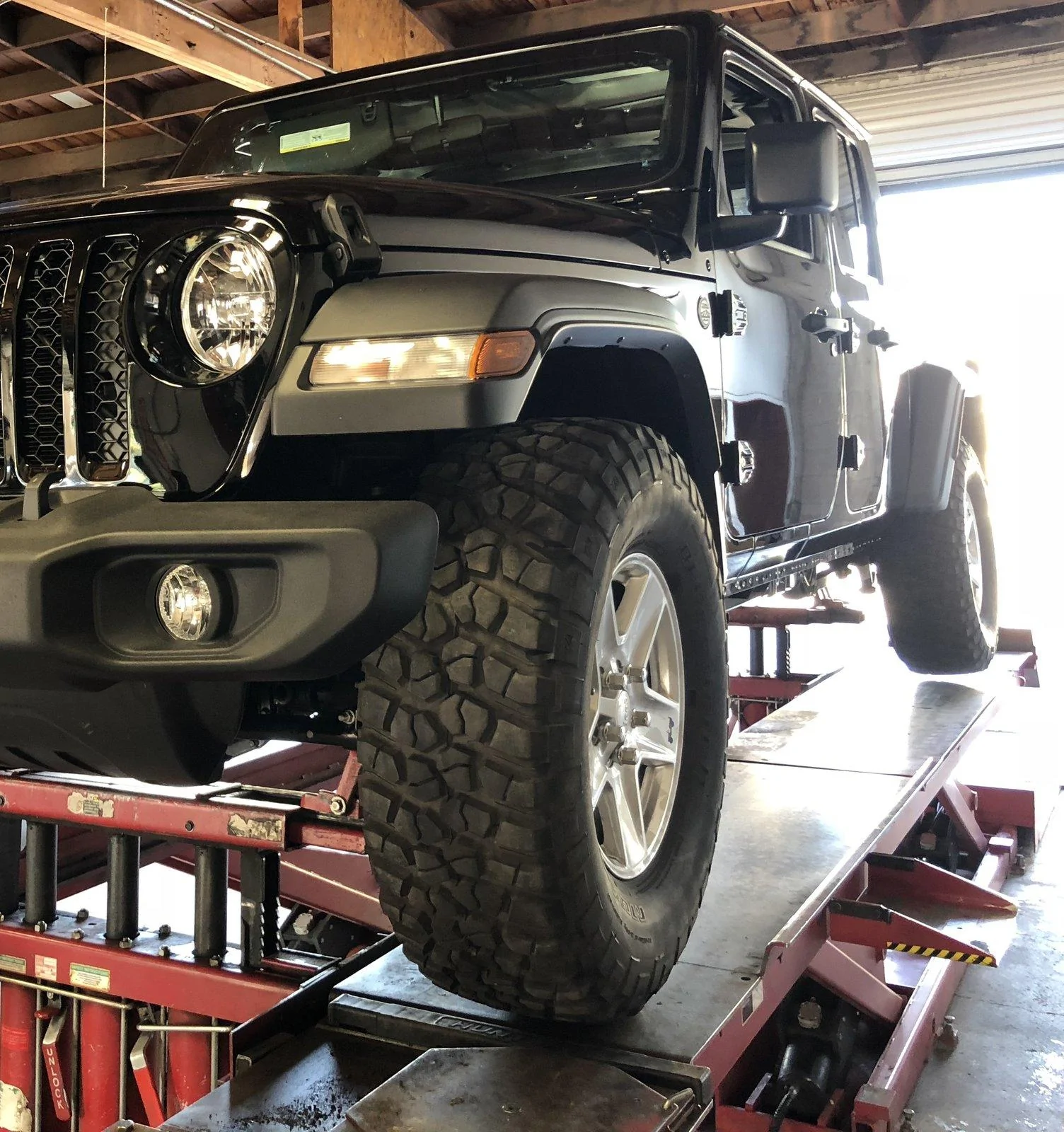

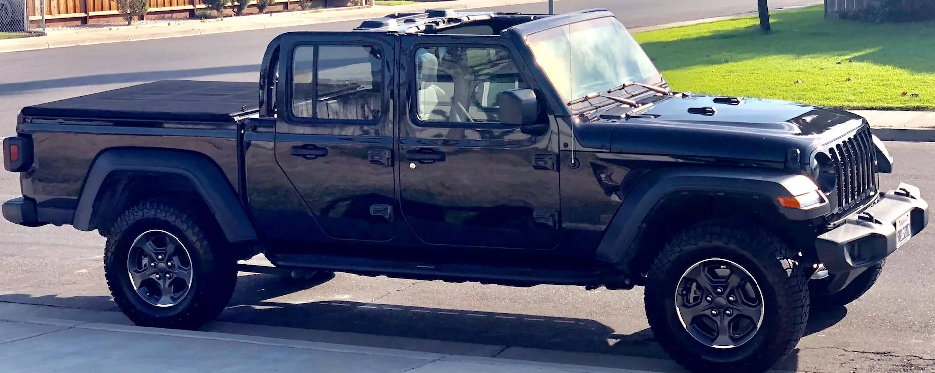

Looks great. I'm getting a white sport s w/max tow. I'm thinking of upgrading to 33s on the stock wheels.
Thanks! I alternate between 35’” MTs for the trail and 33” ATs for towing and daily driving

Max tow fenders, 35x12.50 on stock wheels fit under them nicely
Are you running spacers are anything? Lift? I want to run 295/70/17 which are 34x12. But I want to do it on stock rims on max tow with a leveling kit, if anything.
35” tires will fit without a lift or leveling kit but you will need to remove the air dams. I eventually did leveling coil spacers but not required unless you want to avoid rubbing while fully flexing with front front sway bars disconnected.
