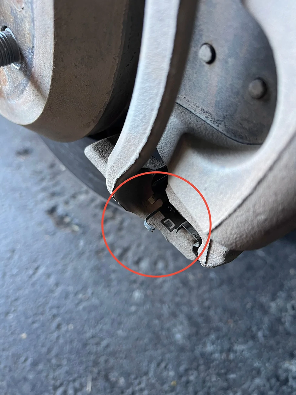

happy to report that replacing the brake pads and clips fixed the squeak on my Sport S. I also had the broken clips and it squeaked pretty much any time I was driving slower than 25mph
Jeep Gladiator Squeaking Noise at Low Speed ?? IMG_9522
I replaced them with this Power Stop pad and clip set and haven't heard the squeak since, and it's been over a week.
I replaced them with this Power Stop pad and clip set and haven't heard the lsqueak since, and it's been over a week.
BTW, if you ever need just the clips, Mopar has them here:
Disc Brake Hardware Kit - bproauto (1BP02085AA)
https://parts.allmoparparts.com/oem-parts/bproauto-disc-brake-hardware-kit-1bp02085aa
