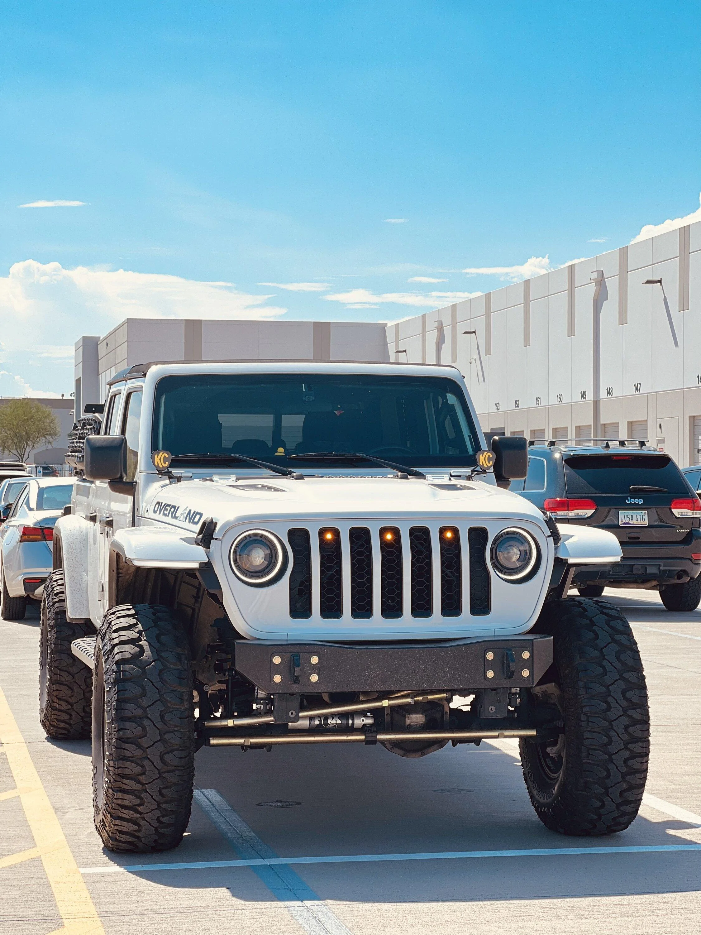

I have a Mojave with AEV 2" lift and 37's. I already have the FOX ATS steering stabilizer installed and want to upgrade the tie rod, drag link and track bar. What brands can I use that will not have clearance issues with the ATS? Or will all brands have the correct brackets for mounting it? Looking at Steersmarts and RPM but open to others. Any help would be most appreciated.

I have all the steer smart stuff on my JLUR and they have worked great but on the Mojave I just installed 2.5 ton Aluminum Apex Chassis stuff and I also run the ATS without any issues.
I believe I seen somewhere that RPM uses Apex’s tie rod ends on their stuff.

Thanks. Do you think there would be any issues using the Steersmarts track bar with the Apex/RPM components? Sorry I'm a Jeep noob.

It’s hard to say for certain because I don’t run that combo but biggest concern is that the steersmart track bar has big clamps and bolts that you will have to shift around to clear everything. So if you do decide to go that route just keep that in mind

I'm running the AEV 2" lift as well with Fox stabilizer. Been using the Metalcloak steering upgrade along with trackbar for over 10k with no issues. I did not however use the Metalcloak bracket for the stabilizer because it puts it at an angle. I went with the Synergy stabilizer bracket and keeps it parallel with the tie rod.
