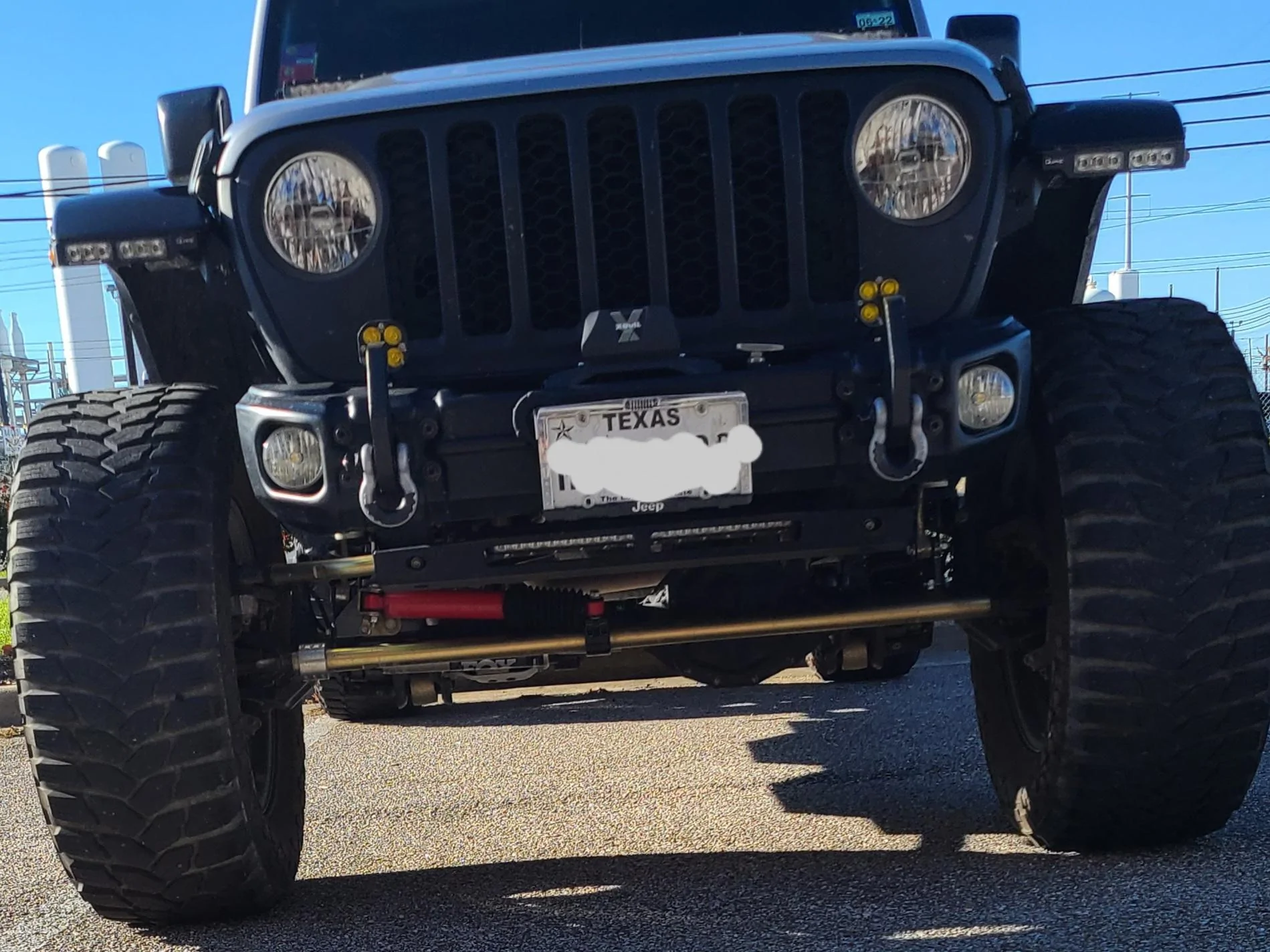

I'm looking at RPM as well. I am wondering if anyone has tried Synergy's Front Track Bar Relocation Bracket???? I have an adjustable track bar but they "claim" their bracket changes or flattens the geometry making it steer better and better suspension travel.

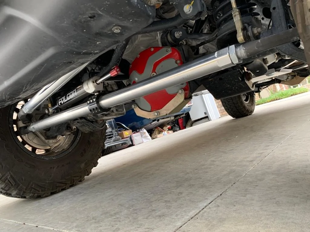

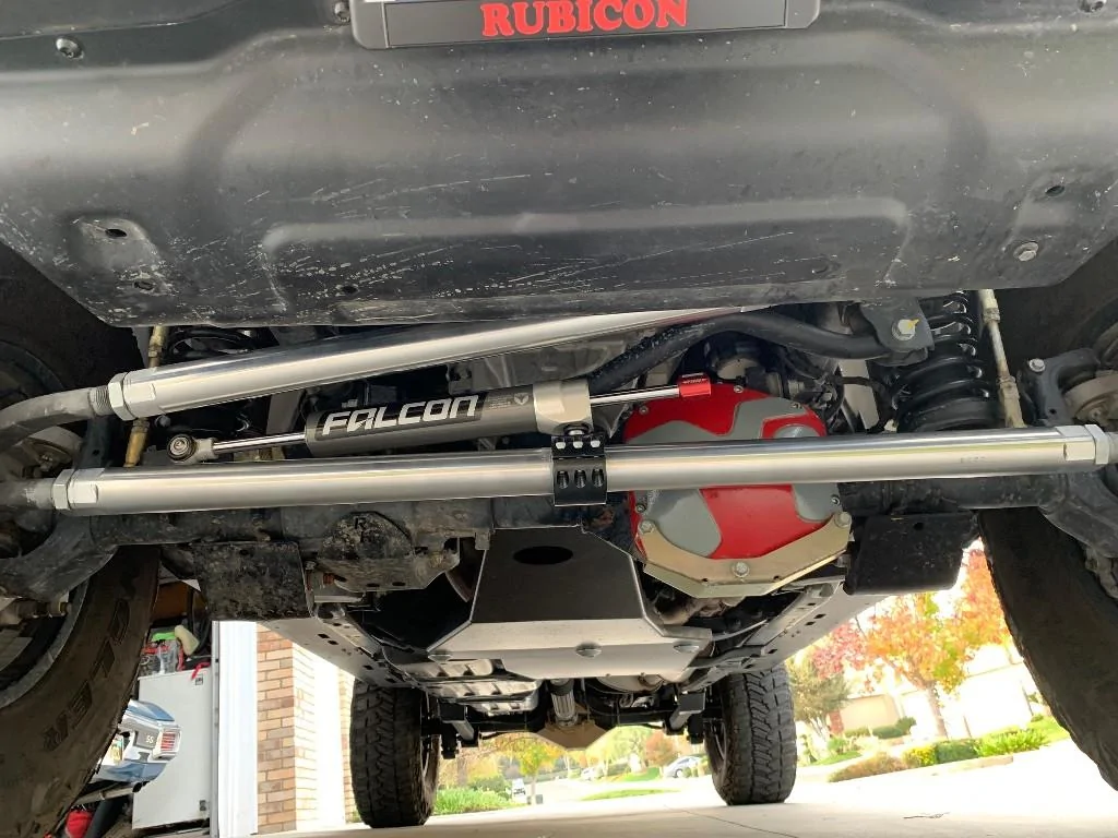

I just ordered the RPMSteering 2.5 ton Aluminum Steering set. The tie rod and drag link with the Falcon steering dampener clamp. They seem to have pretty fast turn around right now. There is an active, big discount promo code right now, search google for "RPMSteering Promo code". It should come right up. I will update when I complete the installation.

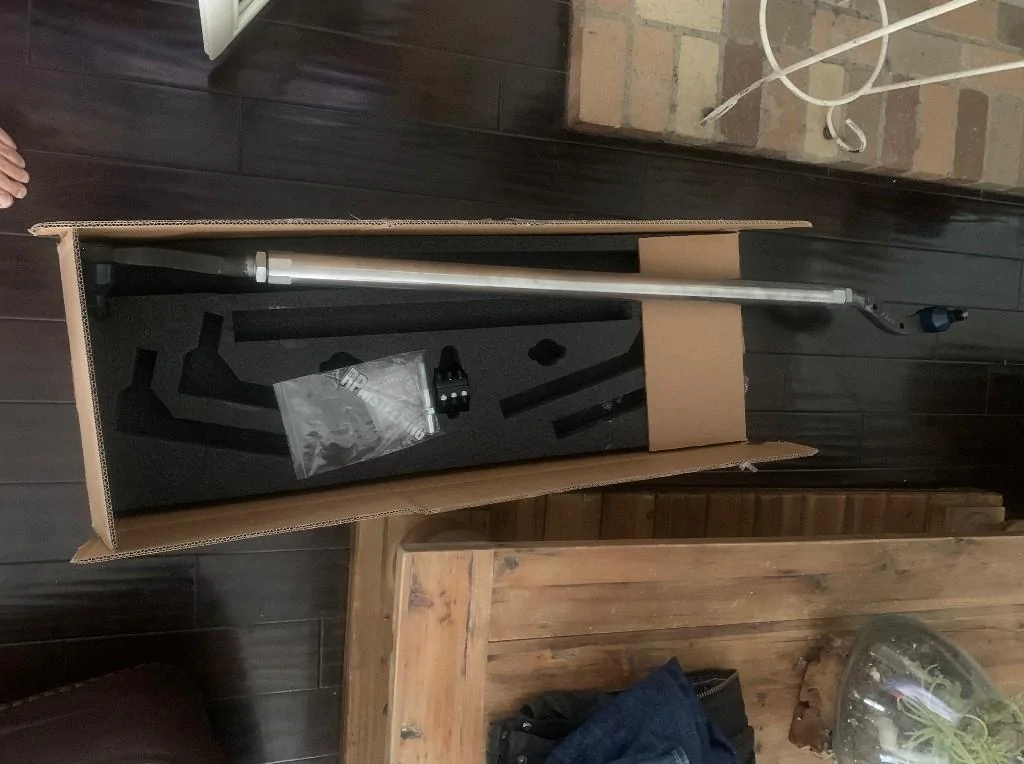

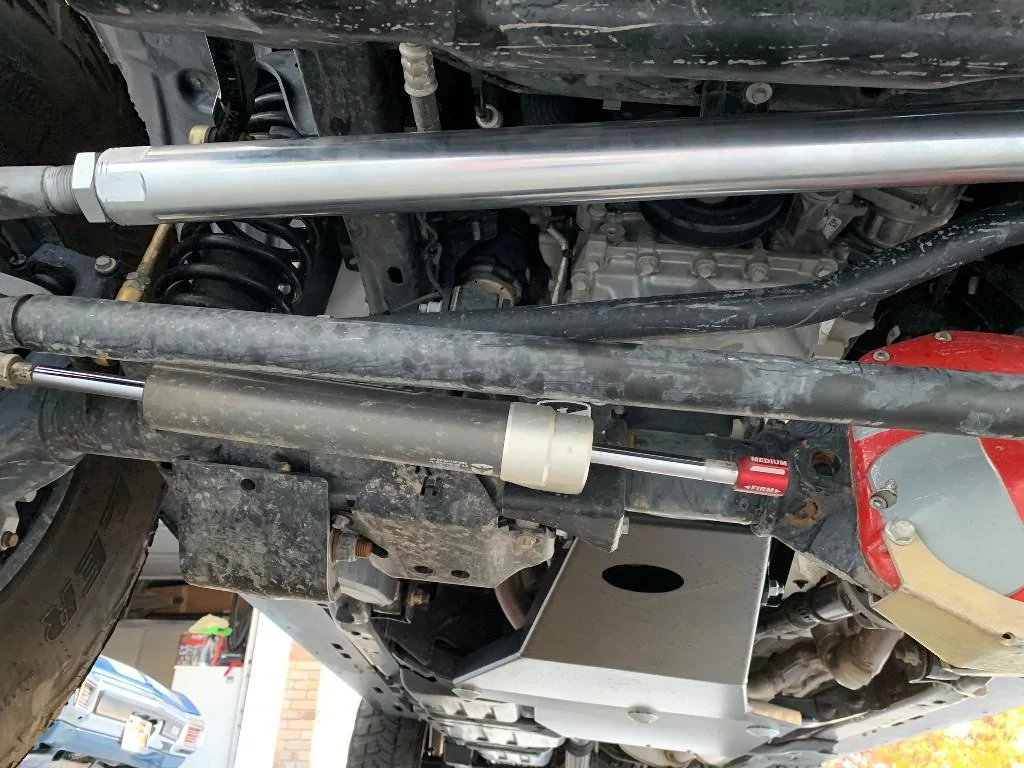

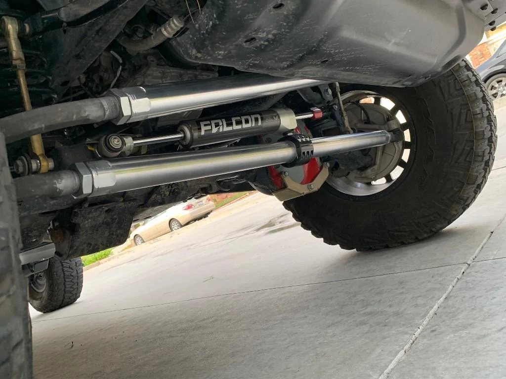

I received very quickly the RPM Steering 2.5 ton drag link, tie rod, Falcon Steering Dampener bracket, and Synergy steering dampener relocation bolt - puts steering dampener on the track bar bolt.
The RPM steering kit is very high quality. All ends screw in easily and the passenger side joints have been updated from the old videos you see to be "anti-flop". So, there is no changing of boots and adding anti-flop bushings anymore. Tightening up the locking screws is easy. You start on the passenger side, which has the anti-flop, and finish on the drivers side.

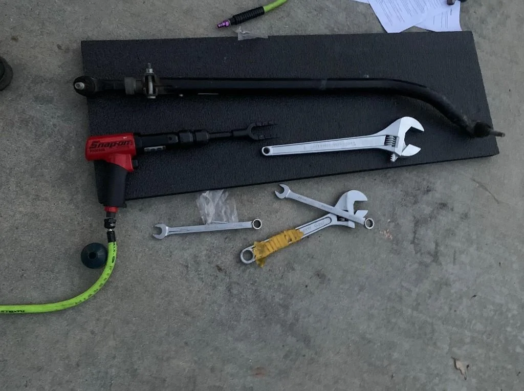

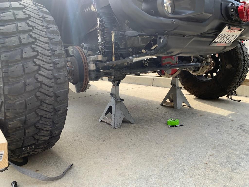

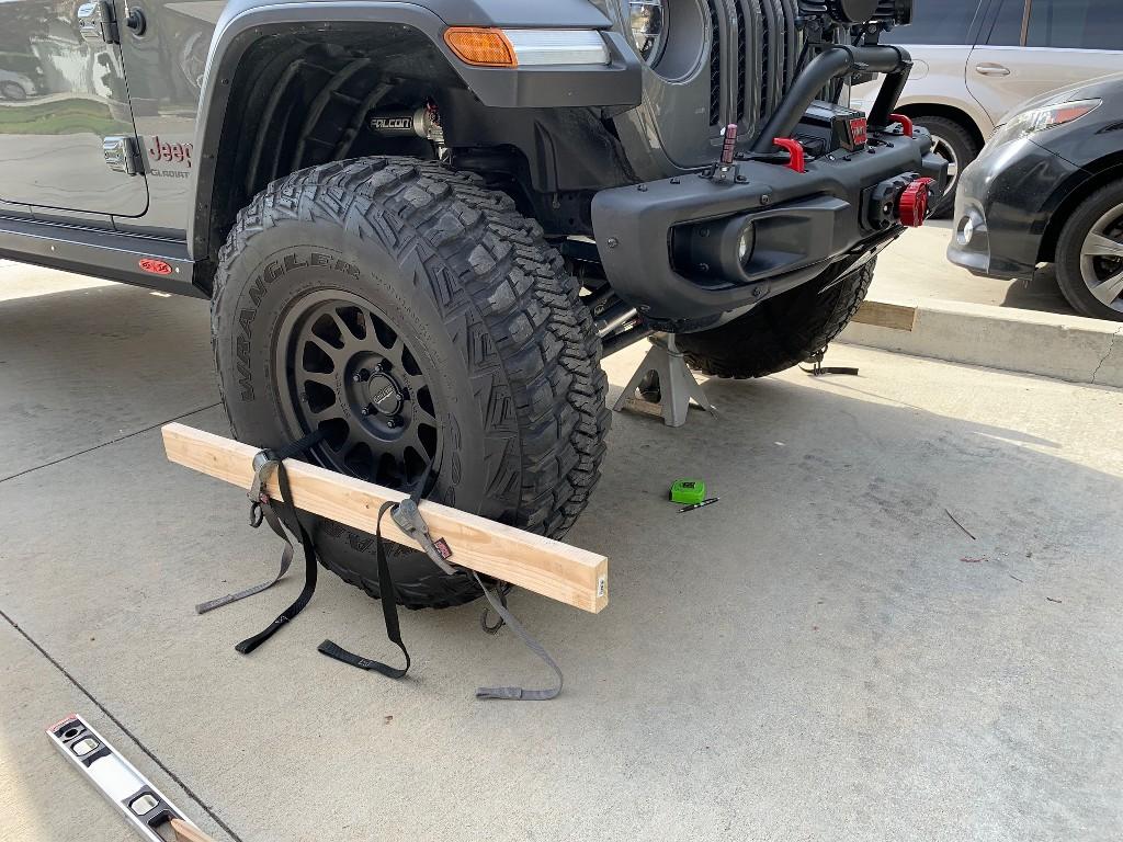

I installed the drag link first, and used a power hammer with a stepped fork to separate the old drag link. Then, I adjusted the drag link such that the steering was perfectly straight on the fwy.
Jeep Gladiator Steering parts upgrade PnY6oS
Jeep Gladiator Steering parts upgrade 5sYMLs
Then, I strapped very tightly straight 2x4s to the tires and measured front and back. I got 1/16" toe in. Then, I carefully removed the tires without disturbing the wood and just moved them away from the rotors. I removed the old tie rod nuts and the tie rod slipped right out. I removed the Falcon steering dampener and changed the mounts. I had to heat up the Falcon bracket with a torch to get the bolt off. I also added the synergy track bolt mount for the steering dampener.
I measured the old tie rod length and adjusted the RPM tie rod to the same length.
I installed the tie rod, mounted the tires, and the toe in was way off. The tires were way "toe out". It was easy to tell because the steering wheel was now way off. I measured again the toe in with the wood 4x4s and I had to shorten the tie rod considerably to get the 1/16" toe in again. Once I fixed that, the steering wheel was straight again. So, the lesson is, do not rely on measuring the old tie rod for the toe in, that will not work. I also recommend that you do the drag link first (no need to take off the tires) and fixt the steering wheel such that it is perfectly straight on the fwy. This will greatly help you understand where you are with toe-in when you do the tie rod.

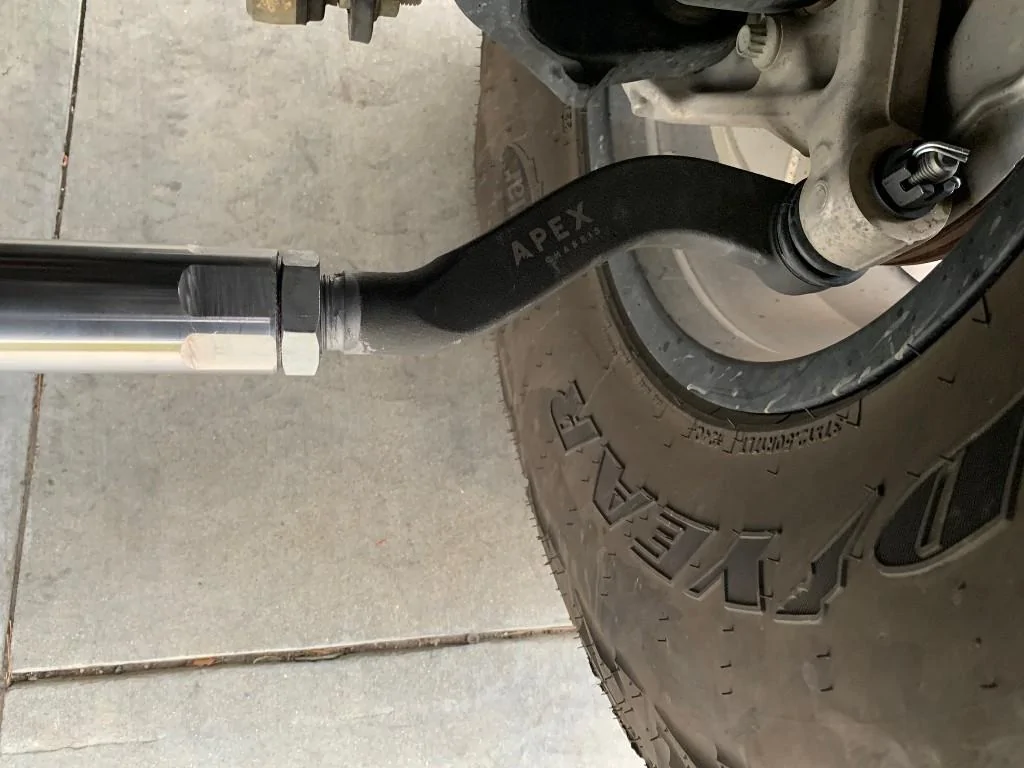

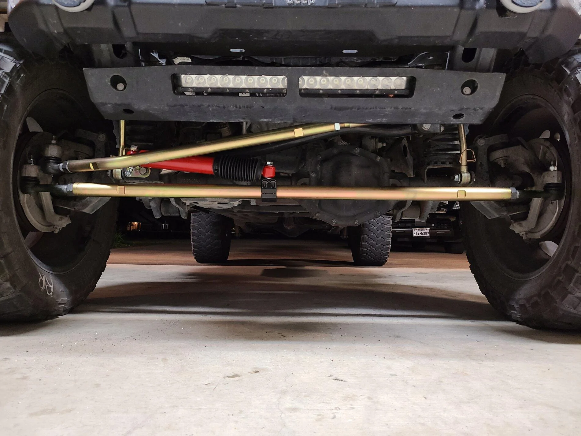

It really is a great high quality kit. The bars are impressive and the ends have been updated to be black and square and say APEX Chassis on them. Here are the installation pics.

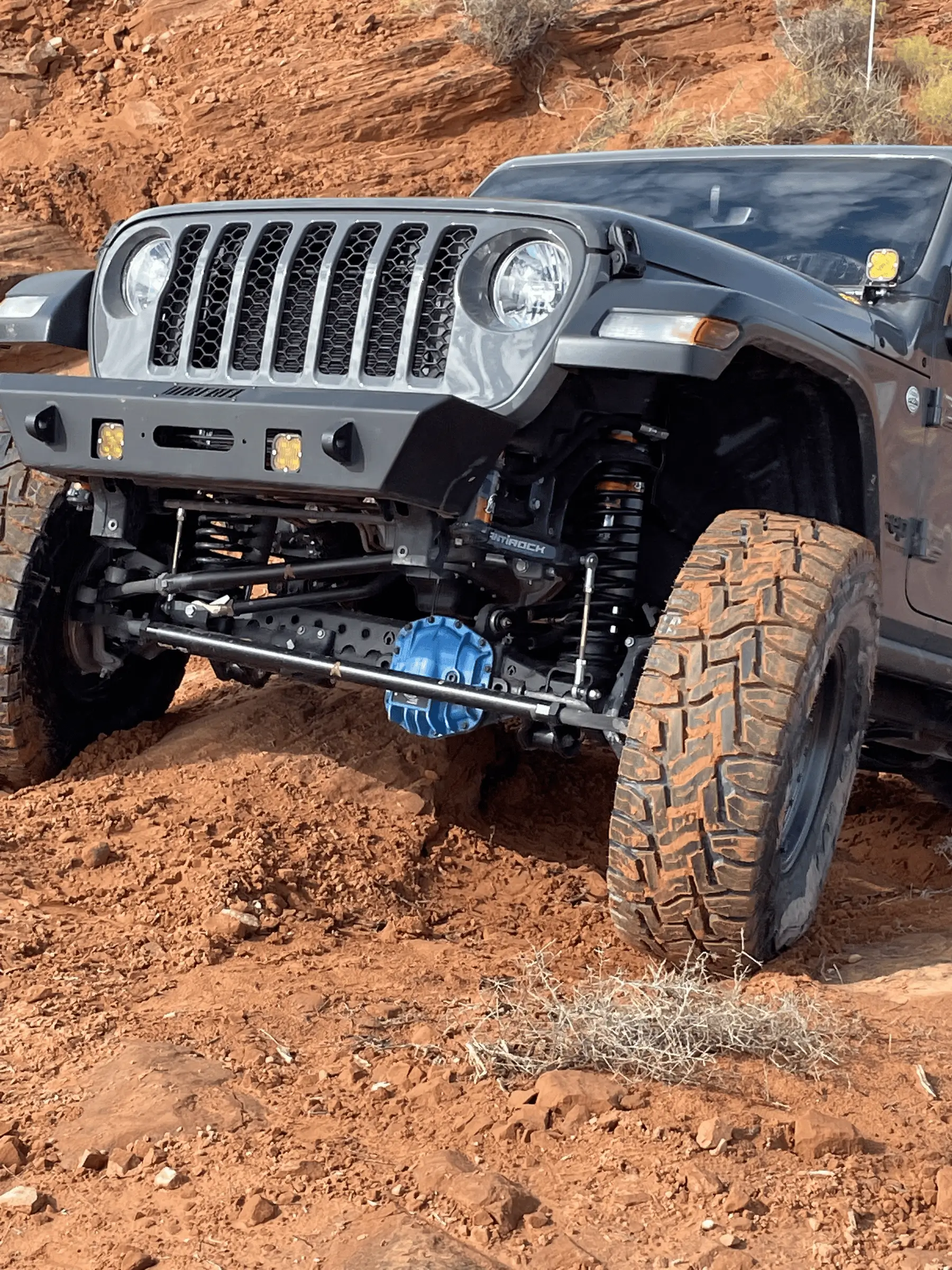

Apex Chassis makes the TRE's that come with the RPM kit, and they also sell their own kits. Apex offers anodized black aluminum and steel options too. I went with Steel because I didn't want polished and they are less expensive. Both Apex and RPM are great companies with great customer service.
