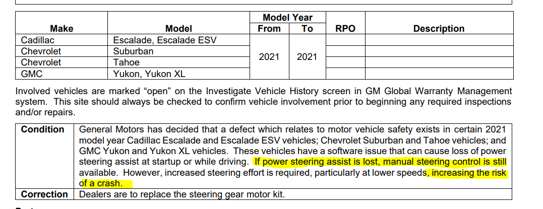

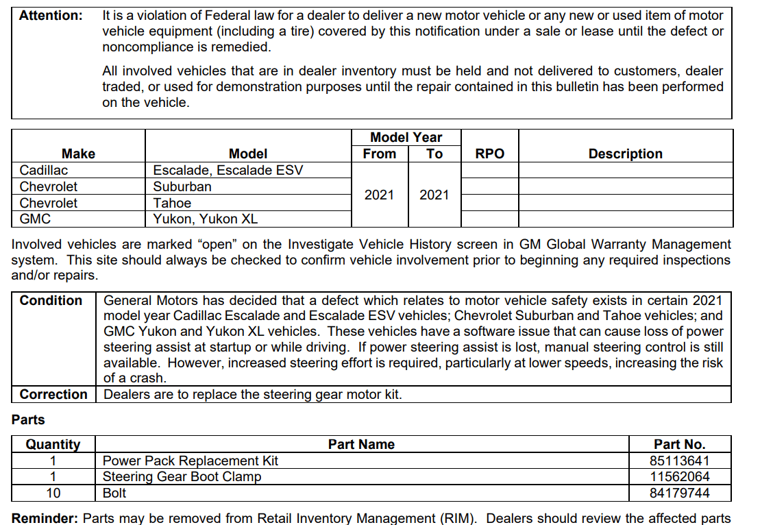

Jeep ain't the only one with this issue -
Jeep Gladiator Steering locked while driving 1642612772063
