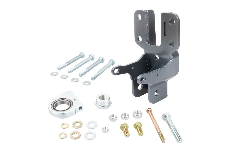

I did the Falcon stabilizer and the Synergy sector shaft brace to no avail, still has a slight drift. Had it aligned by my dealer afterwards. No change...
