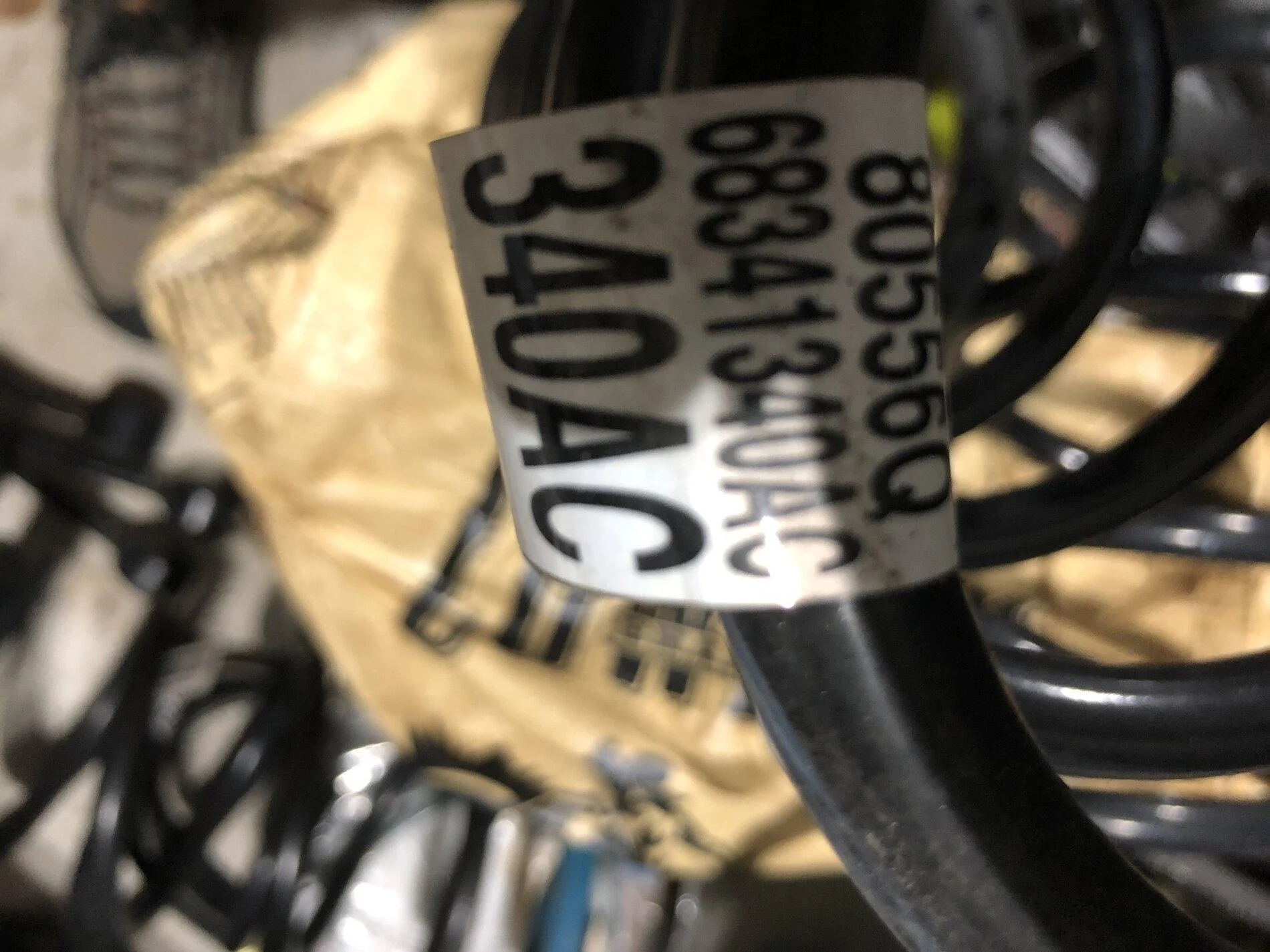

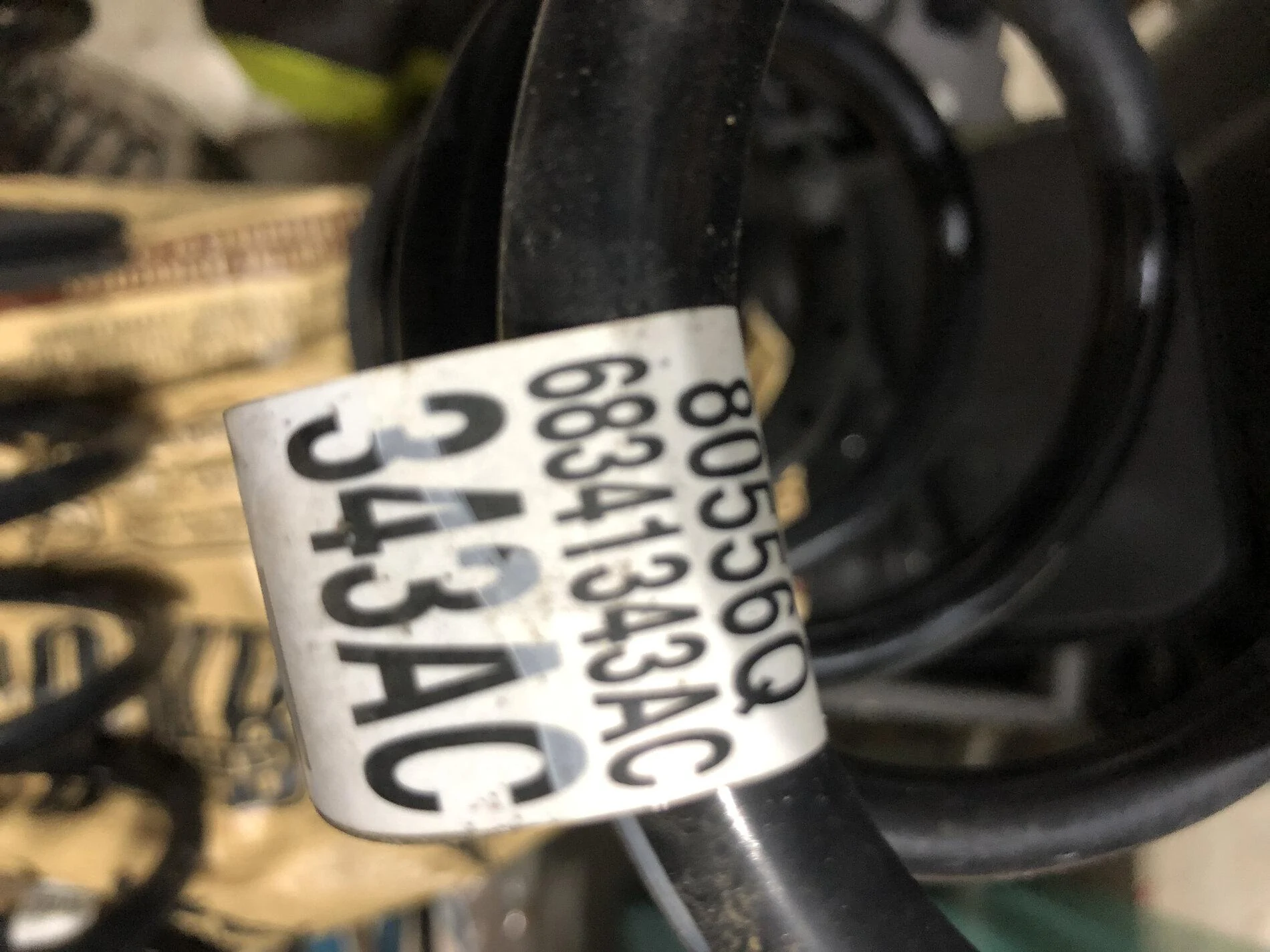

The only difference is the shocks and springs, the rest is the same. There are a number of different springs used some stiffer and would give you more lift. These are the part numbers of a pair of front springs I used that have me 1” over stock on my sport.
