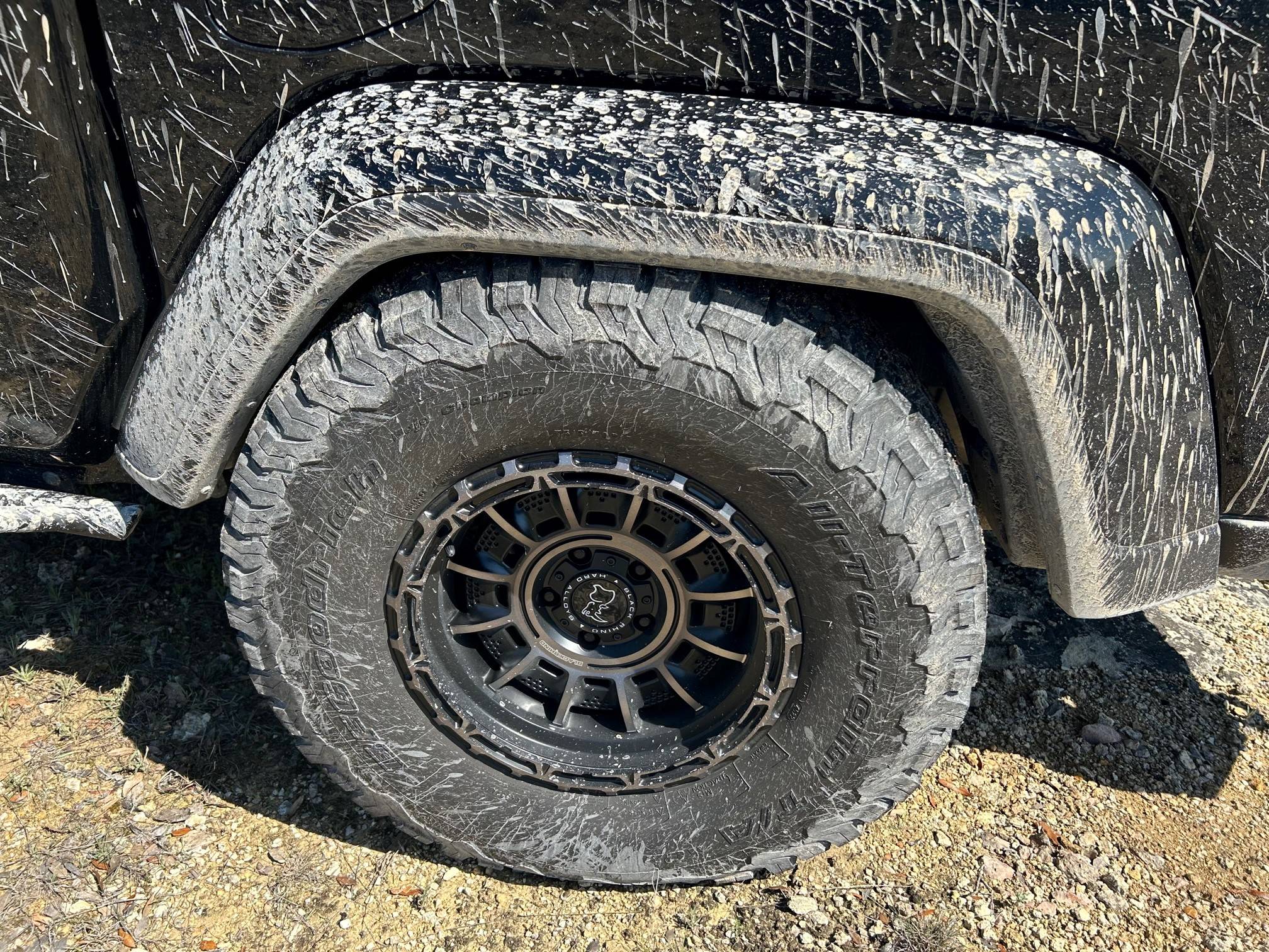

you can step all the way up to a 35" tire with no lift if you want. There are lots of videos with people testing 35s on the different social medias. Even at full travel, there is little to no rubbing.
Yes and no. If you wheel, 35's do not fit unless you change our your fender flairs (or maybe rubi flairs) or add extended bump stops. If you don't wheel, then you will probably be fine 95% of the time.
In this pic, my stock bump stops are just barely making contact but the tire is firmly in contact with the flair.
