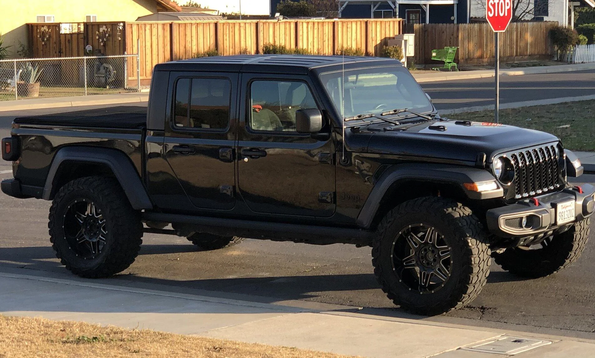

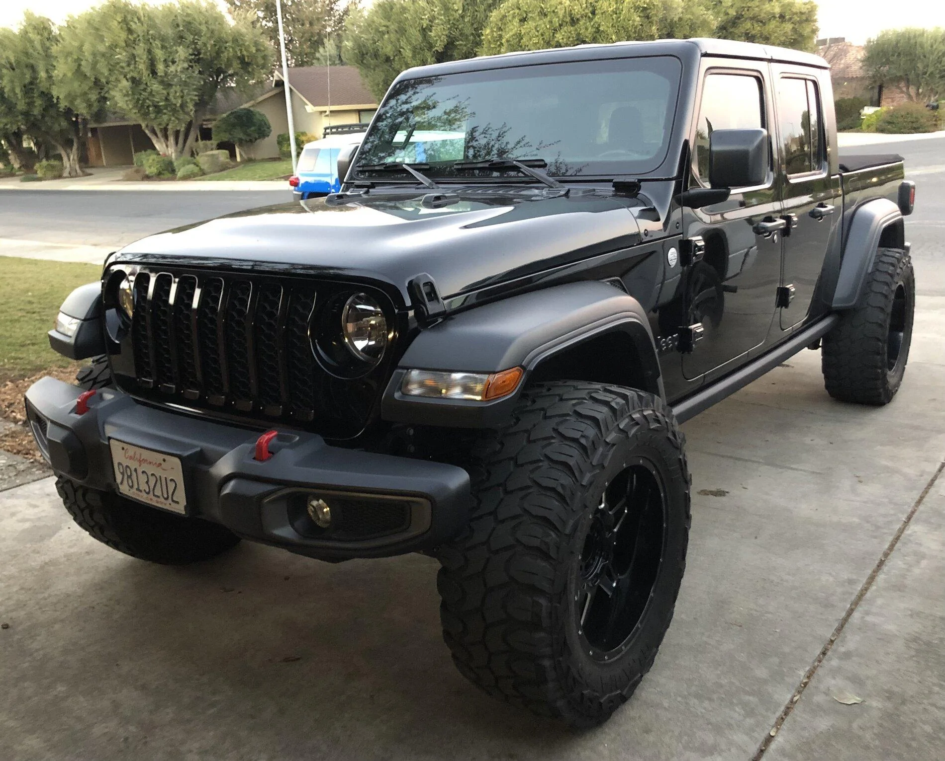

They may have settled over time but immediately after install of just the rubicon fox shocks I measured and gained 1/2” from the ground to the bottom of the rear fenders. I kept my rear max tow springs in the rear and added a 3/4” spacer to the rear springs to level the front rubicon coils (w 1.5” spacers) and rubi shocks to clear 37” tires.
