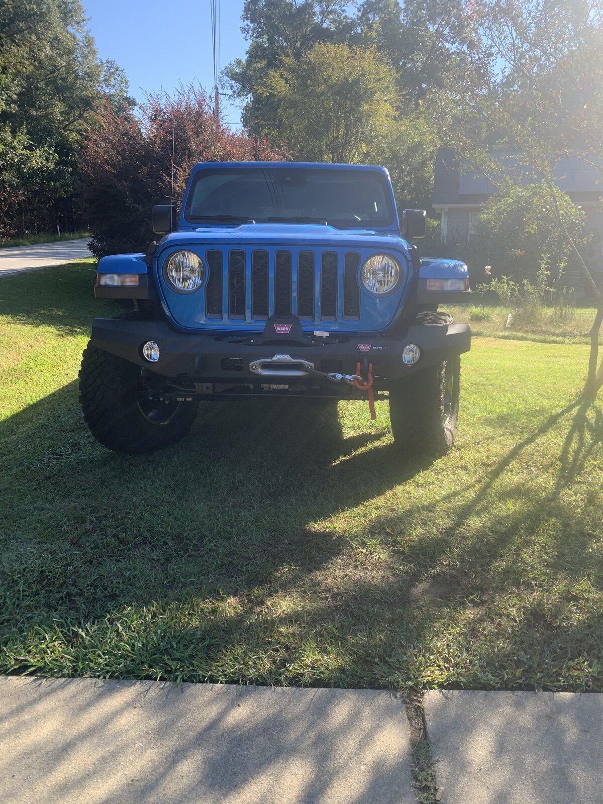

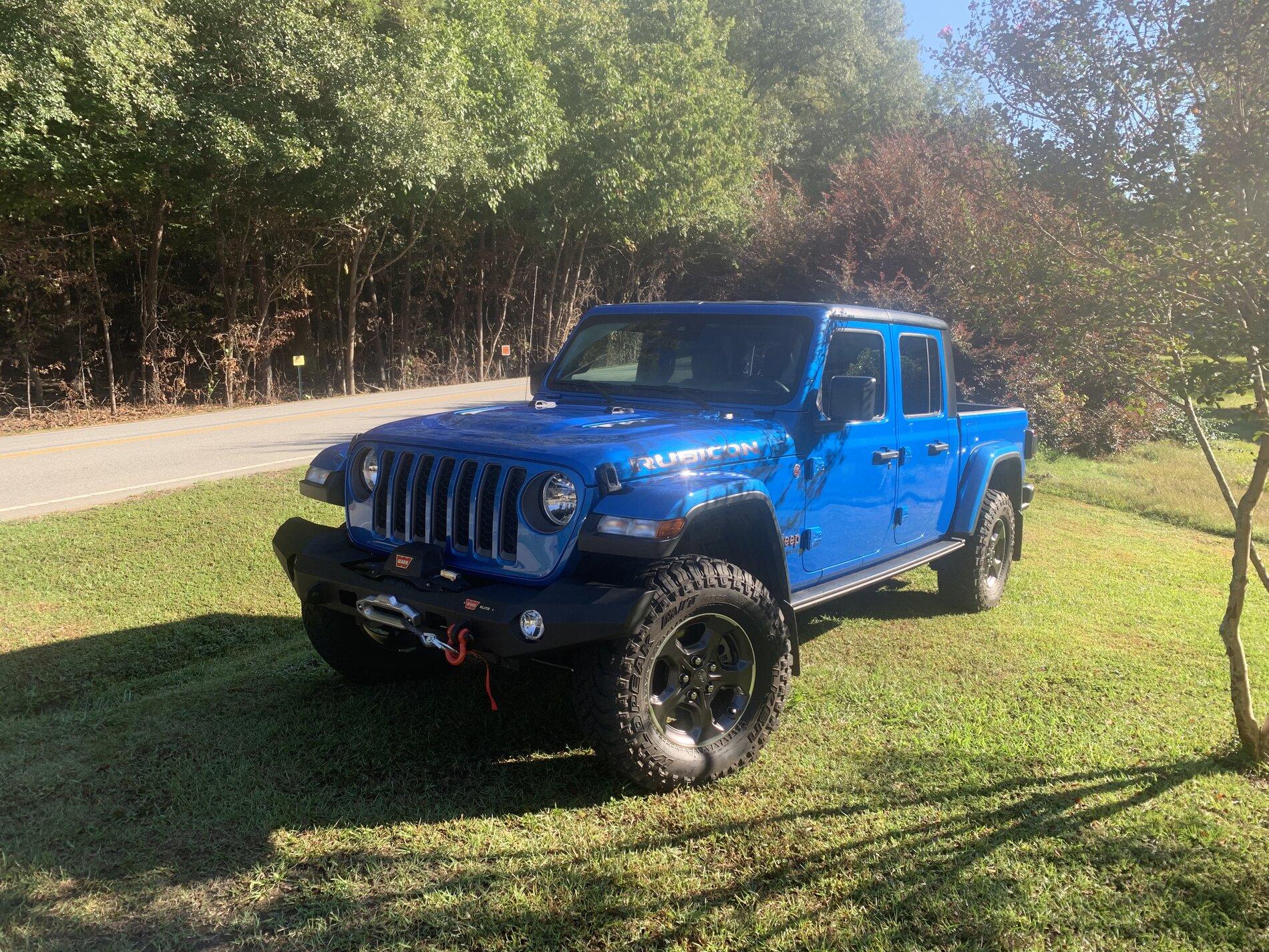

I've got a 21 JTRD with the steel skid and I'm planning to install the warn Elite full width bumper. Can anyone confirm that the skid plate will fit with the warn bumper? The warn skid plate is on backorder for 4 weeks still.

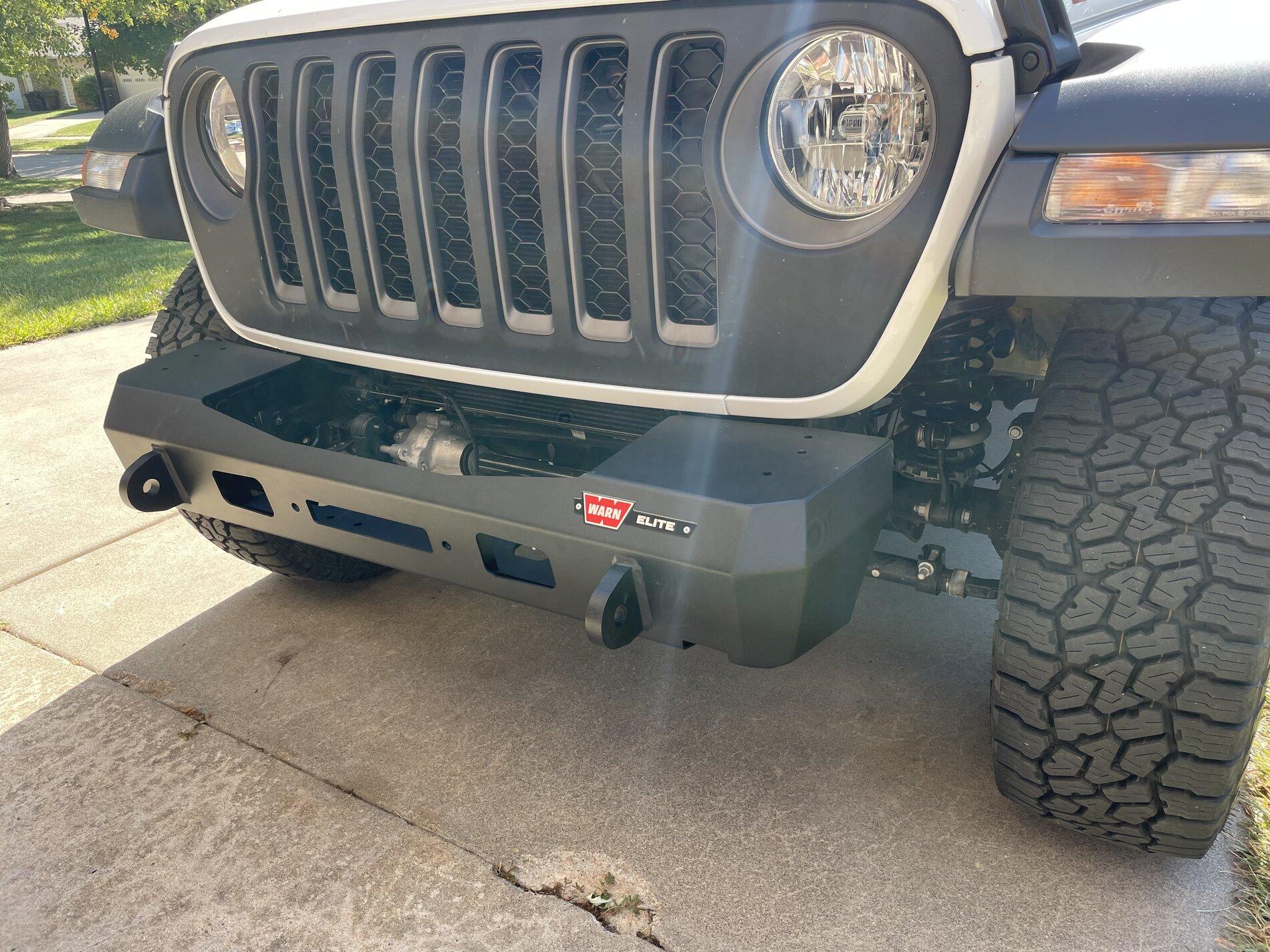

I’m putting on the elite stubby at this very moment. I had falsely assumed they would have made these work together but I was very wrong. The upper mounts interferes with the bumper and the skid is overall too tall. I’m flirting with trimming the skid down till I can bolt the lower mounts to the frame then welding it to the bumper or making brackets if that seems like it would work.

yeah, I installed the bumper Sunday, and there wasn't a good way to make the stock skid fit, Guess i'll have to wait until the skid plate ships.
