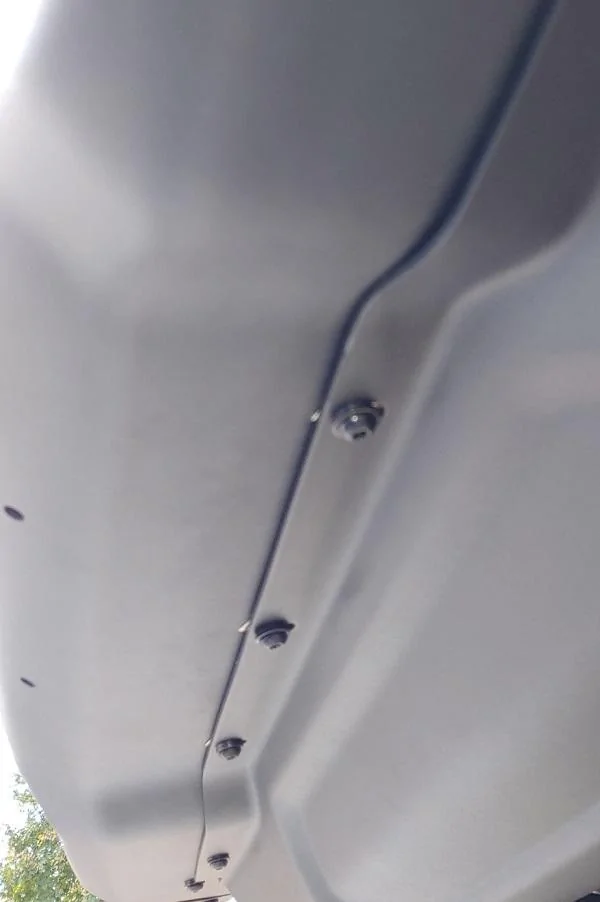

This is my steel bumper and steel skid plate FOR the steel bumper. Bumper is what you see on the left, skid plate is what you see on the right, the middle is where the skid plate bolts to the bumper.
Jeep Gladiator Rubicon Steel Bumper Skid Plate 20201016_115731_HDR

Because you went steel bumper but did not use the skid plate intended for the steel bumper. You kept the other version - used with the plastic bumper.
There's a different skid plate for steel bumpers - and it bolts to the bumper.
Yea for sure it isn't the steel bumper compatible plate....but for now washers work for me.
