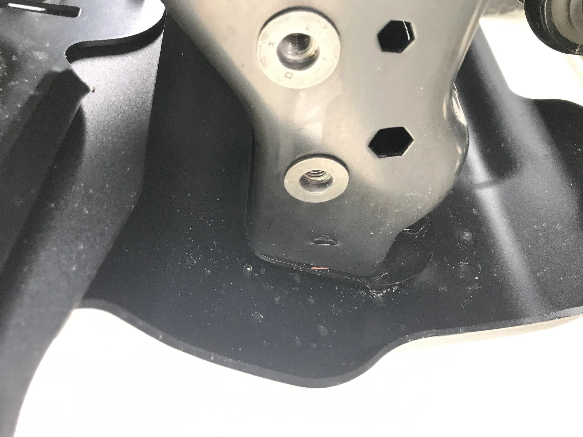

The standard rubicon brackets definitely don’t fit. I was able to attach it with no bracket, and don’t seem to have any fit issues.
Interesting..
You have a plate on the bottom of your frame rail for the plate to attach, which looks like the brackets I bought...
I didn't have any type of bracket on my frame.
The holes were there for the Moly nuts, but no bracket.
The 2 bolts that hold the brackets on are on the inside of the frame rail.
It's possible that bracket was on your Rubicon JT, and not being used, in anticipation of installing the Steel Bumper..
It's also interesting you have to Moly nuts on the outside of the frame rail, which I do not have.
Appreciate the feedback!

Interesting..
The nuts on the outside of the rail that are not being used were from the brackets for the standard skid plate.

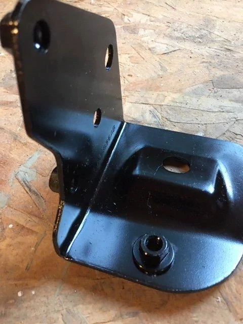

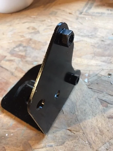

This is the bracket I found online that seems to be what is needed for steel skid plate.
https://www.moparoneonline.com/oem-parts/mopar-bracket-skid-plate-68353836ab
Also attached is a picture of the bracket that came with my rubicon as standard. They are different and the holes on the standard bracket don’t line up with the steel skid plate. You can see the original bracket only has one attach point for the skid plate, while the new bracket has two. It also mounted at a different angle.
So although my installation works by bolting directly to frame, I’m actually only using one of those holes by not having the new bracket. It feels secure enough, but I’ll probably end up ordering it anyway.
That bracket looks like the ones I bought, but mine are a little bigger at the top and have 2 nuts welded on for who knows what...
I also only used the 1 bolt per bracket to attach the skid plate. I also have the bigger hole you show in your picture.
I was thinking this might be for water drainage, not sure... But I didn't put a bolt in it because I don't think it's needed.
2 bolts attach the bracket to the frame, with the Moly nuts inserted, and 2 bolts attached the plate.
My thought was if that other hole was for a bolt, they would have had a welded on nut like the front hole.
And I might be completely wrong.. Either way it's secure and it's not going anywhere..
