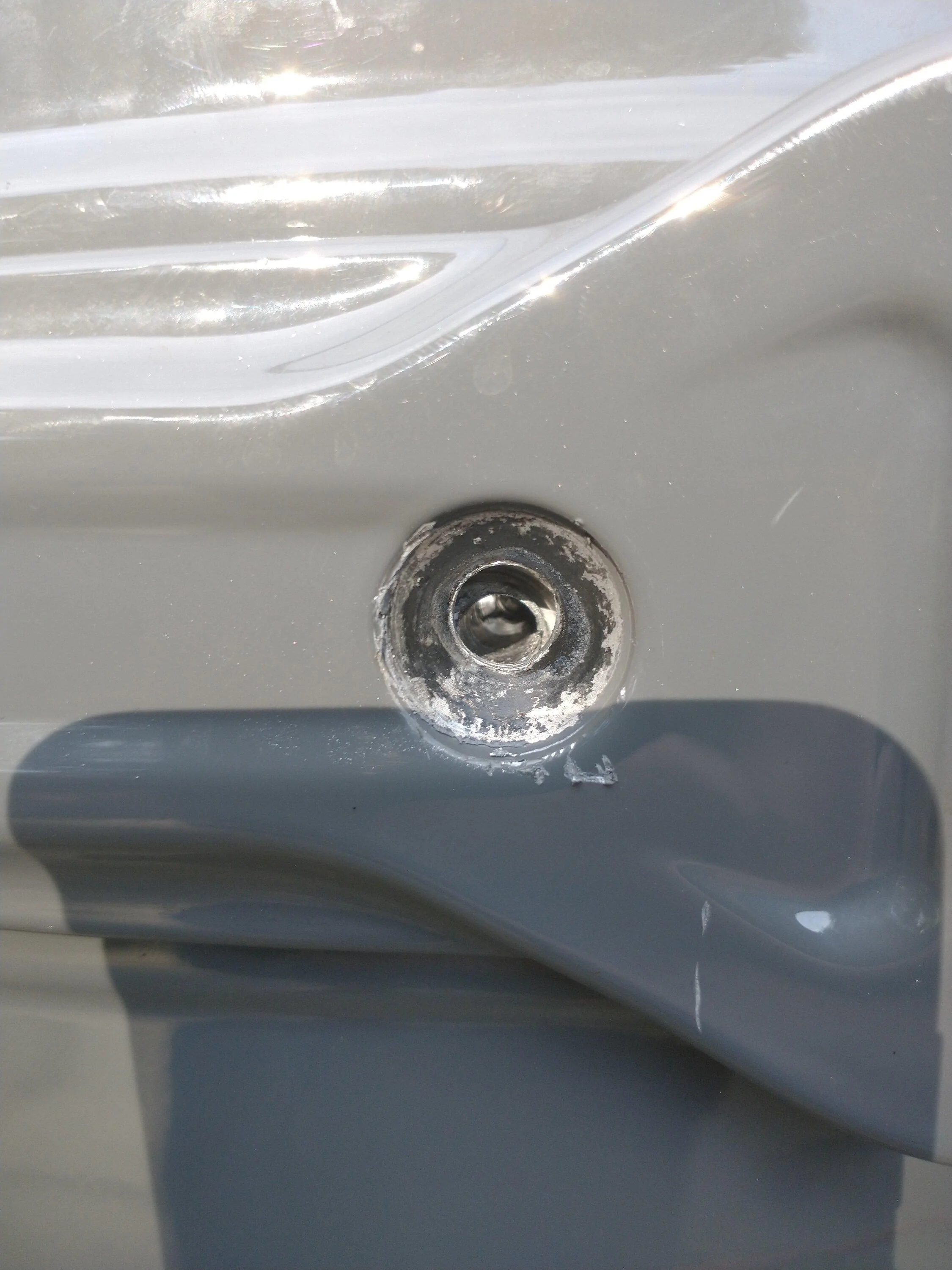

So i figured i would let some pros handle this, but a mechanic and a couple of recommended body shop guys couldn't get it. I got some different bolt extractors (not the easy out variety) and started drilling.
Good news is, i got the bolt head out in about 20 min. Bad news, i drilled a bit too deep and off center. Now I've got about half the bolt still in the floating plate that holds the threads. The bolt isn't broken off evenly either so I can't drill into it.
Three bolts will have to hold that hinge until i can figure something out, but i think it's ok for now.
Also, the amount of loctite on that particular built was way more than all the other hinge bolts.
Thread locker - that's why I figured your options were limited. (it wasn't going to just screw out when the head was off, and had doubts about chisel and solvents ain't gonna touch it as it ain't rusted, but hey, try it all)
Heat was about the only way to break the hold on that thing - one of those inductive heaters.
https://www.amazon.com/Bolt-Buster-BB2-ACC-Handheld-Induction/dp/B00ATSL7VE
Get to the back side and take that plate out (if you can access it realistically) - then mill the rest of the bolt out or replace the plate.

Can't take see it, but it's in there. Went ahead and put the step on with three bolts
I don’t know how you are sleeping at night. I’d be a freaking mess.
alwhite
alwhite
Logan
Jun 26, 2019
148
140
NC
2020 Gladiator Rubicon, Honda Element
Librarian
Oh it's not great. Trying to figure out how to access the back side of the plate now

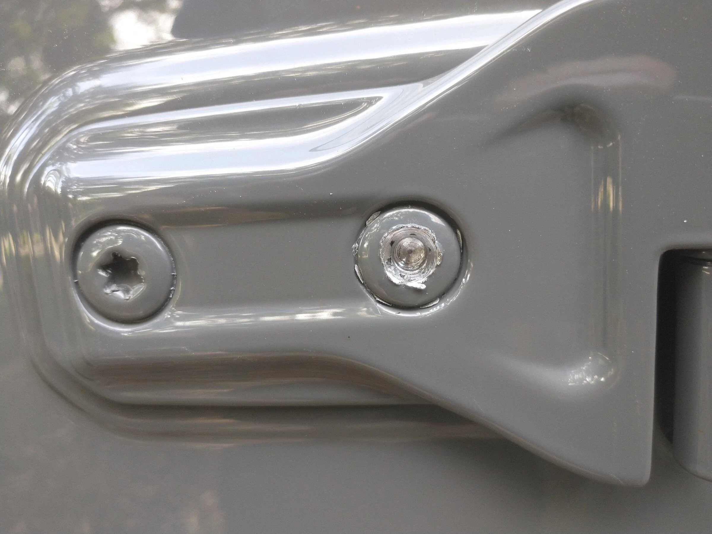

Well, i screwed up. Installing door hinge steps and got 7 of the 8 out no problems. The last one stripped unbelievably badly. I tried to drill it with an extractor, but that isn't working and now i just have a mess. Any ideas on what to do next?
The Torx started to become popular on premium firarm some time ago - they are much, much, easier to strip vs say hex. I think which ever engineer designed them should be "drawn and quartered" ;-).
Don't forget that you can always drill it out BIG and then put in a helicoil.
