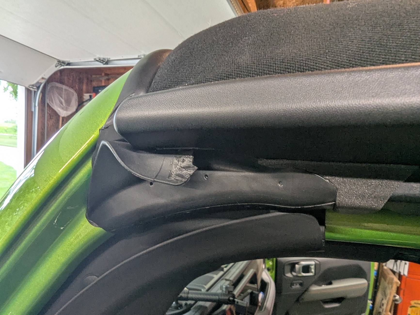

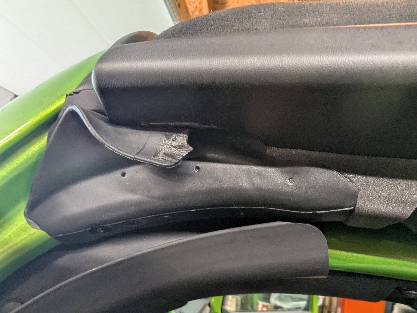

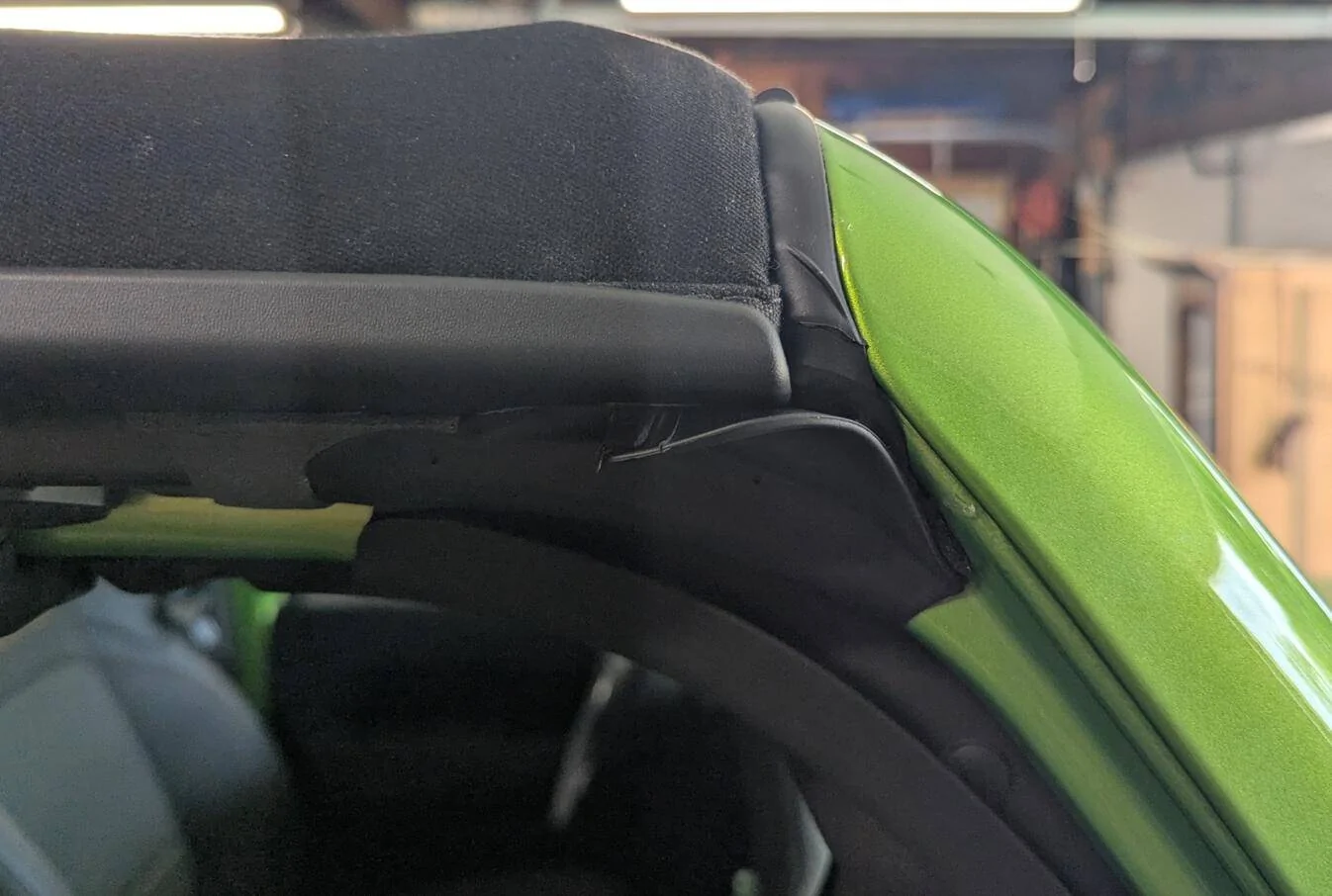

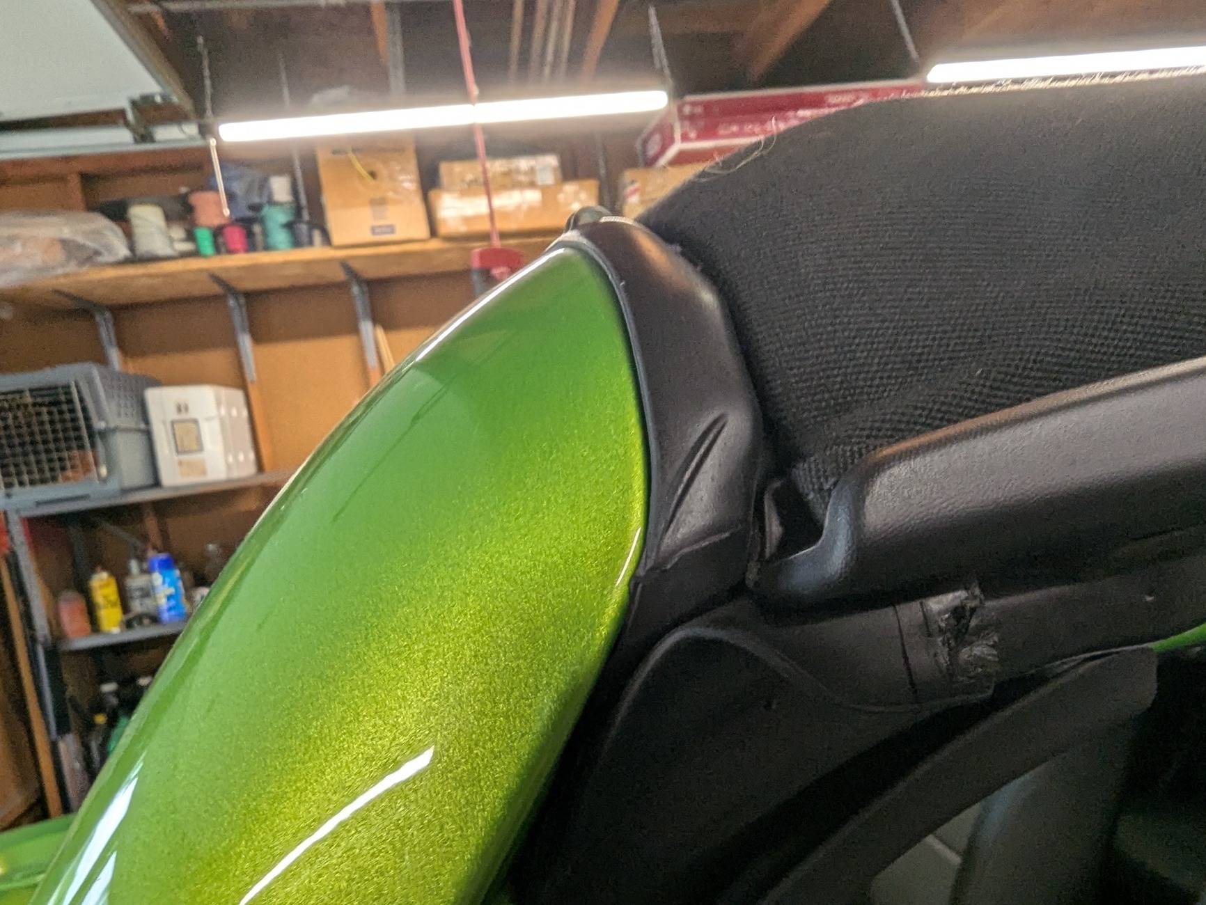

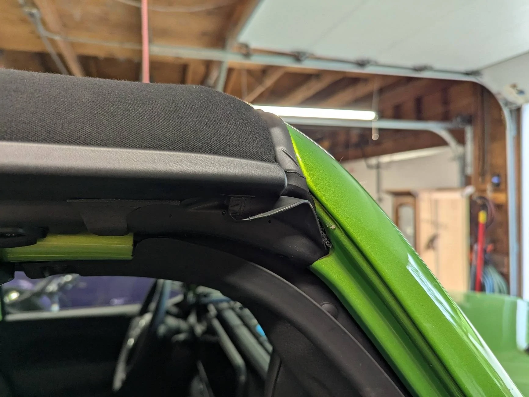

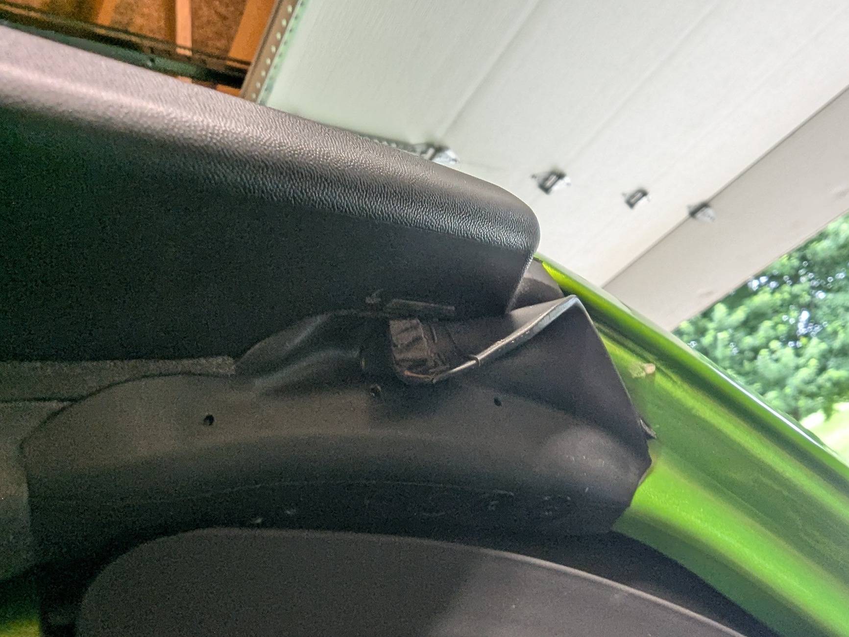

After finding out the sunrider was chewing up the seals - it came off today.
The wind noise was absolutely horrible, and can't put headliner in one until there is a resolution to all of this, so off it came, panels back on.
So much quieter, cooler, and driving in the rain - amazingly different, but the wind noise, I didn't realize how horrible the sunrider is for wind noise until I swapped back.
Drove hundreds of miles in the wind and rain both ways so far in the last few days and it's night and day.
Plus - check out the condition of these bits - it's destroying things, so off it came until Bestop and Jeep get some control over this situation.
With the panels back in, the seals/muckets and so on work and fit PERFECTLY and the clearance with the tops of the doors is all back again. (my sunrider was really at times only a few thousandths of an inch from the door edge)
Panels back in until i get a call or message from Jeep.
Jeep Gladiator Sunrider owners - MY mess-up, or theirs? PXL_20250624_140625905
Above and below - look how deep down the front edge fits into the windshield seal - it's really down there.
Jeep Gladiator Sunrider owners - MY mess-up, or theirs? PXL_20250624_140612524
Jeep Gladiator Sunrider owners - MY mess-up, or theirs? PXL_20250624_140607861
Jeep Gladiator Sunrider owners - MY mess-up, or theirs? PXL_20250624_140448765
Jeep Gladiator Sunrider owners - MY mess-up, or theirs? PXL_20250624_140440903
