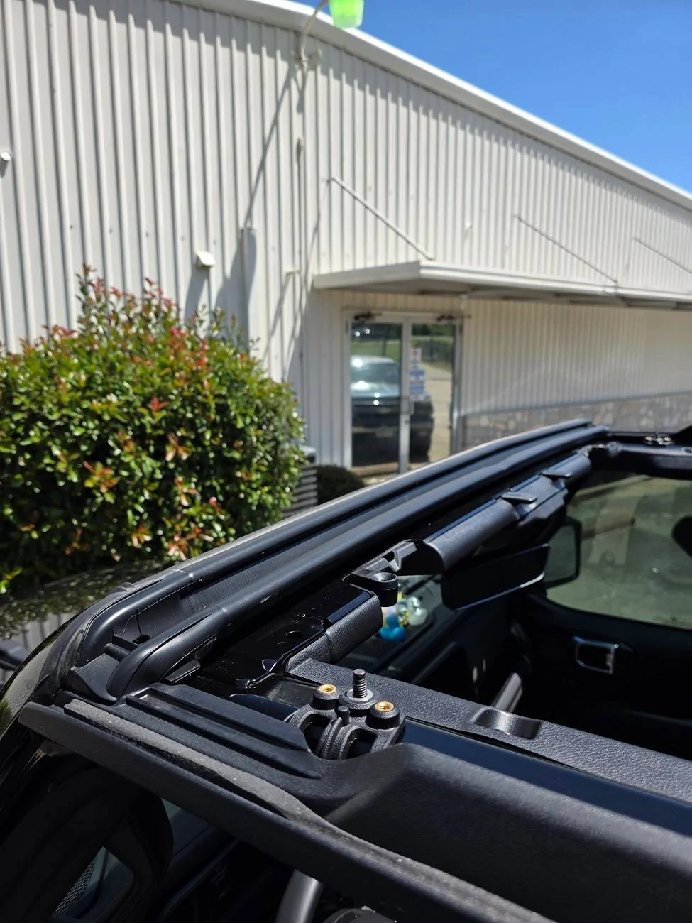

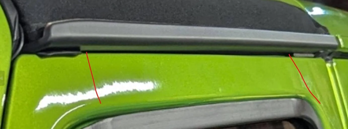

If you look at the pictures of how mine fits - it isn't anything to do with seals or the changes in seals for 2021 and later (and if it was, Bestop has had YEARS to fix it) - the sunrider simply, absolutely, sits TOO LOW at the front.
The seals are the side effect of a bad fit, not the cause.
The sunrider all but hits on the tops of the doors. It should run parallel to the door tops just like the panels do. Instead, it slants downward a lot going forward. If it sat like it should, it would work on any year JT
How it should fit - (picture from Bestop themselves)
Jeep Gladiator Sunrider owners - MY mess-up, or theirs? 1751380345233-eu

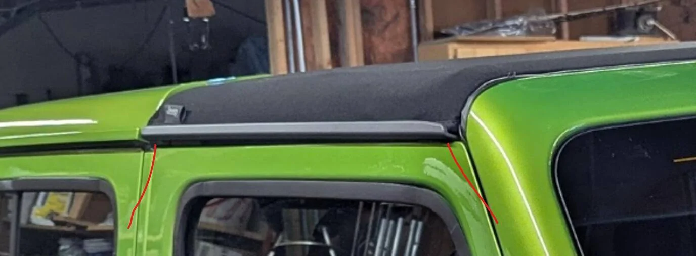

Sunrider should fit exactly as shown above - and as the panels do below - look how high the front of the sunrider sits on the windshield seal in the pic above.
Jeep Gladiator Sunrider owners - MY mess-up, or theirs? PXL_20250602_150609085
Gap between sunrider rail and top of door should be the same front of the door as it is at the rear of the door. That's how the panels fit - gap between drip rail stays the same rear to front.

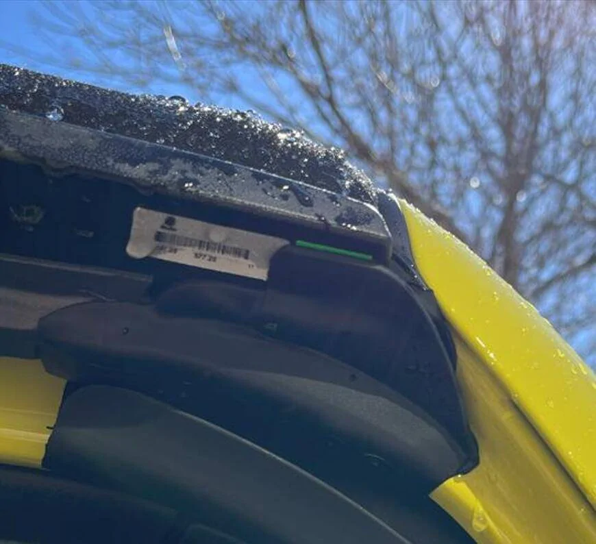

How can it be a seal change if the sunrider all but rubs on the doors?
The JLU is a 23 - the change was made in 21.
However, the seal has nothing to do with it when the sunrider comes down to the door. The seals didn't change that.
Look at pictures of one that fits properly - like I posted above - that is a post 21 Jeep. The yellow jeep picture above? That has the SAME seals as mine. Same thing. All Jeeps from 2021 on have the same seals.
You can tell it's a 21 or later because it has the plastic water channel.
This Jeep has the exact same seals as mine. Exactly the same. Look how high the front is on the windshield seal.
Mine sinks way down, crushing the windshield seal - which didn't change at the top, it only changed at the ends.

Absolutely no way it's a seal issue. It can't possible be when the sunrider rubs the door tops
If you took those seals out - it would still fit wrong. The seals don't determine the position or height of the sunrider - the sunrider does that.

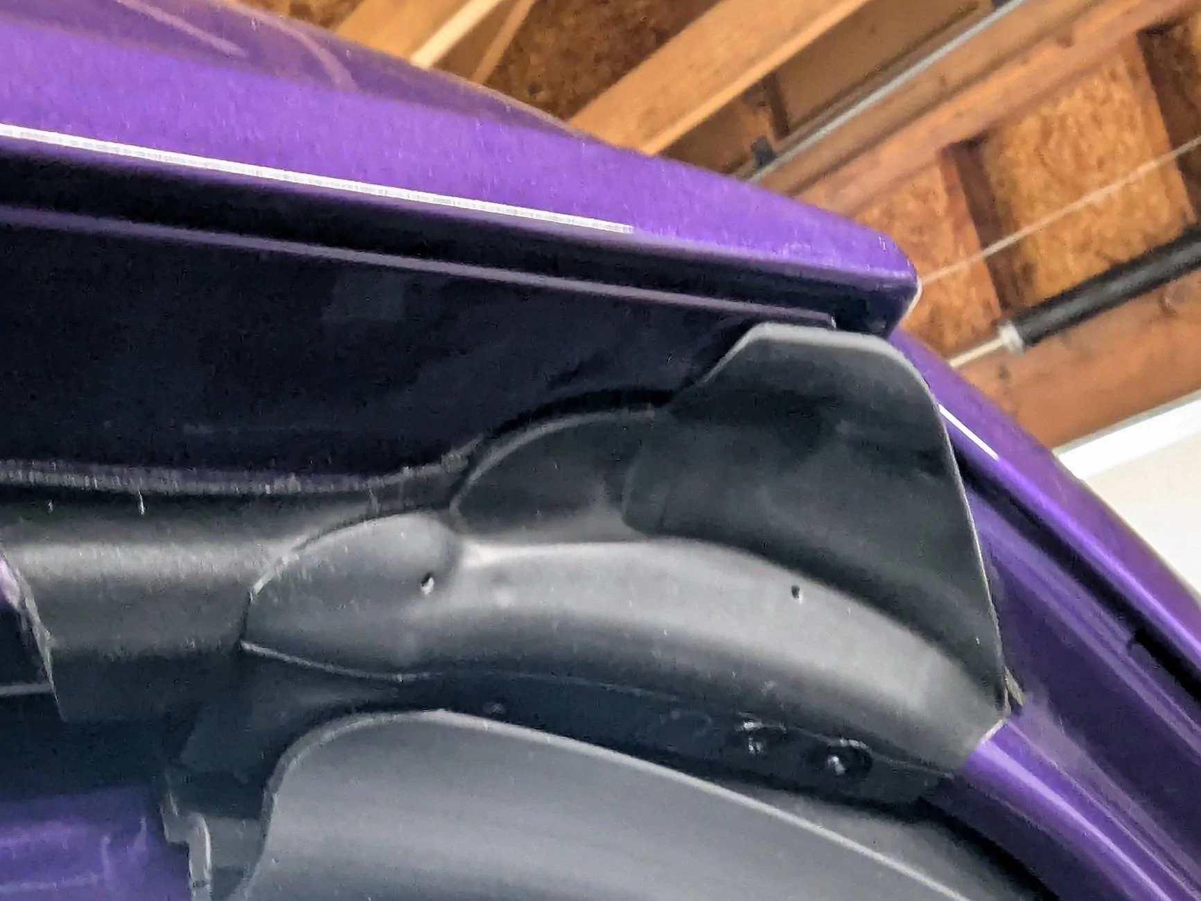

Compare where the end of the sunrider drip rail in the pic above lands next to the raised rib on the windshield seal -
then on mine, it lands way below that part of the seal -
Jeep Gladiator Sunrider owners - MY mess-up, or theirs? PXL_20250624_140625905
The end of the sunrider drip rail should end up lined up with that small rib - not way below it.
All anyone has to do is look at the sunrider and the body parts of a Jeep - IGNORE THE DAMNED SEALS - and you'll see how very low it sits - all but rubbing the door, and crushing the windshield seal, which has not changed at all at the top.
This gap is to be parallel rear to front - this side is bad, the right is even worse.

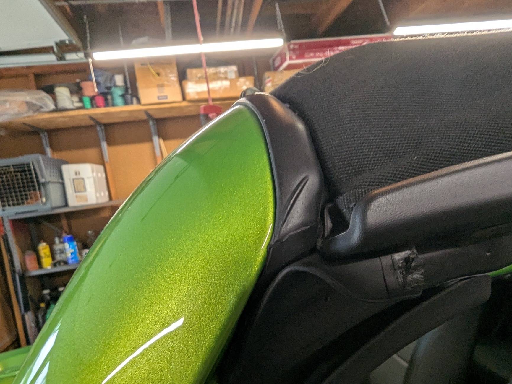

I’ve looked at all the pictures. I have a 2021 and have the older style seals. I’m all but positive it happened much more recently. The seal I think is different is the one on the windshield edge. Can you take a picture of the windshield seal on your 23?

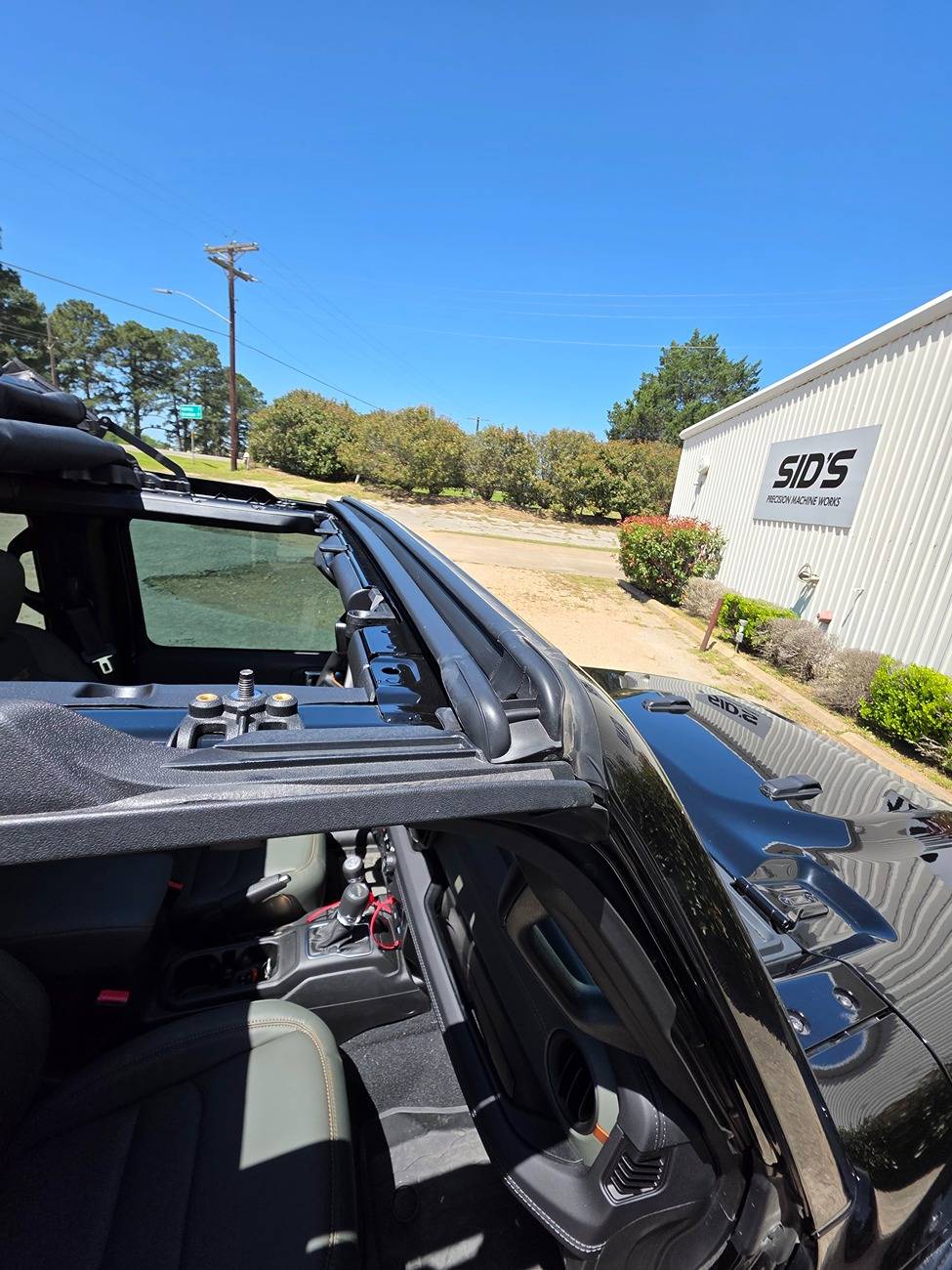

That is definitely not a seal problem. The side rail should sit on the jeep just like the freedom panels do. That has nothing to do with the front seal and everything to do with the way the side rails mount to the roll cage.
I did notice that the Mopar branded top has a different front mount than the Bestop branded one.

TWO of them fit shitty. In fact, I suspect the one my son and I took off was the second one the dealership tried and not the original because it was actually WORSE (although they said it was a bit better LOL)
In any case, we had to take it off or risk losing paint on the door.
Does yours rub on the door? Is it over 0.20" away from the top of the door at the front?
Sorry, been through all of this- zip to do with seals. Look at that shitty fit.
Sits way high in the back - even higher at the back than the left side!
Then it drops to no clearance at the front and crushes the windshield seal - which has not changed at the top because the freedom panels haven't changed.
The thing even looks cockeyed, crooked, screwed up, back sitting so high, but crushing things at the front. A freedom panel has the same gap above the door front to rear, rear to front, no difference. The gap is very parallel.
I know you like Bestop and can't believe they have an issue - but more people are coming out of the woodwork now saying "yeah, mine, too".
They have a successful product and are pretty much ignoring those where it doesn't fit.
They even had the balls to tell me "no, don't tuck those seals" while I was telling them - I have no choice - your product is destroying them otherwise.
"We don't have a problem - but don't tuck the seals"
LOL So, how is it supposed to be run NOT tucking those seals? Eh?
Right.
You have two choices -
Do as Bestop says - don't tuck the seals and see them totally destroyed in two months
or
tuck the seals even though Bestop says not to.
Crickets from them - and their only support contact has been a basic helpdesk type - is it plugged in, is it turned on, type. No one who actually can do anything,
Yes, I've noticed that as well - and wonder - why?
I've seen two cases of different mounting "pads" - different shapes and sizes. I wonder why that is?

This is from a forum member - (I note the front of the sunrider also sits really low in the seal on his)
Jeep Gladiator Sunrider owners - MY mess-up, or theirs? Screenshot 2025-06-03 171721
Proof it's not just my situation. His was so bad he GROUND the sunrider to make it fit!

The problem isn't the seals - the seals prove a problem exists.
They are the same 2021 forward.
Even if you removed the new seal style and went back to 2020 type door seals and lack of water diversion - the fit would be bad as it simply bolts on way too low at the front.
I had wondered about making the upper mounting pad thicker, but then their clamp thing that comes around the bottom wouldn't reach as it appears to be made to just go around the thickness of that top bar.
The freedom panels never changed when the new seals were introduced in 21.
Everything indexes off that roll cage - doors have to close and seal against it, windshield bolts to it, sun visor fit, even the camera/radar unit for the FCW and ACC attach to it.. Any change to the structure of the Jeep, especially that roll cage, would mean a lot of other changes in design and part numbers.
So, the Jeep didn't change. Seals were added to prevent rain from dripping inside when the doors were opened. And that change is ONLY at the door's front upper corner area.
The rails mount too low at the front.
The problem exists with the top forward or open and back. There's no tension on the side rails either open or closed.
