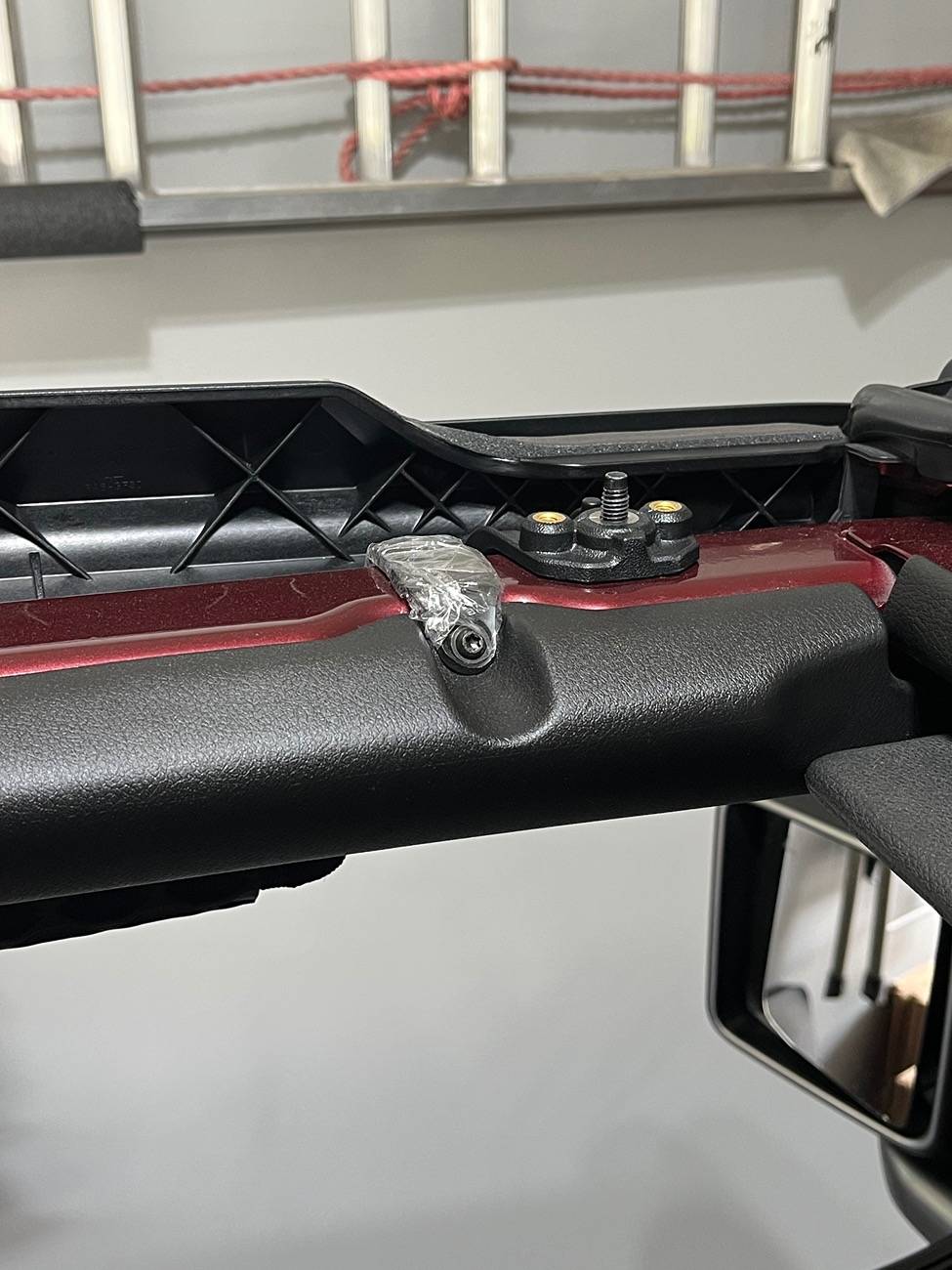

Hmmm, don't think you'll have to actually remove - maybe just "open" it?
I don't have pics of the bottom - but since it's off and laying on the floor, that could be easy to get.
I've got these -

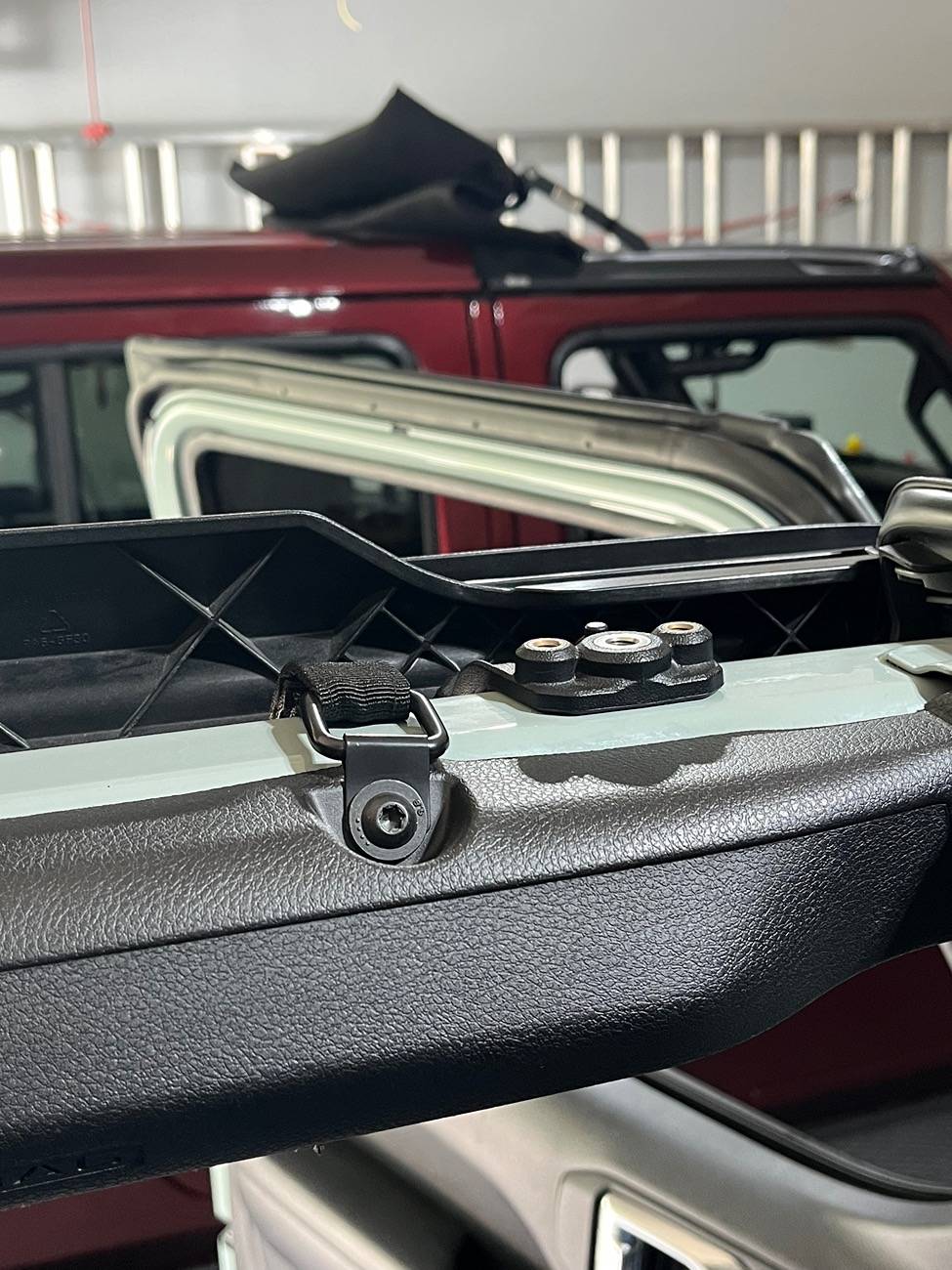

This shows the other style - someone else posted this one -
The final resolution will have to come from them since it's their patented product, they conceived, developed, engineered and had it made.
Unless Jeep actually bought the rights to manufacture it from them (and no one knows) it's totally Bestop.
IF - again we don't know - IF Jeep bought the rights, licensed the rights to make it and sell it through their dealerships and as a factory option, then it's a Jeep problem.
(the way FCA licensed the rights to build the ZF transmission).
But we don't know who makes it, if Jeep licensed it, or if it's all Bestop.
In any case it's their baby - their invention, design and so on. They hold the rights in any case.

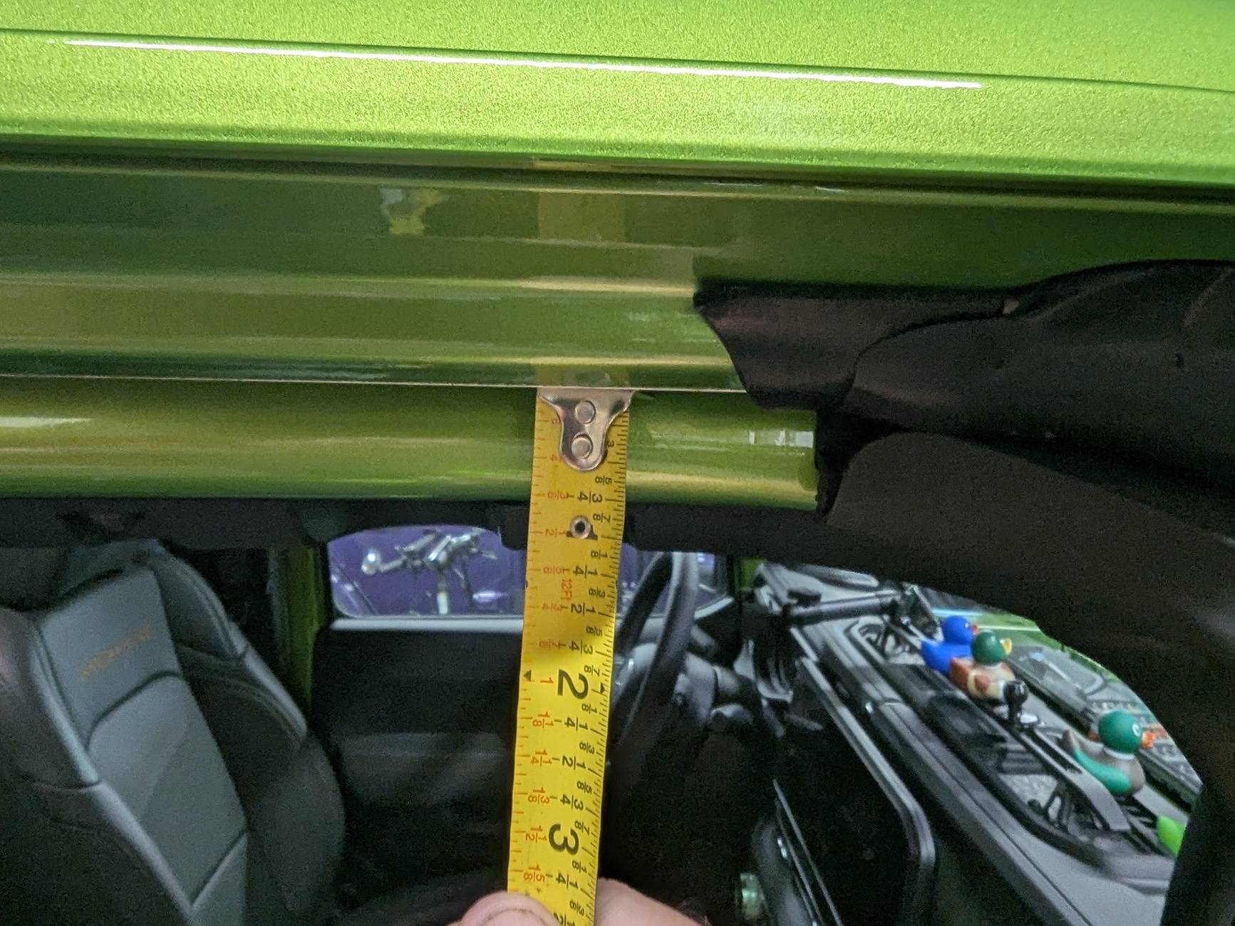

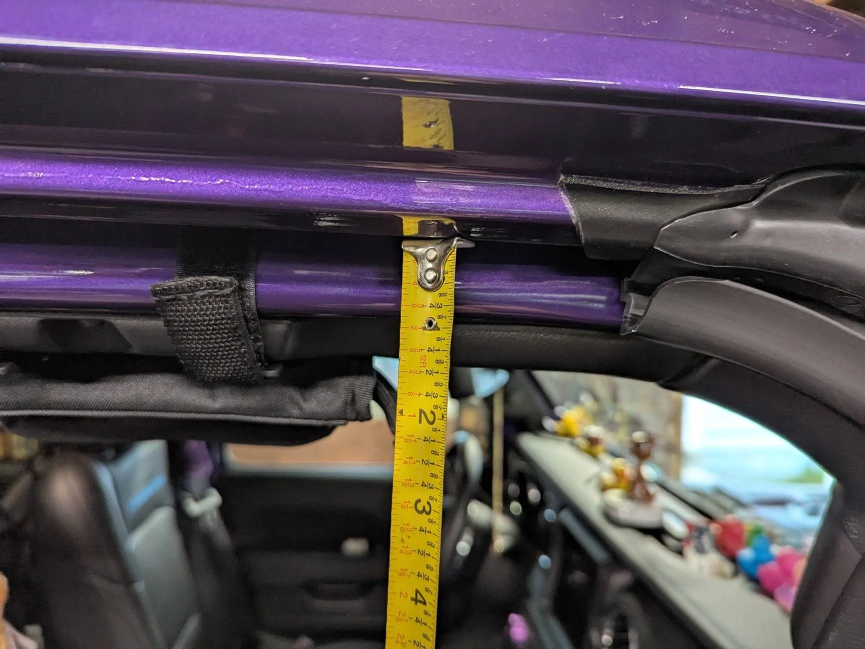

OK, here's some fotos and measurements. Sorry, really really hard to hold the phone, hit the button and hold a tape measure up with my hands as they are. I had a heck of a time just holding the tape measure in place and not dropping it.........
Anyway, I measured from this point on the freedom panel to the bottom of the rail. Before I grabbed my phone I did hold a straight edge up there to try to be accurate, then tried to hold the phone up at the same height as the bar for a good perspective pic but looks like I missed.
In both cases, this was 3/4" - not even give or take, it landed on the 3/4" mark.
Next I measured the "thickness of that bar, using a wire with a 90 degree bend on one end and pushed it up through the sunrider mounting hole, and marked the end sticking out the bottom.
Both Jeeps this measured 1 3/4".
Then I put a wire up through the hole until it touched the freedom panel, making sure to hit the panel in the same spot on both Jeeps - 2 3/4" so the panel sits 1" above the top of the bar. And that I confirmed as well.
I came up with both the 2023 JLU and the 2025 JT having the same dimensions at that bar and between bar and panel, I even measured from the bottom of the bar to the top of the pinch weld at the rocker panel area (door sill where we drag out feet getting in). Same measurement. Didn't write it down, but ran between Jeeps really fast and remembered it for 15 seconds (the extent of my storage for such things)
I would not have been surprised to see a difference due to the air bags, but then, I'm not surprised to see no differences since everything relies on those bars being pretty exact between Jeeps. To deviate would mean door, windshield and other things would not fit correctly.
