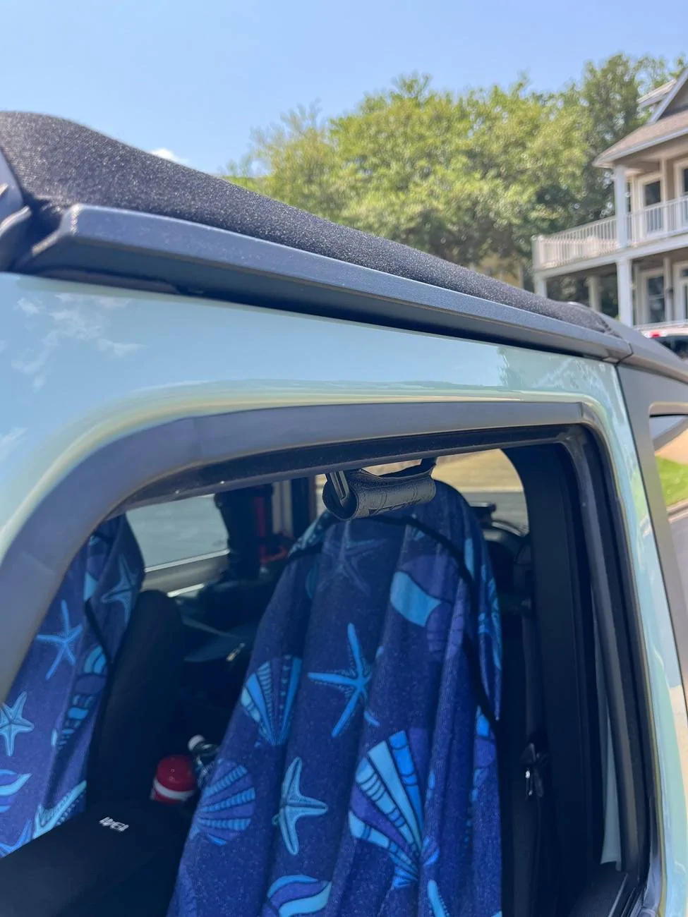

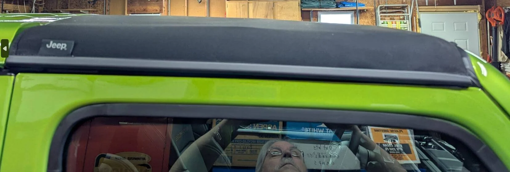

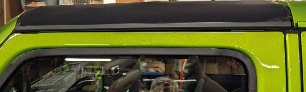

I have a bit of experience with this, and have commented a couple of times about the differences in the seals. I discovered the issue when I moved my 2021 Sunrider from my 2021 Gladiator, and installed it on my 2024 Wrangler. I had the issue with the flaps, that are different on the 2024 compared to the 2021.
2021 Gladiator: (with a new 2024 Sunrider):
Jeep Gladiator Sunrider owners - MY mess-up, or theirs? IMG_2183
2024 Wrangler (with 2021 Sunrider/ with flap up):
Jeep Gladiator Sunrider owners - MY mess-up, or theirs? IMG_2181
The rain will not drain properly with the flap down. I have not experienced any deformation of the flap on the Wrangler. I have also not noted any significant differences in the seals between the 2021 and the 2024, other than the flap.
So bottom line, I have had both a 2021 and 2024 Sunrider on the '21 Gladiator with not fit issues...and a 2021 Sunrider on the 2024 Wrangler with no issues other than the flap. I hope this helps.

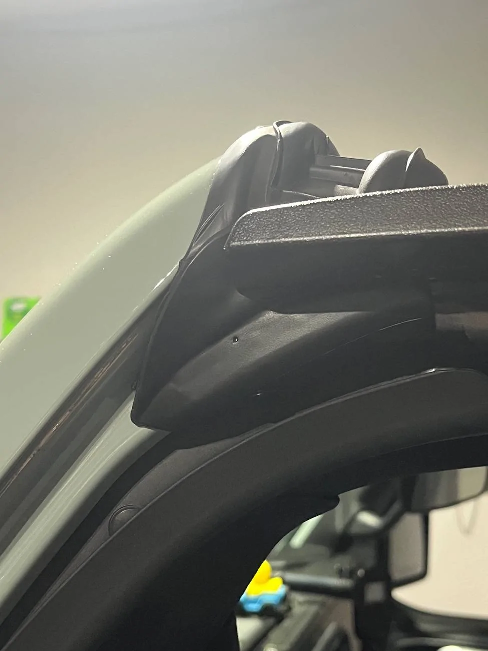

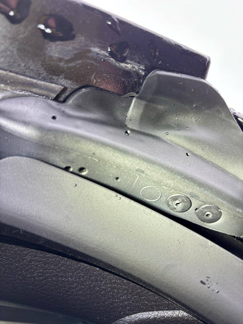

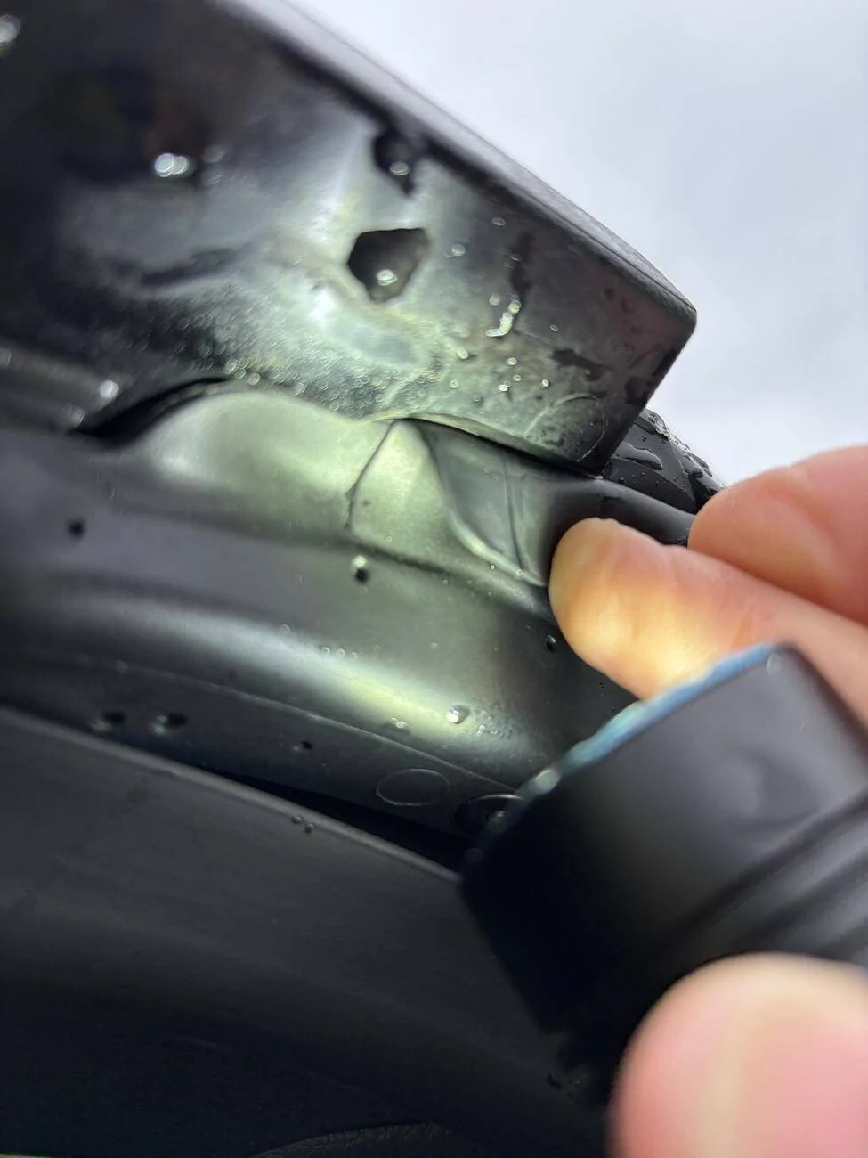

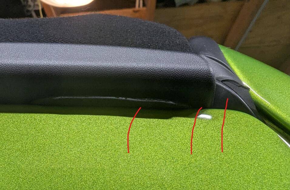

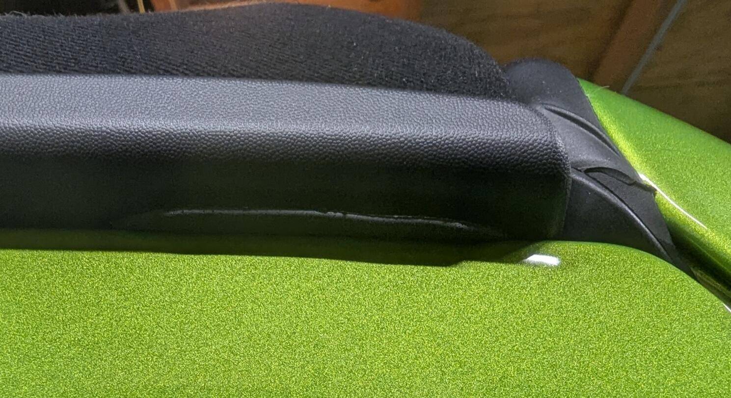

Huge gap between top edge of door at the rear, down to a business card at the front, crushing seals and almost hitting the door - worse on the right -
Jeep Gladiator Sunrider owners - MY mess-up, or theirs? 1748705432564-z0
Jeep Gladiator Sunrider owners - MY mess-up, or theirs? 1748705550175-vr
Jeep Gladiator Sunrider owners - MY mess-up, or theirs? 1748705589013-t9
Left to right -
Left -It's so tight that this seal is pinched down to nothing.
Middle - There is maybe a business card clearance here - maybe not even that much gap.
Right - I tucked that seal up behind the sunrider rail to prevent it from being ripped to shreds opening and closing the door as there is basically no gap between the top and the top edge of the door.
Both sides but the right is worse.

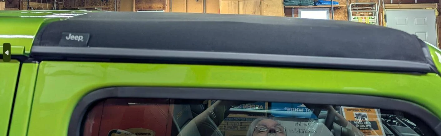

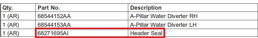

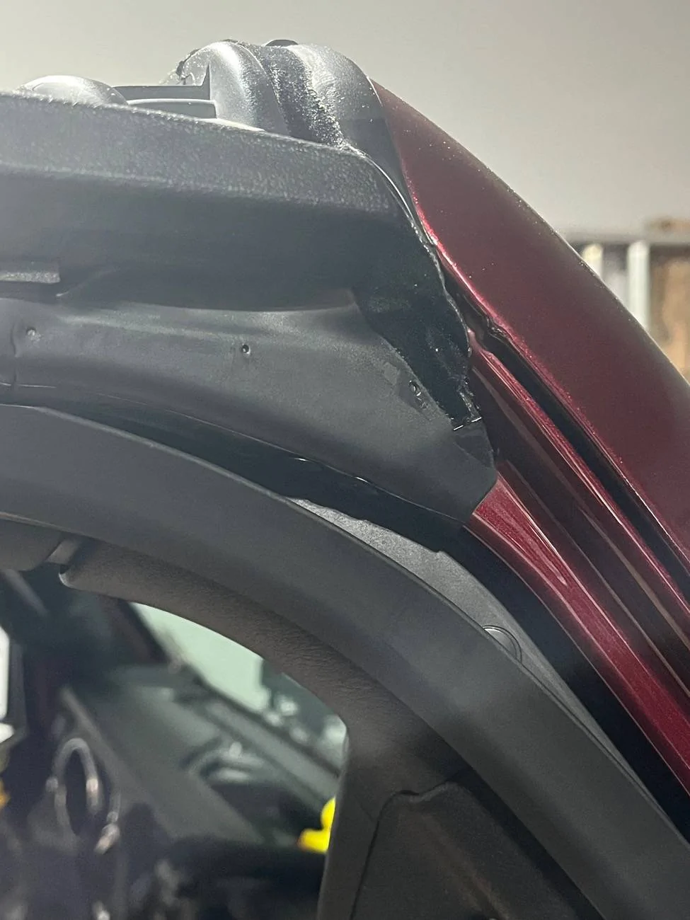

I found this TSB when I was considering updating my weather strips/seals. The header seal, which I'm assuming is the subject of the fitment issue, has gone through several updates. Not sure if geometry actually changed or if newer JTs have something completely different.

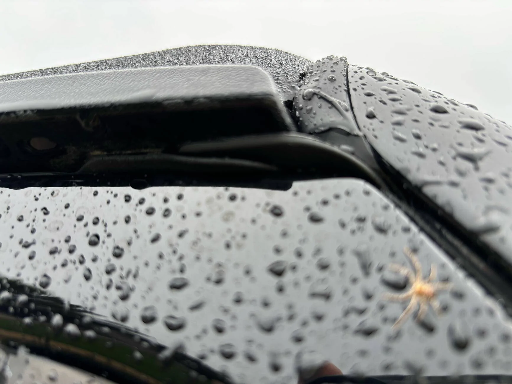

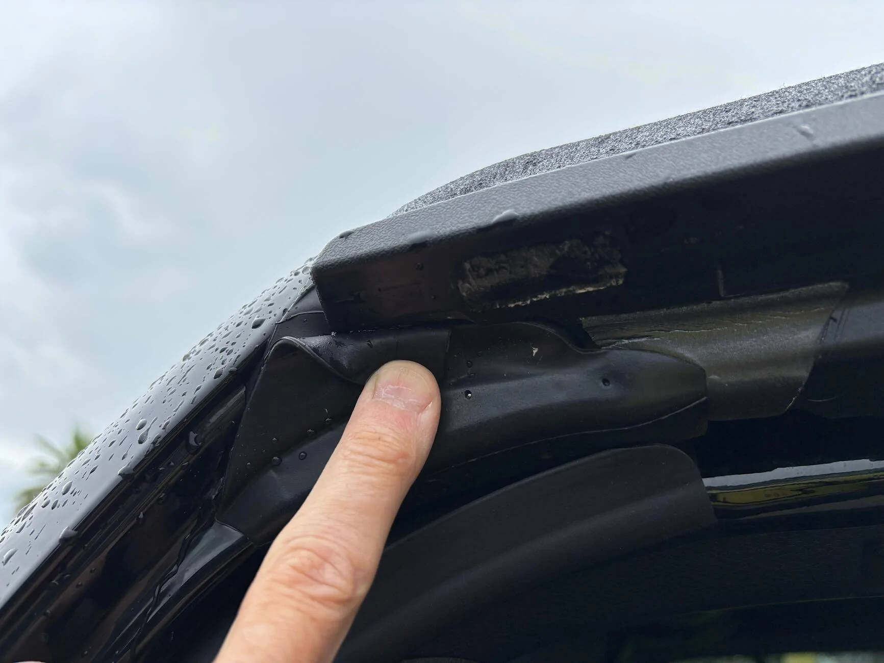

I had the same problem. the rubber flap MUST go on the outside not behind the rail.
I had to grind the rail down close to the inside to allow room for the rubber flap to lay flat.
not sure what is different about my and yours from others that report no problems.
adjusting the rail up for clearance only allowed water in and still bunched up the flap.
what I did worked for me. YMMV
As I showed - mine can't go outside. Closing the door smashes the seal up between the top of the door and the sunrider rail - inside. You can't close the door without crushing and shoving the seal inward.
There's zero clearance for that seal.
there's no adjustment to the rail - it bolts to the frame of the Jeep, so however low it sits when it's bolted on, is how low it sits.
i would have to do what you did - GRIND the sunrider rail to make that seal fit properly and in my case, a lot! The rail almost doesn't clear the top of the door its so bad.
There's another thread where a guy posted pics of his and the sunrider rail shoved the seal down so bad it almost folded it over, downward.
Years, perhaps? I am beginning to believe that the Jeep quest to quiet down the 24 and 25 models (yes, they are a ton quieter!) means that the seals are different and things up there at that windshield header area fit differently.
If @Bestop gives the OK - then grinding it is - I'd actually thought about that, but then I didn't want to screw up any warranty - I don't know if Jeep warrants this since it's a Jeep accessory that came with the truck - or Bestop since they made it.
Grinding would also resolve the almost 0 clearance between the door top edge and the sunrider - two birds, so to speak.

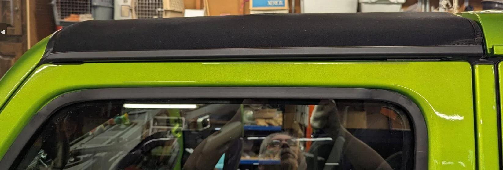

I believe Jeep made two changes - one earlier to prevent you from getting dripped on getting in and out, and then later, another flap put in - maybe for wind noise because the 2024 and 2025 are so much quieter!
How is the clearance between the sunrider's "drip rail" (lol, it' s a joke, the fabric is in and out of that rail on mine) and the top edge of the door? Mine comes awfully close to hitting the door on the right.
nice and even gap on all doors (Gladiator and Wrangler). I'm at the beach right now with the Wrangler, so it's the only shot I can give you:
Jeep Gladiator Sunrider owners - MY mess-up, or theirs? IMG_2204
It sits nice and even on both Jeeps. The fabric sits tight in the drip rail as well. I still contend that the Sunrider is the best, and most useful mod I've done on my Jeeps. When ever it's above 60 degrees outside, we have the Sunrider open...so they get lots of use. I have been really impressed with their engineering.
Really sorry to hear about your difficulties...after reading many of your posts over the years, I know you're a stickler for getting things right, and not accepting sub-standard work or quality.
Maybe they sent you a Bronco Sunrider? ;)
p.s. do you think they changed the seal between my '24 and your '25?
Yes, for sure, the gap on yours is near perfect - VERY acceptable for a bolt-on accessory.
The rear "drip rail" of mine sits higher than the one on the Jeep's top, and higher than yours, and it goes downhill a lot toward the front. Very different gaps.
I just looked at mine. It is a '22, so the seals might be different. But I do know that the gap above the doors is at least as even as with the Freedom Panels. Also, mine has been on and off several times over the past three years, and it has always lined up the same. You may need to get the dealership involved, it could be made out of spec. Even if you decide that the Sunrider isn't worth the trouble, (I think that would be unlikely, mine is opened every time the weather is nice enough), you could sell it and recover a bit of the package price.
40,503
54,023
Thank you. As always, I appreciate your sage advice (not kidding)
I'm hoping I like it.
