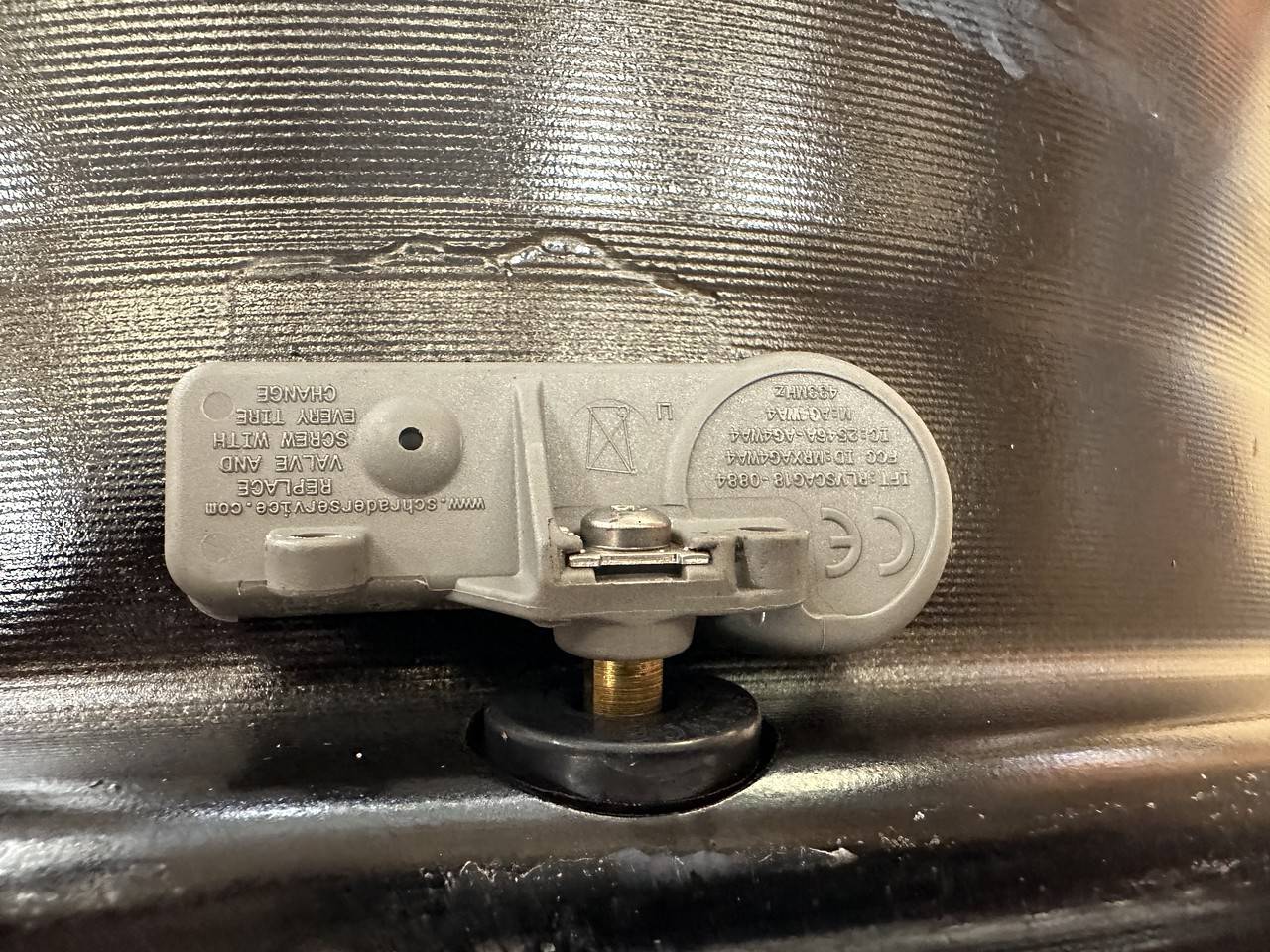

Early model tire pressire monitor system is made by Schrader.

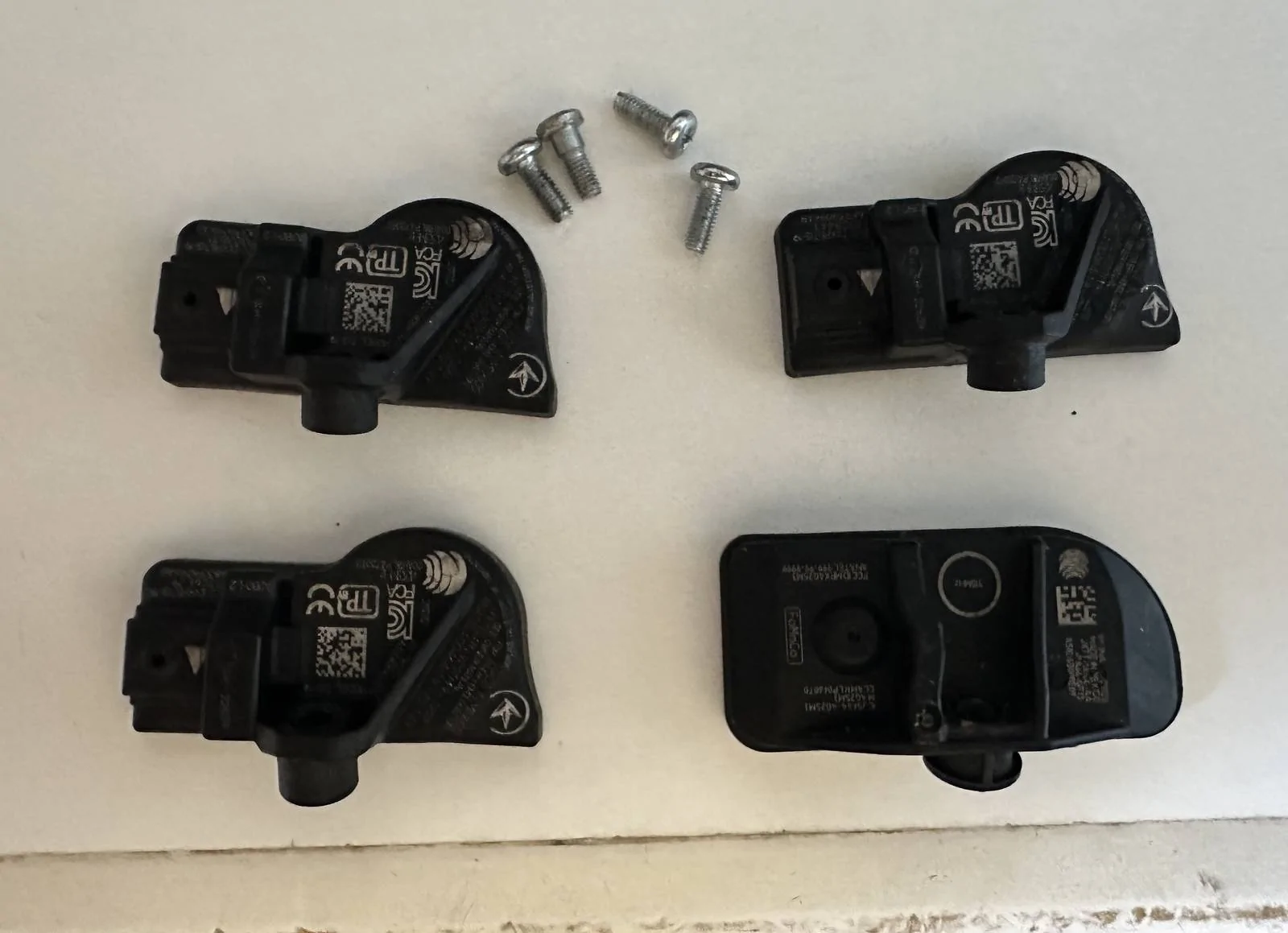

The new tire pressure monitor system is made by Continental. They are not the same.

I know for sure that the Schrader system will not pick up the Continental tire sensors. I am uncertain if the Continental tire pressure system will pick up on the Schrader tire sensors.
The sensors can be changed on a tire change machine without dismounting the tire or upsetting the balance.
