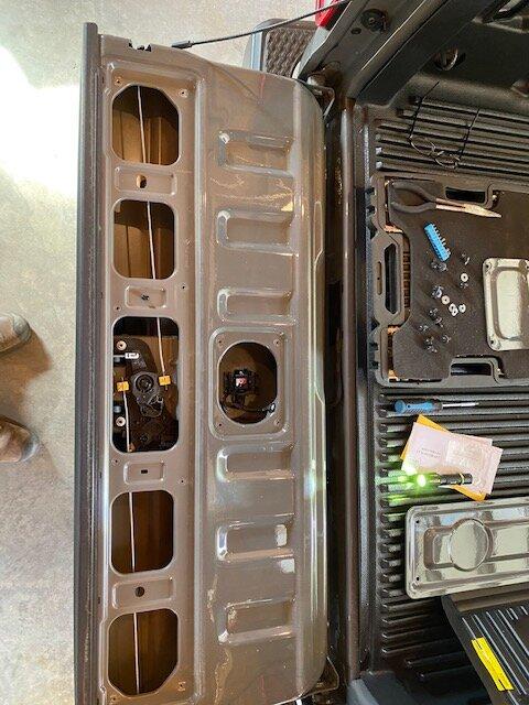

I have had my Gladiator Sport for one year and a couple days ago I decided to lock the tailgate. I turned the key in the lock and nothing happened, no resistance, no click. I removed the tailgate panel which covers the latch and key. The latching mechanism was there, but nothing for the lock.
I called 2 dealerships and the parts departments had no idea what part was missing. I could probably install the darn thing, but now I will have to go to a deanship to be told "yep, it's not there."
I am thinking the lock is probably part of the latch system and can't be purchased separately. Any of y'all ever been the tailgate and can tell me what is missing?

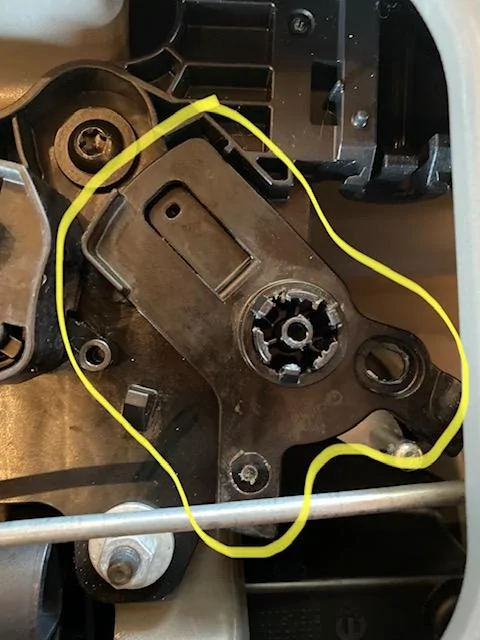

Same thing happened to my 2020 Base Sport. I took everything apart and found the plastic piece that I circled in yellow just popped off the central spindle. I found it inside the tailgate body and just popped it back on. Just gotta make sure all the locking mechanisms are in their right places when you pop it back on. The metal throws have to be in the right places to move the plastic pieces around so they engage the lock. Kinda helps to know a little about how lock internals function.

That is the missing part. I went to the truck and removed the tailgate panels. It was not there. The silver colored vertical piece at 4 o'clock is there and in conjunction with your picture shows me how it works. Off to the dealership tomorrow. Unlikely that it is a individual part available for purchase.

See if you can look down in the corners inside the tailgate body. That’s where mine was. I used a pair of long needle nose pliers and went in through the backup camera panel. You can also remove the tailgate entirely and turn it upside down and maybe shake it loose

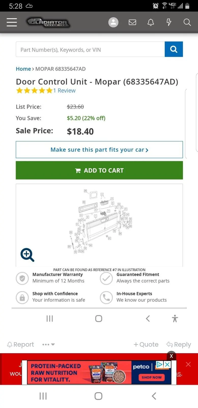

I had the same issue with mine. They replaced the whole lock assy.

Attached, the part dealer replaced.
