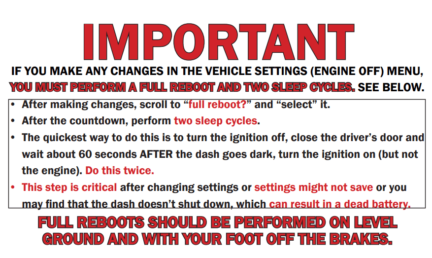

Anyone have this setup? My dash would not turn off nor the gear indicator until I unplugged the Tazer. Keep draining my battery. This happen to anyone else?

I have both. You need to reboot after the changes with the Tazer or it will drain the battery. Been there.

Yeah, tried that didnt work... Reboot tazer , stinger or both?
