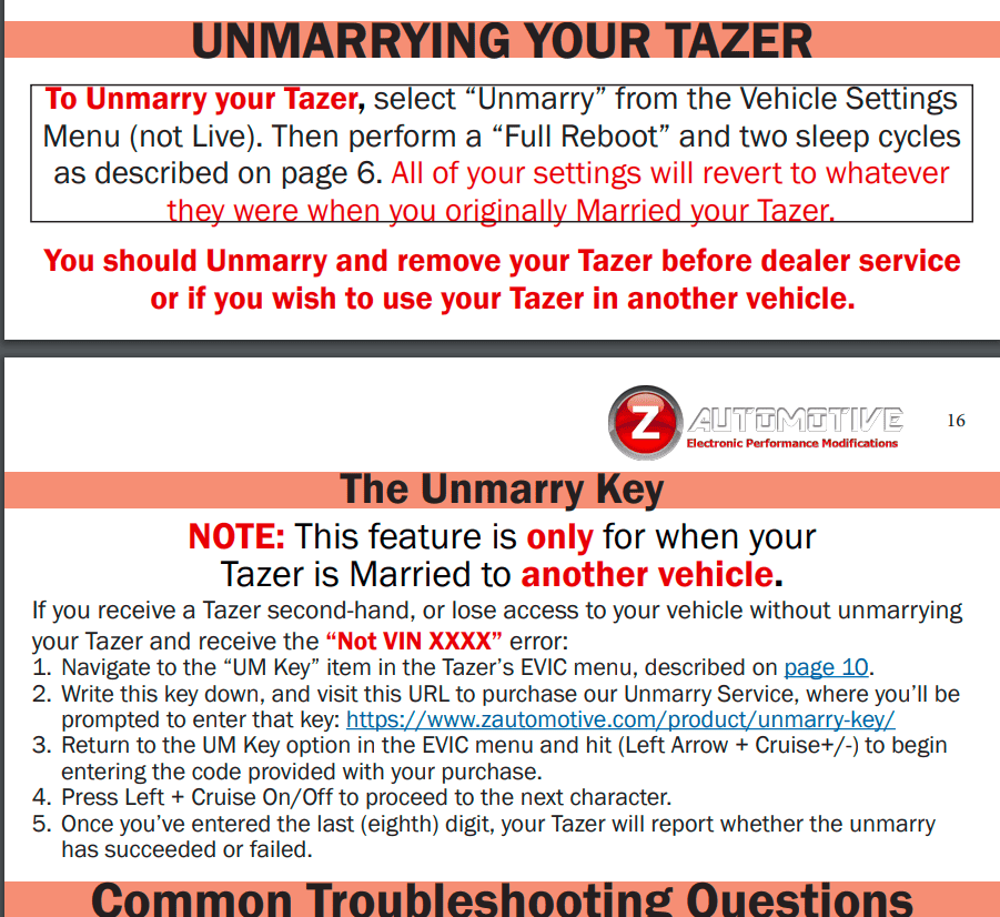

Before y’all slam me and tell me search, I’ve tried.
When removing the tazer do I need to unmarry it since it’s going back on my JT? Or is it just take it off and lose the live settings? Talk to me. Dealership says it’s messing up their laptop when flashing the steering gear box after replacement!
thanks

I forgot to remove it, so they know already… my question at this point is if I remove it without unmarry will it just go back on and I’ll have all the functions?

From the Tazer instruction manual:
" You should Unmarry and remove your Tazer before dealer service"
Jeep Gladiator Tazer question 1628874647161
